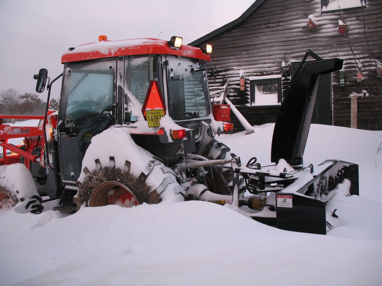

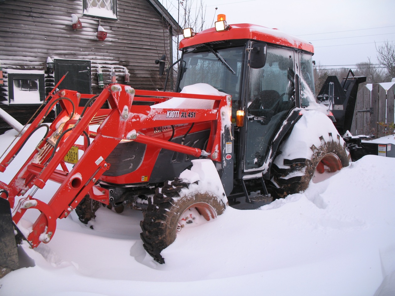

Minus 15 to 20 Celsius no problem...
I use diesel conditioner and only toggle the glow plugs once.
