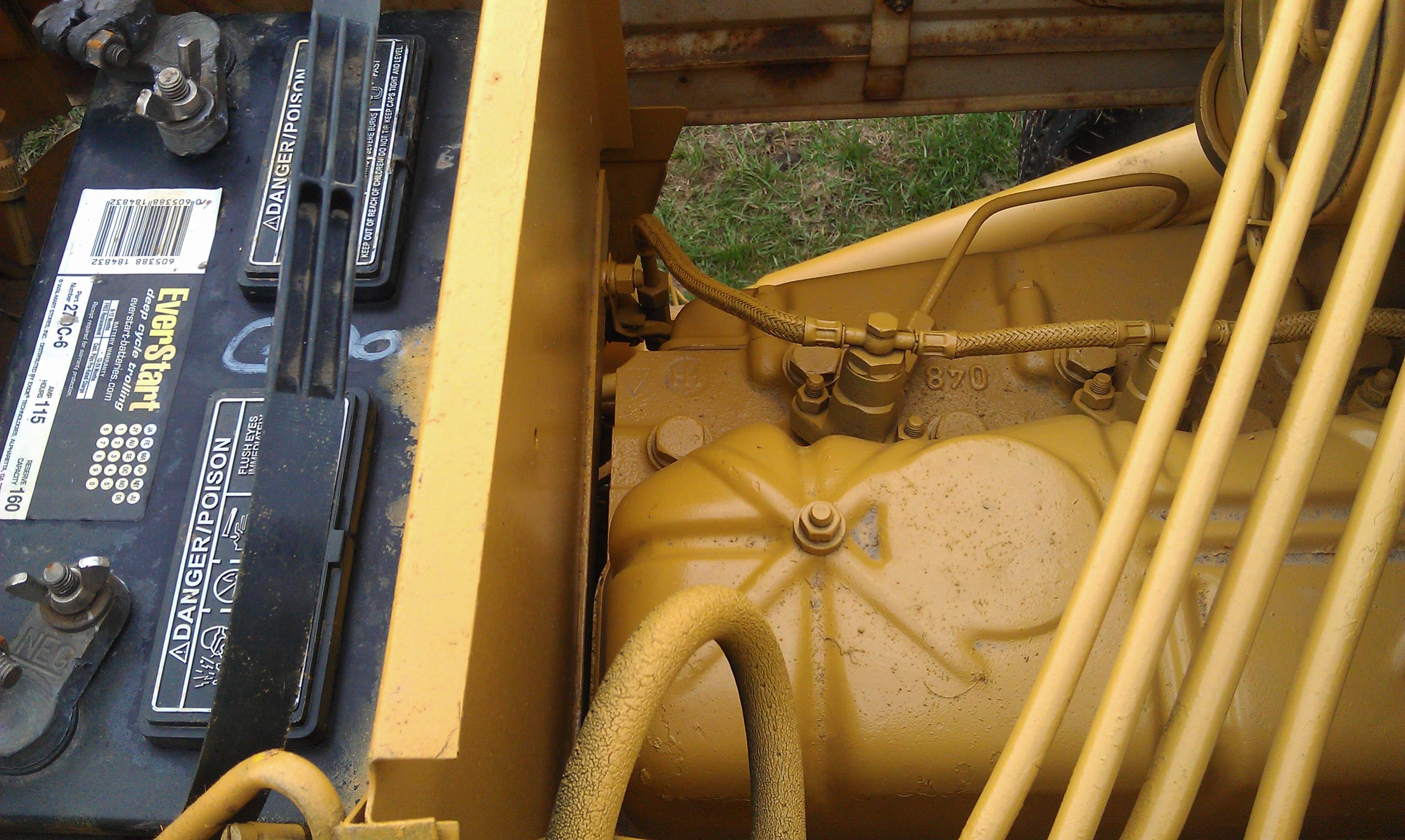

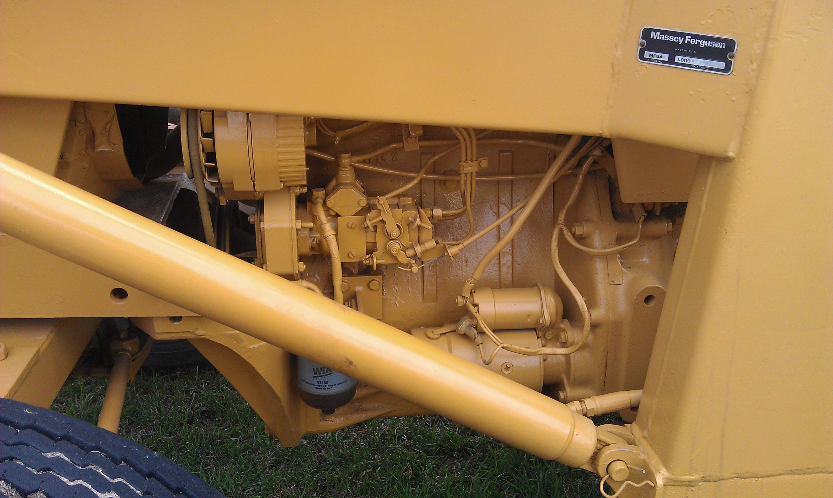

I am looking at buying my first tractor. I am considering a International 2400B Utility. The tractor has a 3 cylinder diesel motor and the owner has to give it a shot of ether in order to cold start it. After using ether it will start right up just fine and can be started again without ether when it is warm. I don't see any glow plugs on the tractor and the owner said some diesel tractors don't have glow plugs. He also said the tractor might be missing a heater box that went on the air intake (that might have had a glow plug in it).
I can't help but think a diesel motor would need to have some kind of cold weather starting assistance. Does anyone have any ideas on this? I have attached a few pictures.

I looked up your tractor on the Case,IH site. By the process of elimination your tractor had neither glow plugs or heater grid. It came from the factor with an ether injection system. Insidious actually, it makes it way tooooo easy to use, and then you need an overhaul much sooner than you would other wise. I could not find the engine parts page on CaseIH site, but did find the tractor on Tractor Data.com. The engine had 16;1 compression so it had no need for either glow plugs or heater grid. Using ether for just a few weeks would not cause the problem you are seeing with it. If the tractor is really cheap, and you can buy it figuring a motor at some time, it may be okay. BUT, if it is full price for what is supposed to be a great working tractor, WALK AWAY! At 45 the tractor should fire up NO PROBLEM.

That is a D179(3cyl) engine, a smaller brother to the D239(4cyl) and D358(6cyl). The engine was made the Neuss Germany engine plant. These engines were used in a number of applications for International Harvester.
You can use two different compression ratio pistons in this engine series, depending on which is installed ..you may need a "shot" of ether to start at <40 degrees. I always use the higher compression parts on these engines and it will start without ether >20 degrees.
There is a factory device for the intake manifold called a thermo-start ..basically a glow plug with a fuel line connected that makes a fire in the intake. Also you can use an external pump type heater to "warm" the engine in cold weather.
Injection pump, injector and compression health are important in any engine to "git'er runnin" Check your pic of the injection pump, look at the lever for the "kill" cable and see the spring loaded device to the right ..this is an "over fuel" position to aid in starting.

Any time you see a nail used as a retainer clip on an injection pump it would make you wonder what else was monkey rigged and not fixed properly.
   / Cold starting problem (3 cylinder diesel)
Good eye, I didn't even see that :)
