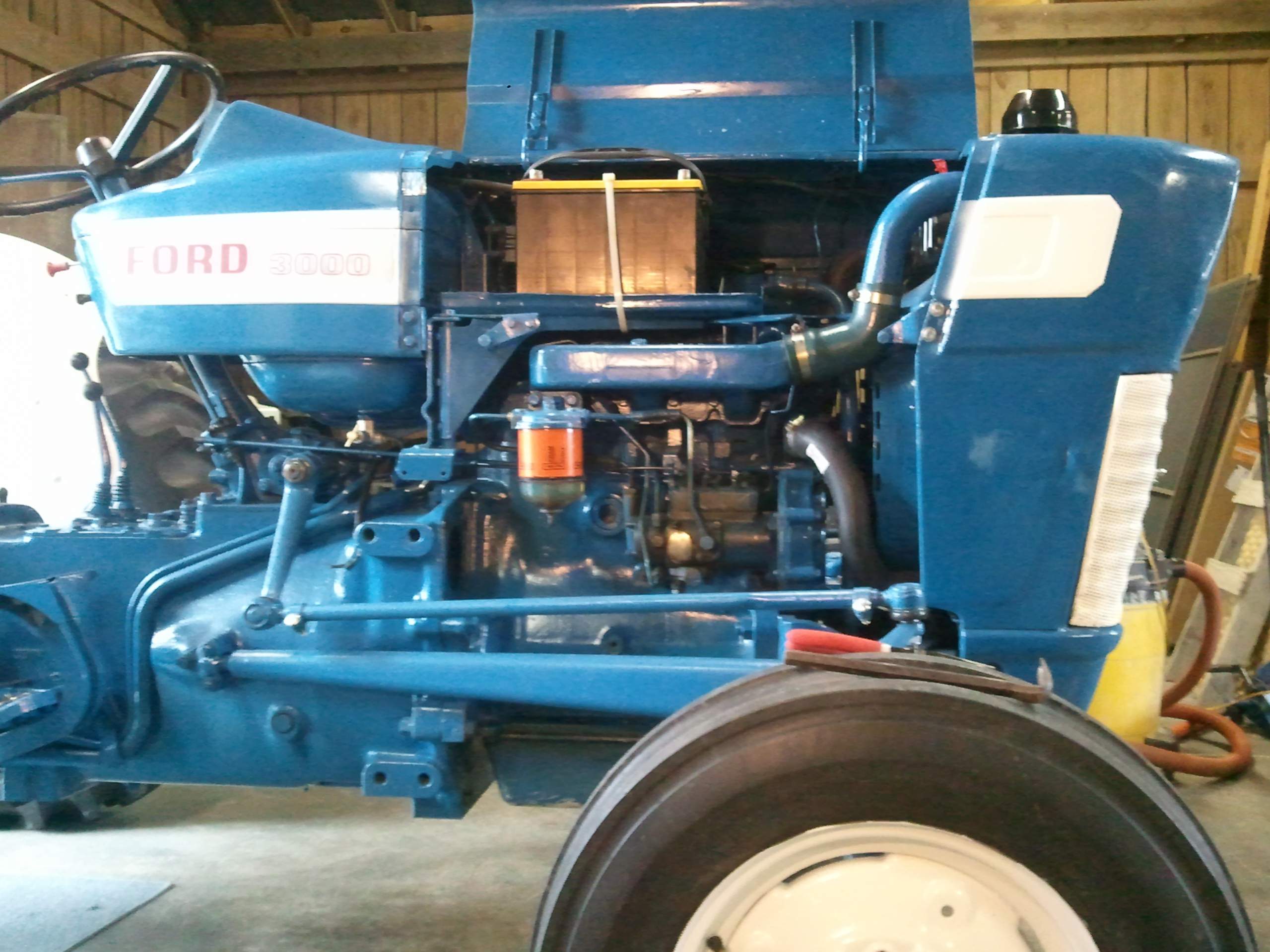

Hello all
I bought my Ford 4000 and the previous owner said he had to use ether everytime it was below 35F or around 5C. And he never used it in the winter. I plan on putting a snowblower on it so it needs to start in very cold weather. Is there a block heater for that tractor? I put a "stick on" heating element on my lawn tractor last year and it worked great. Would that be a sollution for my Smurf?
Any good idea is welcome
Thanks
Dominique

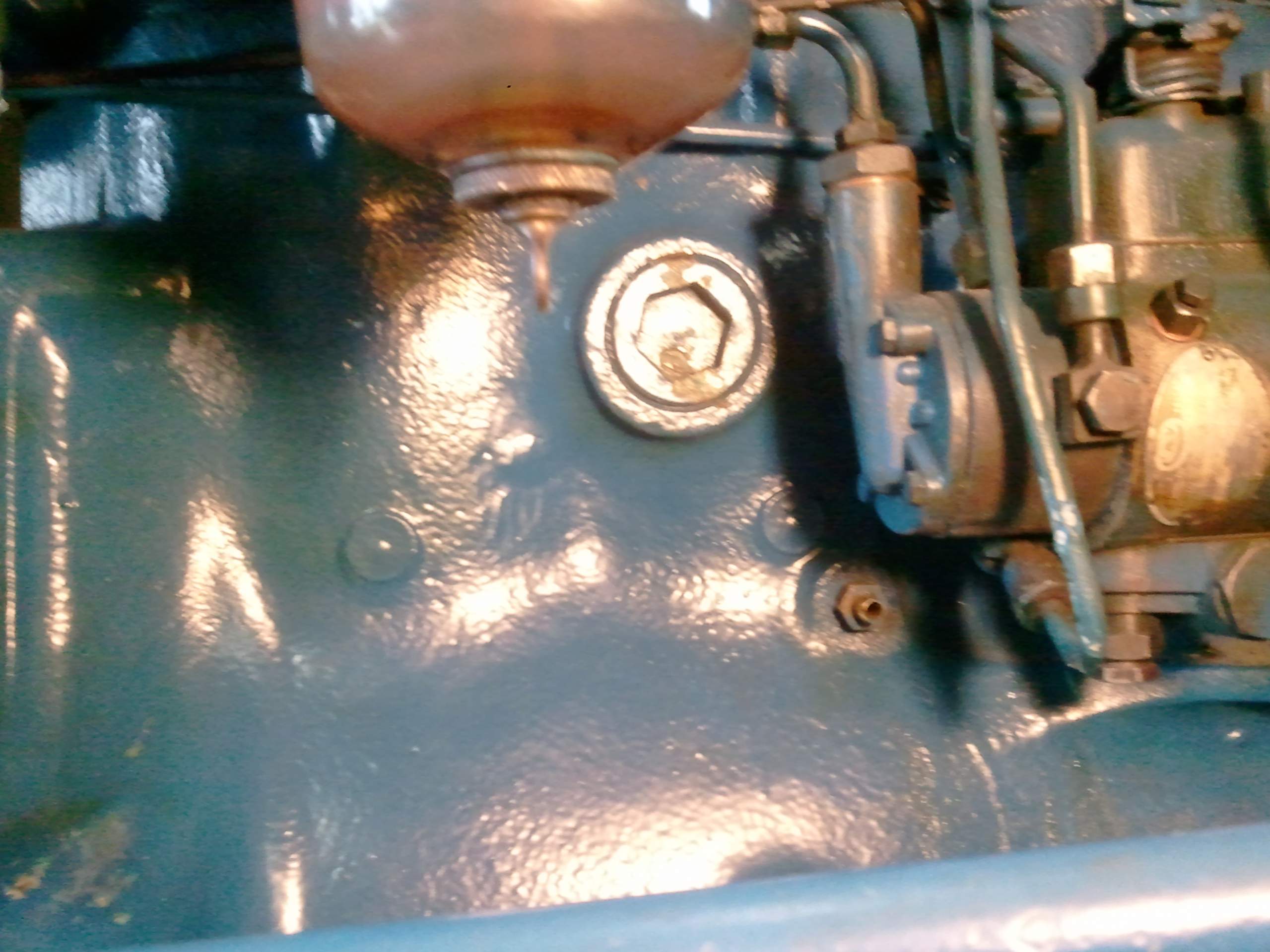

I looked around and cant seem to find where that freeze plug is? Any diagram i could look at for help?
Thanks

How about a pic or two?

1-1/2" frostplog heater goes between starter and injection pump. Tractor may also have Thermostart which is a manifold heater controlled by the key switch. Look for a fuel line and wire connecting to a fixture at the front of the intake manifold.
   / Cold start for 1972 Ford 4000 (the Smurf)
Thanks a million RickB, I looked long and finally found the place where the frostplug was and guess what? the heater heater is there, its just missing the cord. Ill order it today and hopefully it will work,
Thanks again
