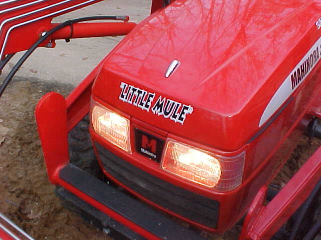

Hockymaine, I was wondering if the dealer installed hotter glow plugs and delay helped your 2015 start better.. Mine usually starts pretty quick, but takes a while, 30 secs. to a minute to quit sputtering and actually settle down to smooth idle. I sometimes hit the glow and shut it back off and then again to warm the plugs twice, I don't know if it really helps or not.. I was waiting to see if it worked on yours before having it done to mine... John
