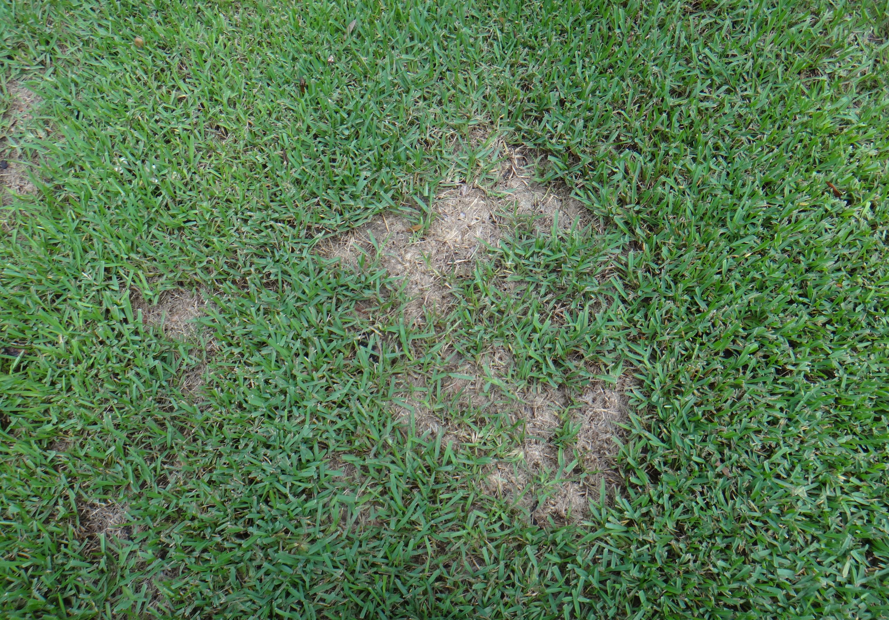

Photo #1. Thatch buildup/dieout in Florida Saint Augustine lawn. St. Augustine grass is a common turf grass in Florida, developed from native grass. St. Augustine does not seed, it spreads only by runners. The challenge with St. Augustine is to remove thatch while not tearing out the healthy lawn and runners.

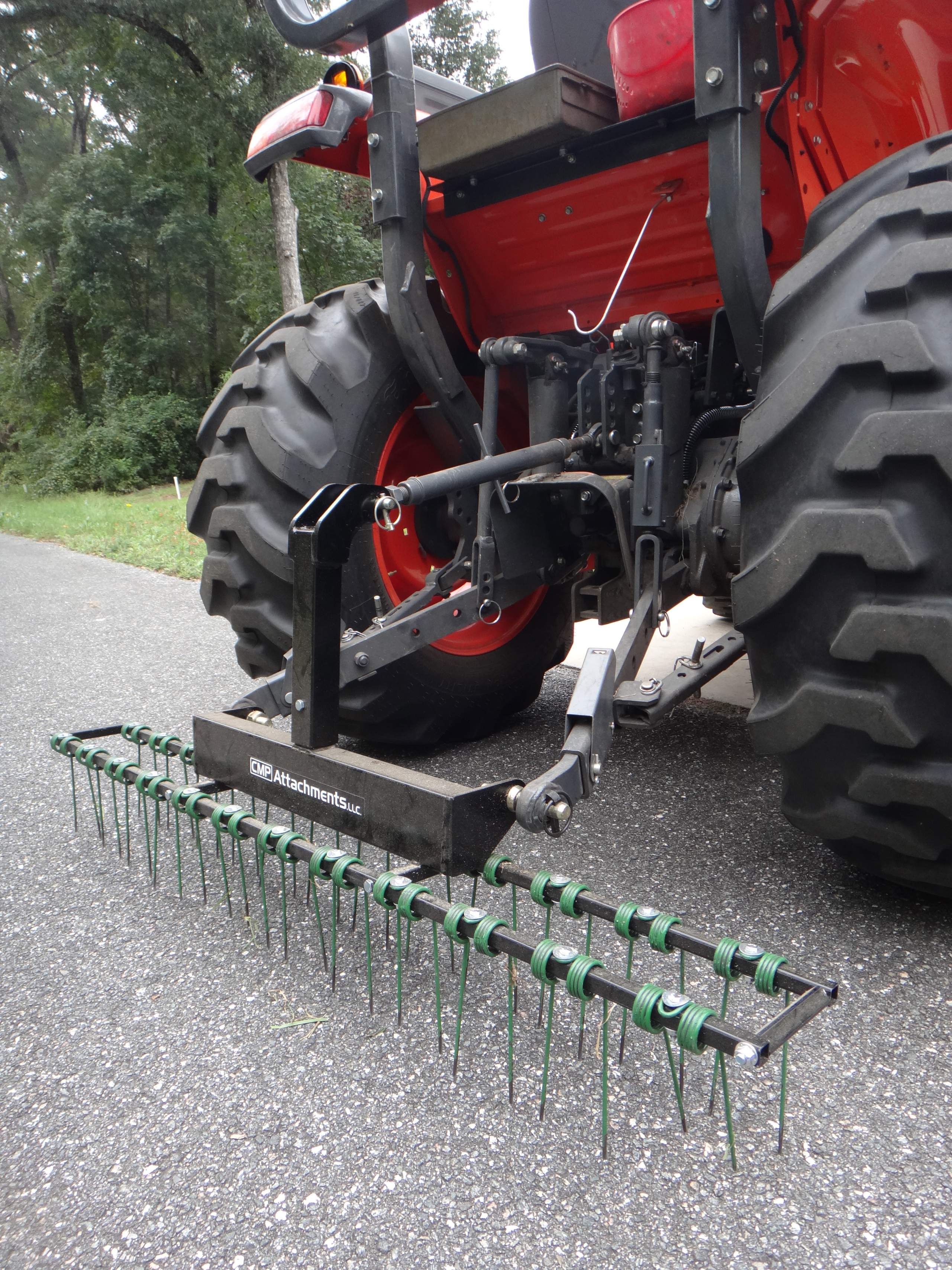

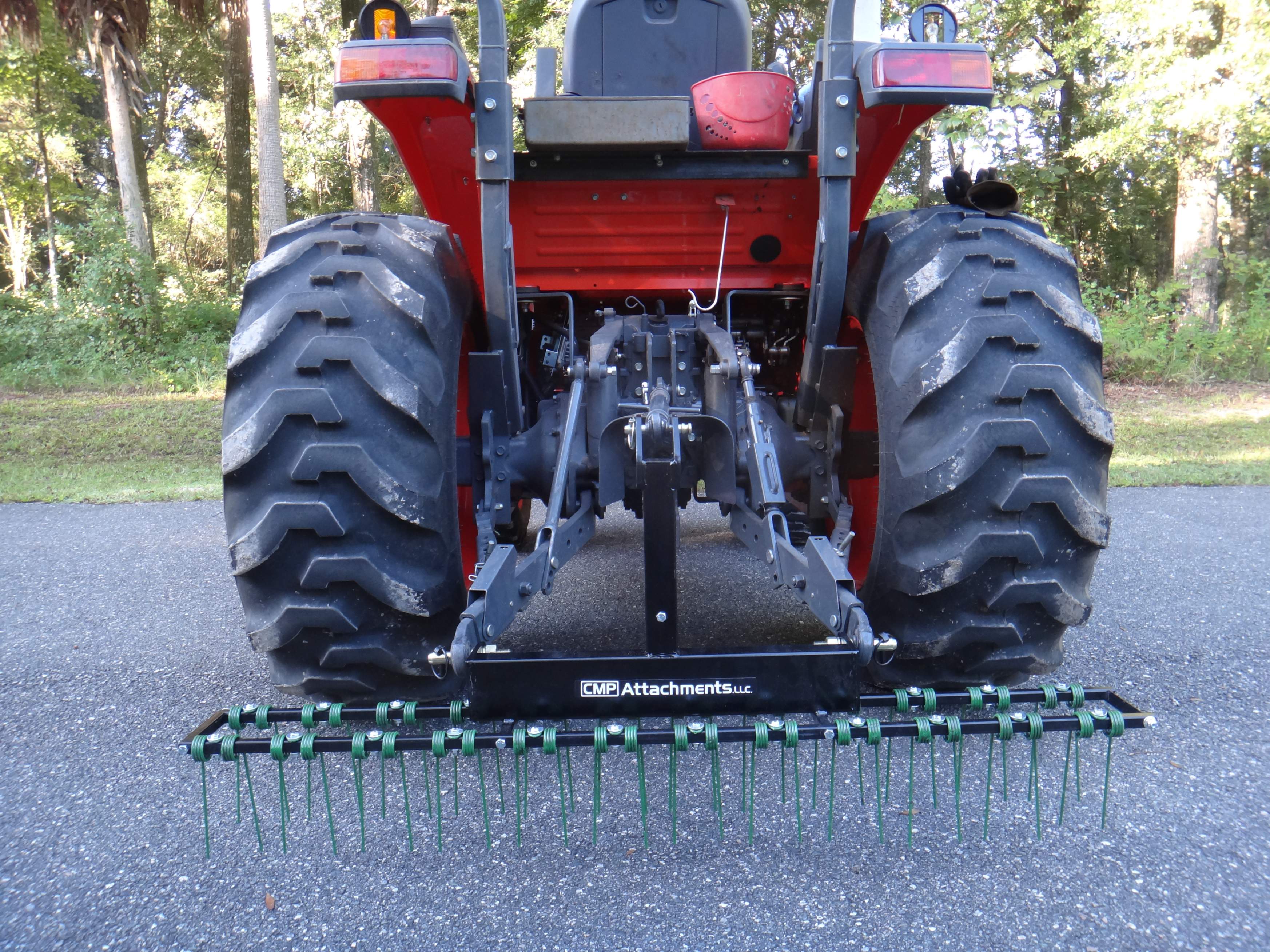

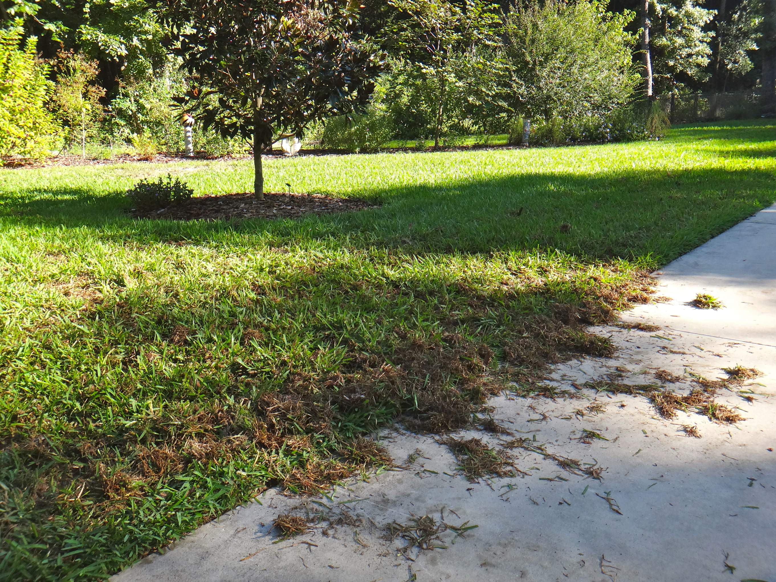

Photo #2 Dethatcher first mounted on tractor. Three Point Hitch adjustments in default positions. Tines just meet pavement, not deep enough to enter grass and pull out thatch.

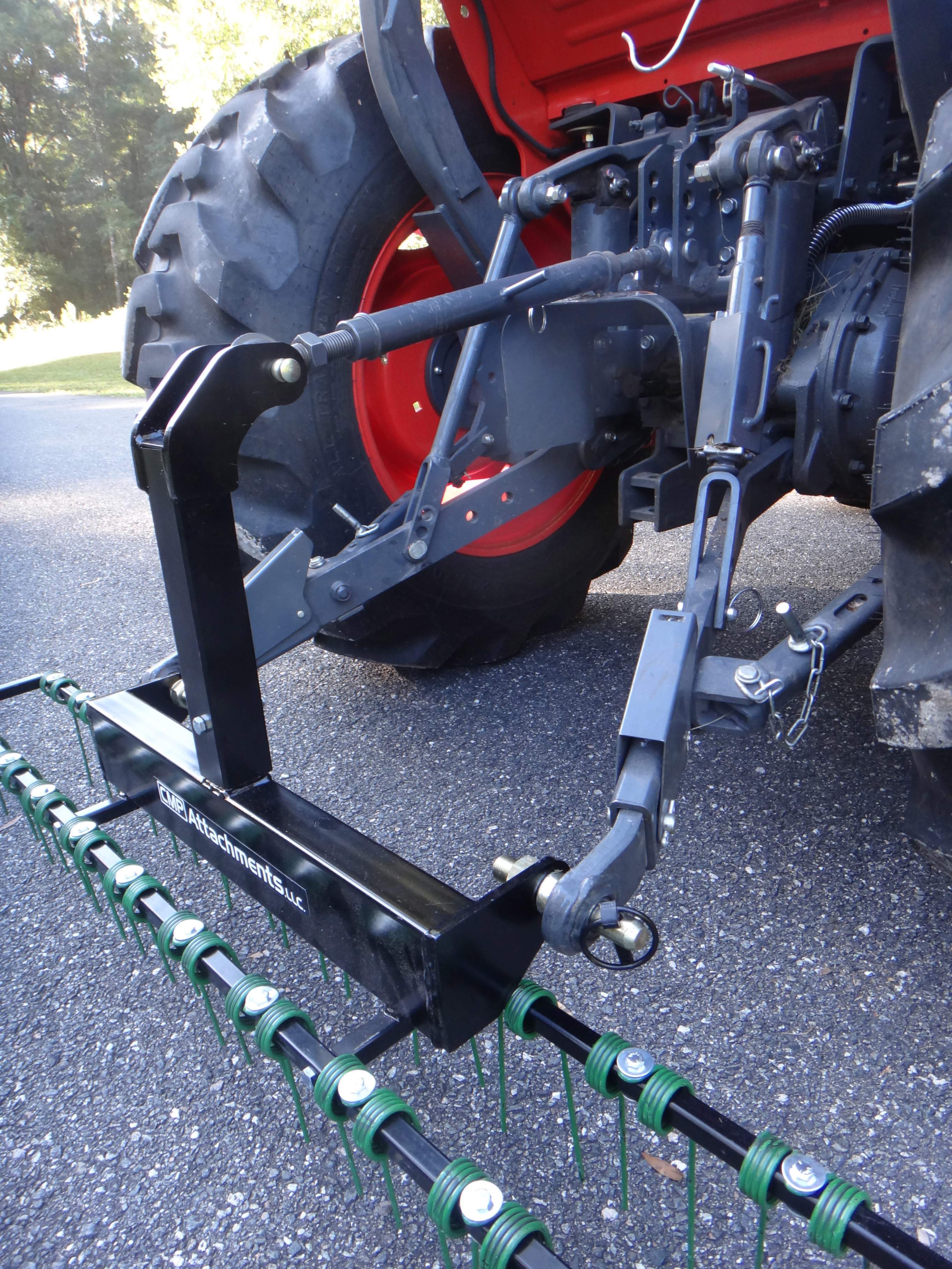

Photo #3 (Adjustment #1) Adjustment pins for Lifting Rod stirrups moved to lowest of three positions. Tines lower, but not low enough. (Use long-nose pliers to remove ring cotters from pins; fingers are not strong enough.)
Photo #4 (Adjustment #2) Adjustment pins moved inboard along Lower Link beams to pin position closer to tractor; Hole #2, center, of three holes. Tines cannot penetrate road but there is 50% adjustment range (drop) remaining on hydraulic 3-Pt control.

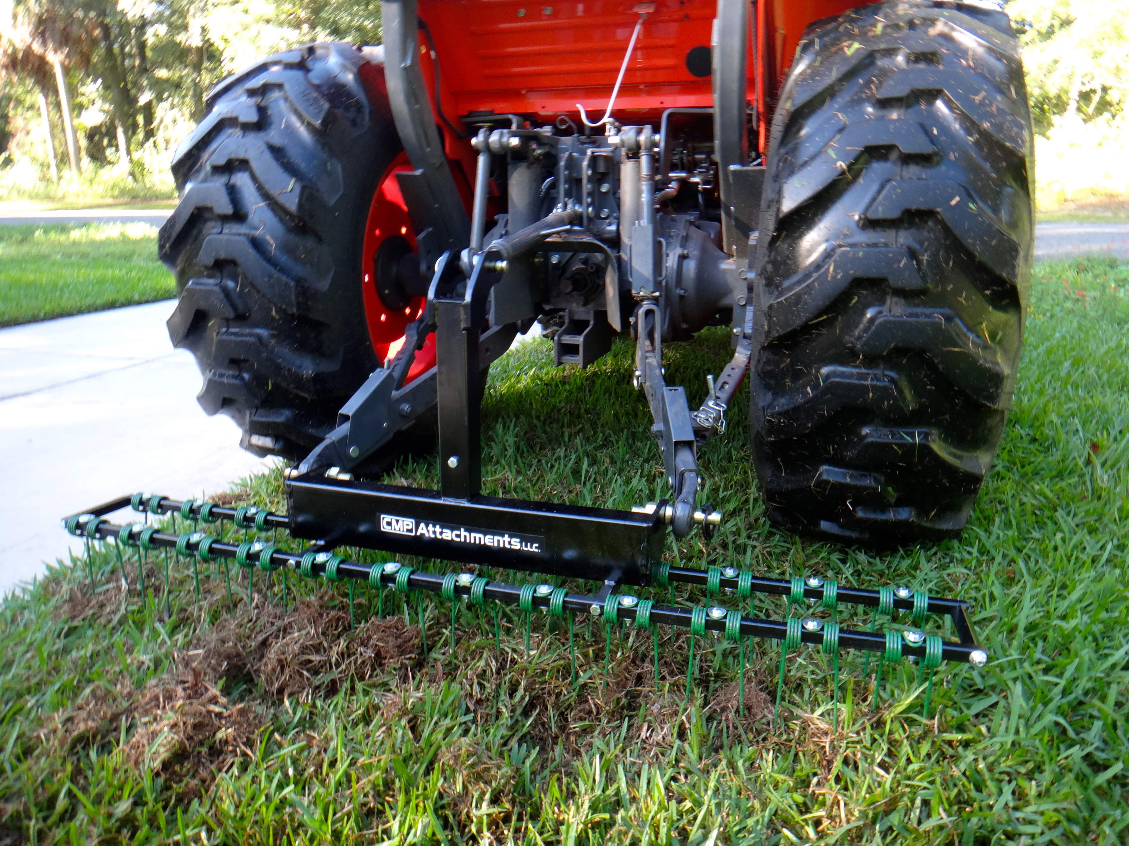

Photo #5 CMP Dethatcher at work. Tine depth in turf about right for damp condition.

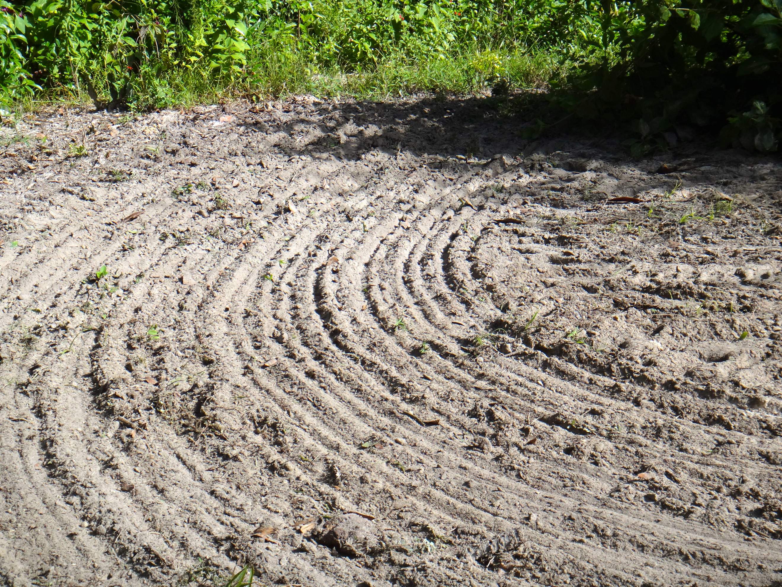

Photo #6 Effect of tines on plain dirt. Posted to show force of downward pressure on tines.

Second use of CMP 60" Dethatcher. We have experienced only a trace of rain since I started this thread 9/15/2014, so my lawn is drier but not wilted nor straw-like. My lawn was mowed five days ago.
Photo #1 I moved in the Lifting Rod stirrups further toward the tractor, from the middle adjustment hole on the Lower Link beams to the adjustment hole closest to the tractor. This put more hitch weight on the CMP Dethatcher. If my lawn was smooth this would not have been necessary, but my lawn is NOT smooth and I felt the need to get dethatcher tines all the way to the dirt in the low areas.
In the picture the dethatcher tines are on the asphalt. I still had 2/3 "down" adjustment available on the 3-Pt. hydraulic control lever on the grass.

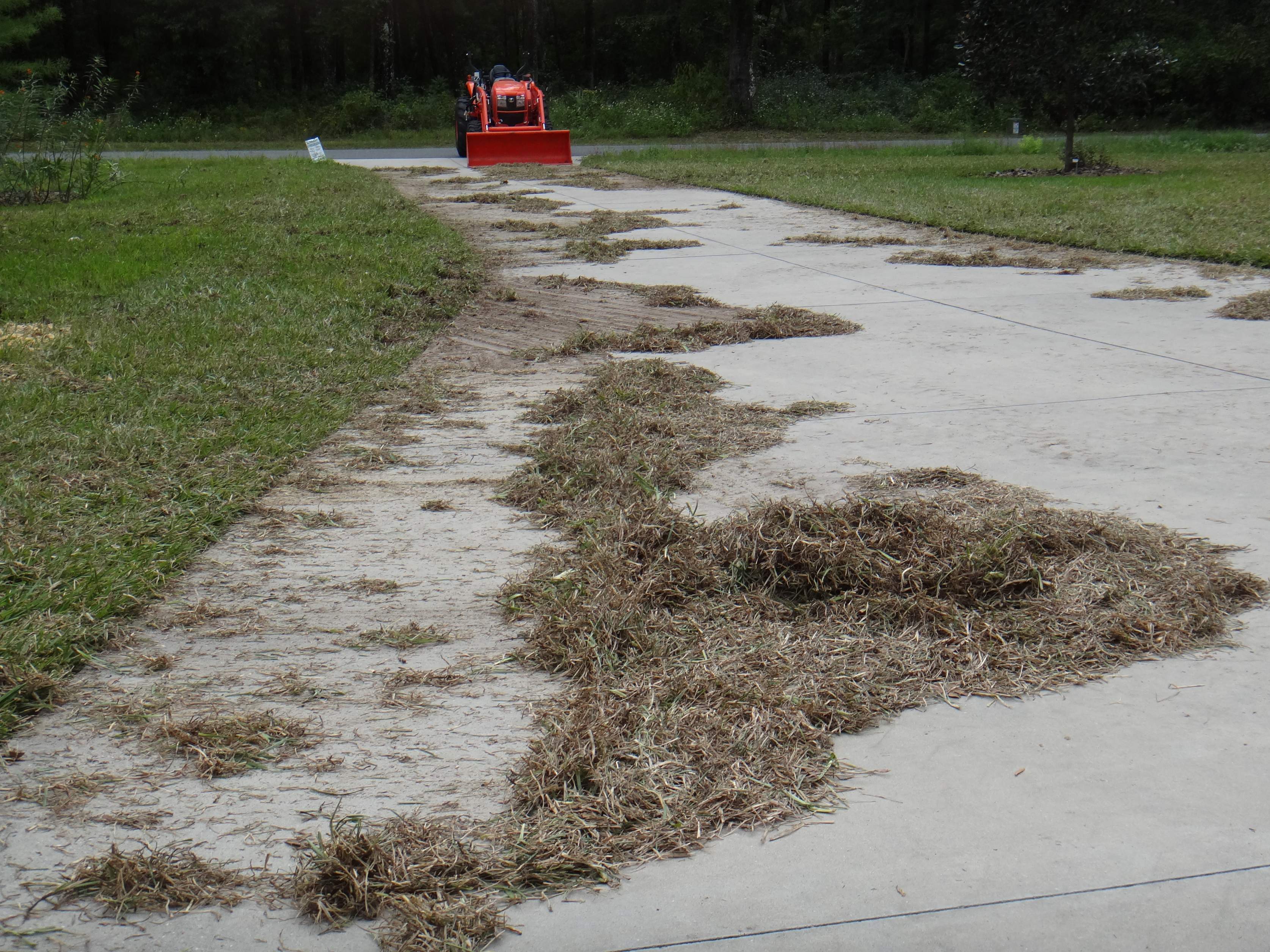

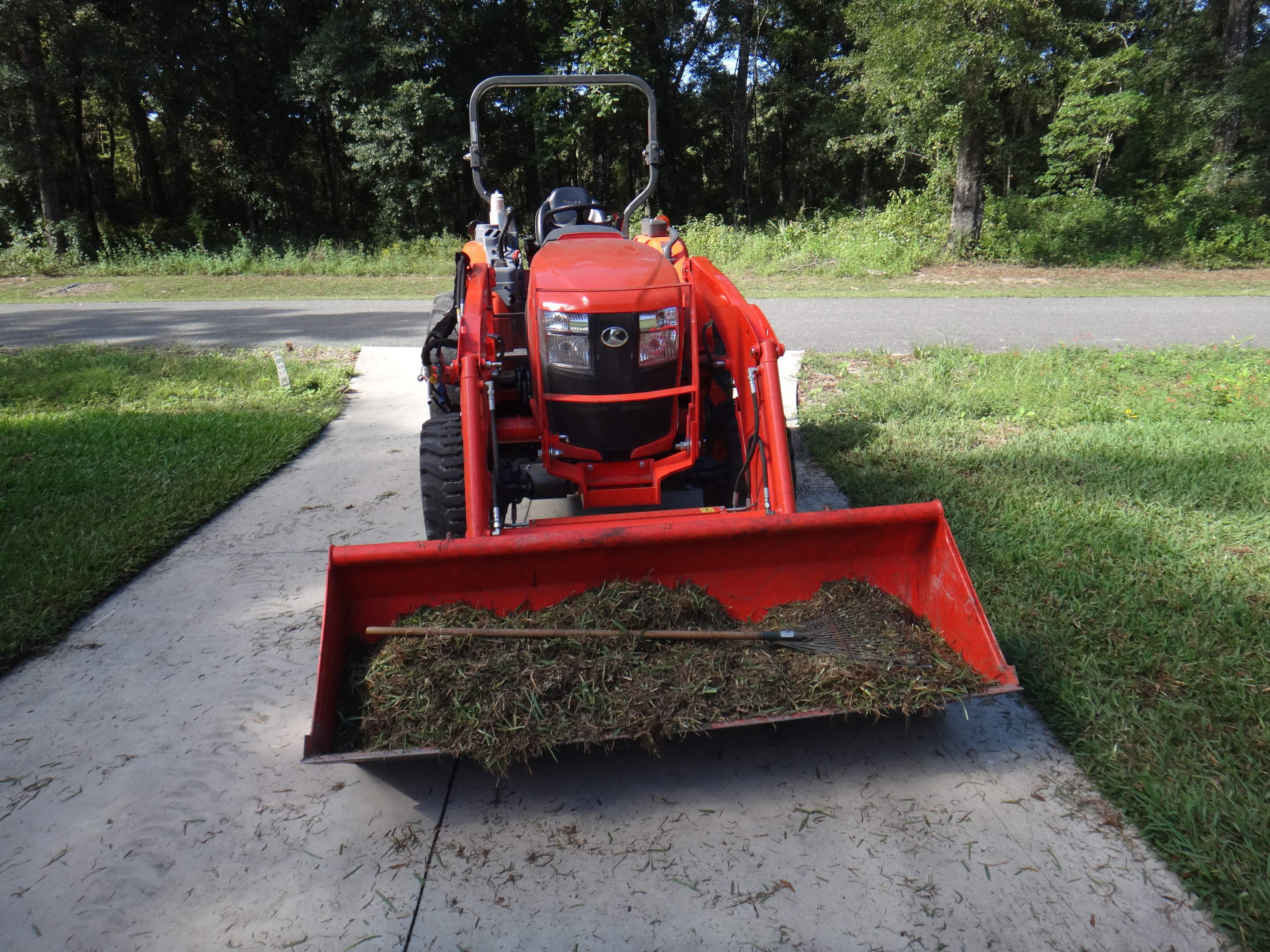

Photo #2 My front lawn is split by my driveway. One side is the dry side, which has 2/5 of the turf. The other side is the wet side, which has 3/5 of the turf. I went over both sides repeatedly with the dethatcher, dropping thatch in the driveway. I collected two additional FEL buckets of thatch, for a total of three FEL buckets of thatch. Had I wanted to hand rake the yard I believe I could have collected a fourth bucket of thatch but I did not think the "by-hand" effort worthwhile. All of the dead, matted grass has been removed and the healthy grass appears 'teased' up.
CMP Dethatcher does an excellent job combing out thatch without harming healthy lawn. I think quality combing is evidenced in Photo #2.
Dethatching results with the turf drier and shorter were markedly improved.
