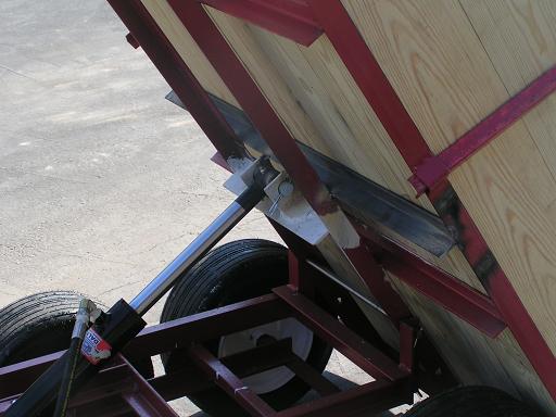

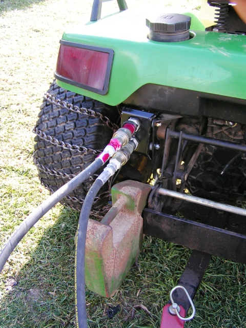

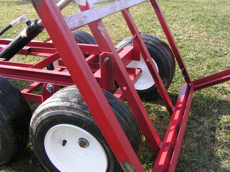

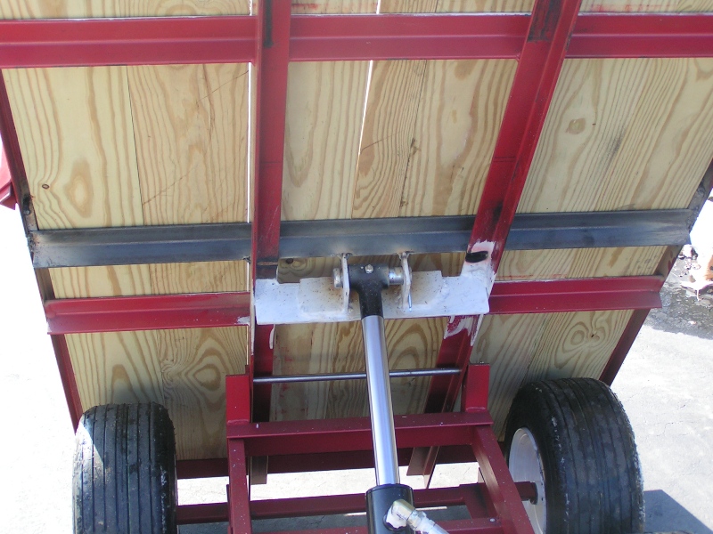

Here is another Country Manfacturing Inc. tandem trailer with a hydraulic dump modification. When I designed the cylinder plumbing, I wanted to use the dump trailer to connect to the both my John Deere 425 garden tractor as well as my Kioti CK25. The CK already had 1/2" rear remotes for my backhoe. So the trailer got 3/8" hose adapted up to 1/2" Male QC's. The JD hydraulics patch is 1/4" QC. So these were adapted up to 1/2" Female QC's, just like on the Kioti.
Putting a cylinder on the stock CMI trailer is tough, when considering that I want it to work with the relatively low pressure of the JD (1000 PSI). I needed as much vertical angle as possible, and also wanted it as far forward as was practical. But, the tongue extends all the way to where I have mounted the bottom of my cylinder. I tried and tried to put the cylinder more foward, but because of the tongue, I couldn't get a steep enough angle. There is also very little clearance. I'm not sure one could get a cylinder under there bigger than 2.5". I used 2" x 18" x 1.25". I thought seriously about raising the dump bed height above the base so that I could get more angle. Then I just surrendered and modified the lame jack dump that I had wrongly bought.
The trailer is the 6 foot version, which I bought thinking it would dump more steeply than the 7 footer. I ended up actually moving the pivot point forward to give me as much rear hang over as possible. I simply drilled 2 new holes. This will help the JD work more effectively.
This is my first every welding. Not so pretty, but I think strong enough. It was fun. I built the pivot brackets using 2.5" angle 1/4" thick. Then I added an addition crossmember to help make it stronger and more rigid. I added clipst to the front of the trialer to hold the hose if not using the hydraulic hookup. I still have to prime and paint. But is now fully functional.
Should serve me well.

Thanks, Dmace, for the kind words. But, hardly like factory. Strong enough, though, I think. This was also the first time I had designed and built hydraulic hoses and couplers. Because it is plumbing, it's just like plumbing. Hoy!
Calculated vertical push for the angle applied at 1000 psi (JD) is about 800 lbs, at 2500 PSI (Kioti) it's about 2000 lbs. Full force of the cylinder at 1000 PSI is around 2900 lbs. That is why the angle is so critical. For this trailer to get more angle, you'd have to either lower the cylinder to the point that it would be vulnerable to ground contact, or raise the dump bed higher above the frame. I thought about a shorter cylinder. Could get a steeper angle, but not as much travel. I wanted it to dump very steeply, else what's the point.
I didn't want to put anything dirty in it just yet, because I'm going to paint and stain first. So, I stood on the front (worst case) of the trailer while trying to lift with the JD, no other weight on the bed. This is about 3.5 feet in front of the lift point. It wouldn't lift me. I moved down the bed 1 foot and it lifted me easily. I weigh about 210 lbs. My neighbor, who weighs about 180, was easily lifted when he stood on the front. I'm hoping, that with a more realistically distributed load, with a good bit of weight out back, that it will work effectively. I'll have to watch and not put too big a load on it. I haven't tried it yet with the CK. But, I suspect it will be no problem at all. The trailer is rated to 1 ton. I can't imagine pulling much more than that with my garden tractor.
I'll say one thing: it's fast. Lifts to full dump in about 3 seconds.

The top mount, I think you can see, mostly. It's 2.5" angle, 1/4" thick facing the rear with two pivot points cut from the same 2.4" angle welded to its backside. That assembly was then welded to the 2 longitudinal members of the trailer. I then added an extra crossmember, and tacked it to the pivot bracket outsides.

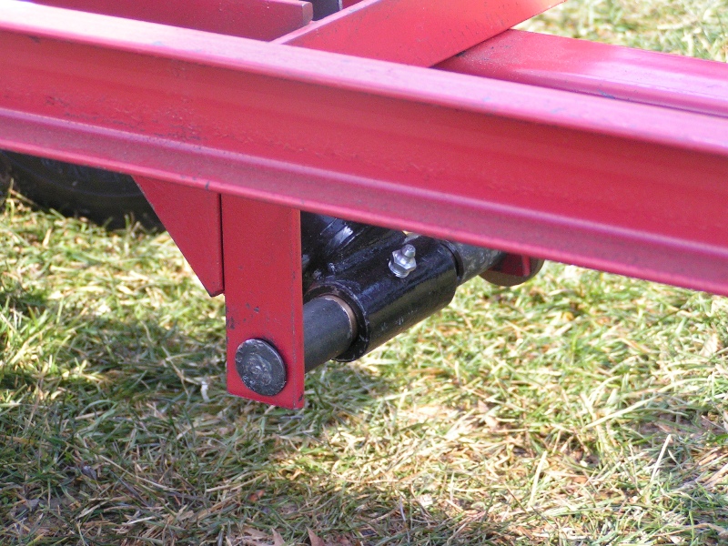

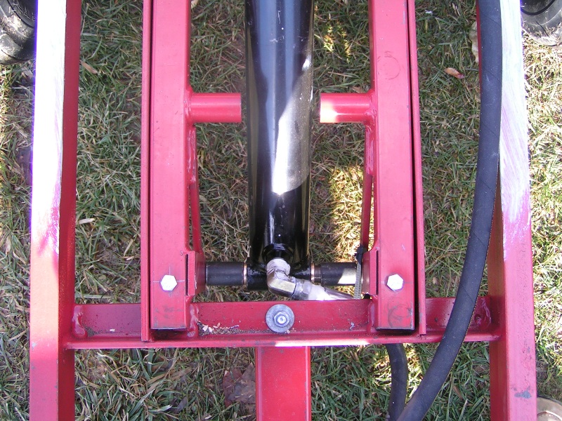

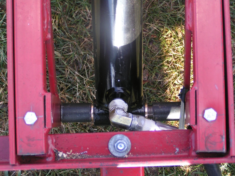

I should have taken some pics of the bottom connection, and I will when I can get some daylight. But, basically, I used the brackets that came with the crappy manual jack lift that CMI sells. I cut them off and redrilled to get them as far forward as possible. I used the 3/4" pivot pin that also came with the jack solution. The cylinder, however, has 1" cross tubes. So I installed a brass sleeve bushing. To keep the cylinder from getting too off-center on the long bottom rod, and to make sure the bushing stayed in place, I added 2 short pieces of plain 3/4" pipe.
If I were making my own bottom bracket from scratch, instead of being lazy like I did by using what I already had, I would have used heavier material with welded on pipes that centered the cylinder.
A 16" stroke would work better, for the location that I chose, and a 2.5" cylinder might just barely fit. The bigger diameter would add more power, and the shorter length would maximize the angle. You'd give up few degrees of dump. But, it would still be plenty steep.

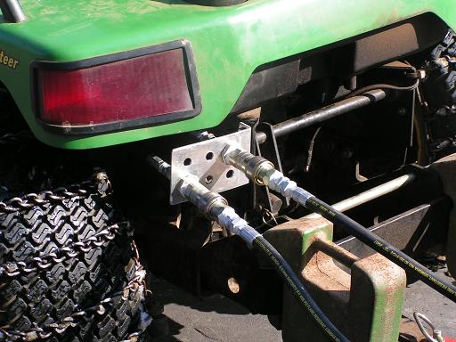

Forgot. I also don't like the aluminum bracket I used on the JD. Flexes too much. I'm going to remake it out of some beefy steel.
Here are a couple of other pics that I have handy.

Finally got some daylight to finish and take some photos showing the bottom pivot. As I said before, I used the brackets and rod that came with the manual jack lift kit. You can see the brass spacer bushing (3/4" ID, 1" OD), and the pipe spacers (1" sch. 40). I left 1/4" of play between the spacers. Tight fit of brass bushing made it a PITA to assemble, and probably even harder to take apart.
Pic 17-1 shows where I moved the pivot holes forward.
Last pic of new steel bracket for the JD425 patch panel. Much stronger and nicer looking (except for my marker paint) than the aluminum one.

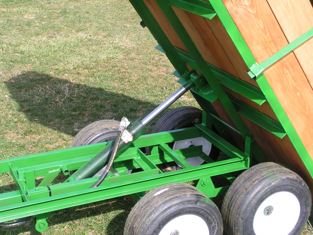

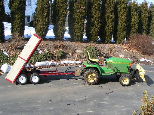

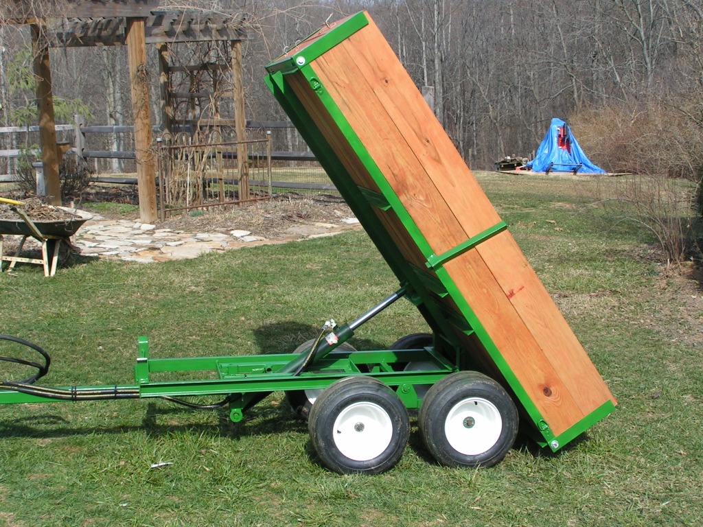

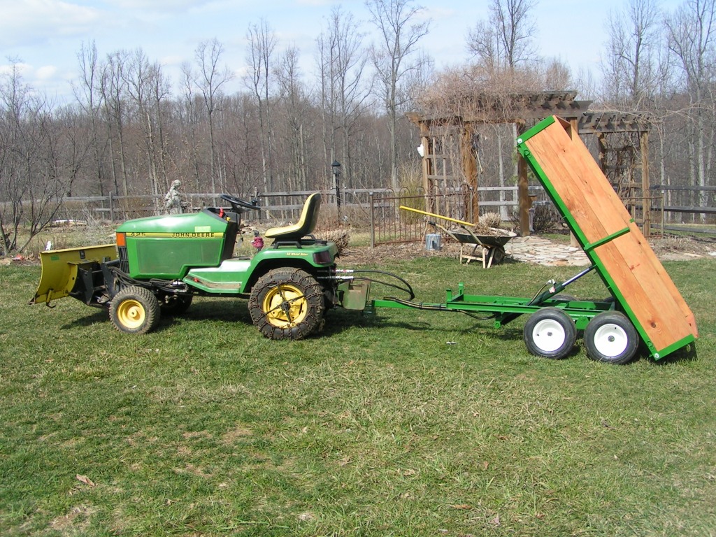

It finally got warm enough to paint and stain. Here is the finished trailer.
