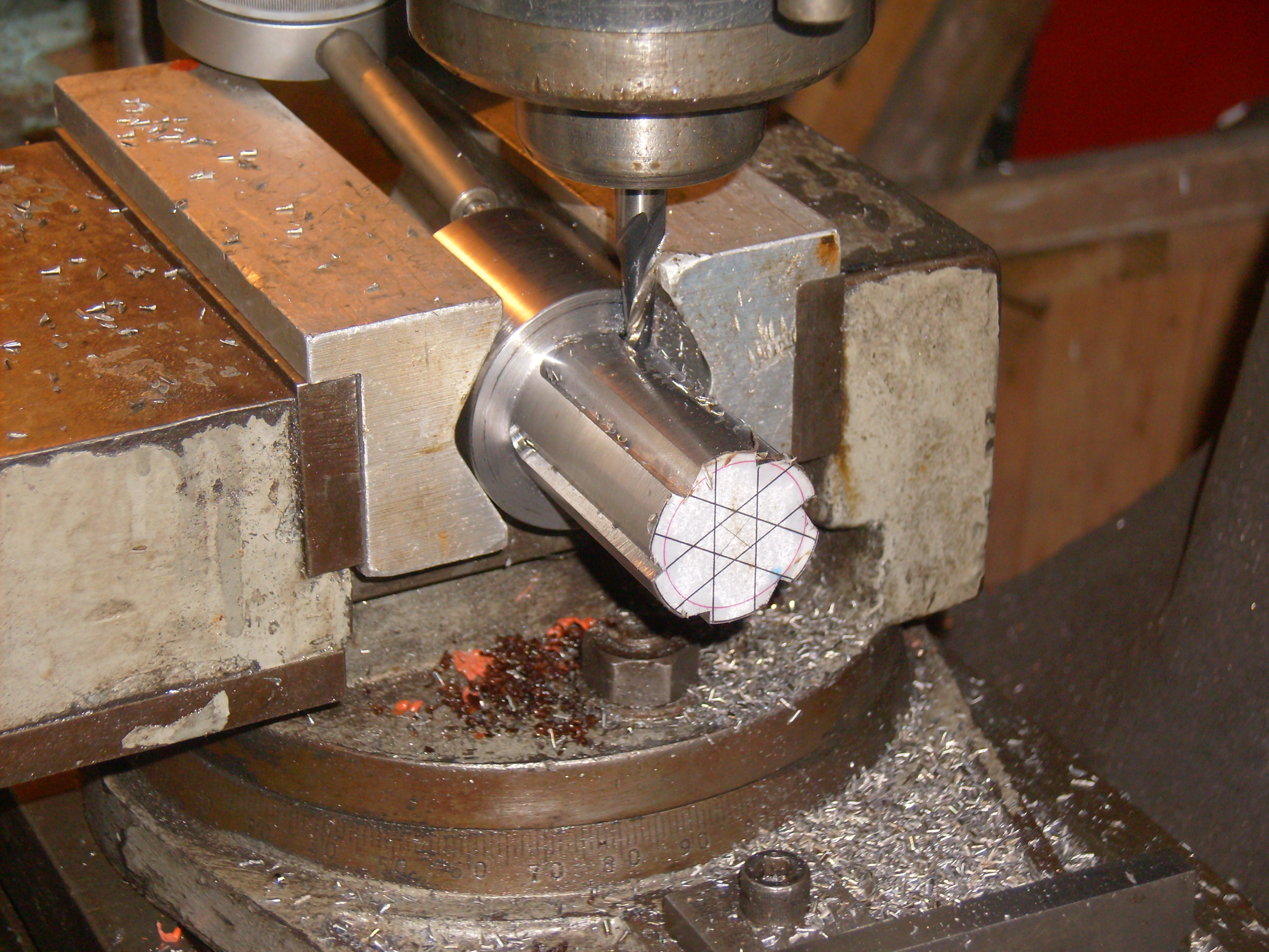

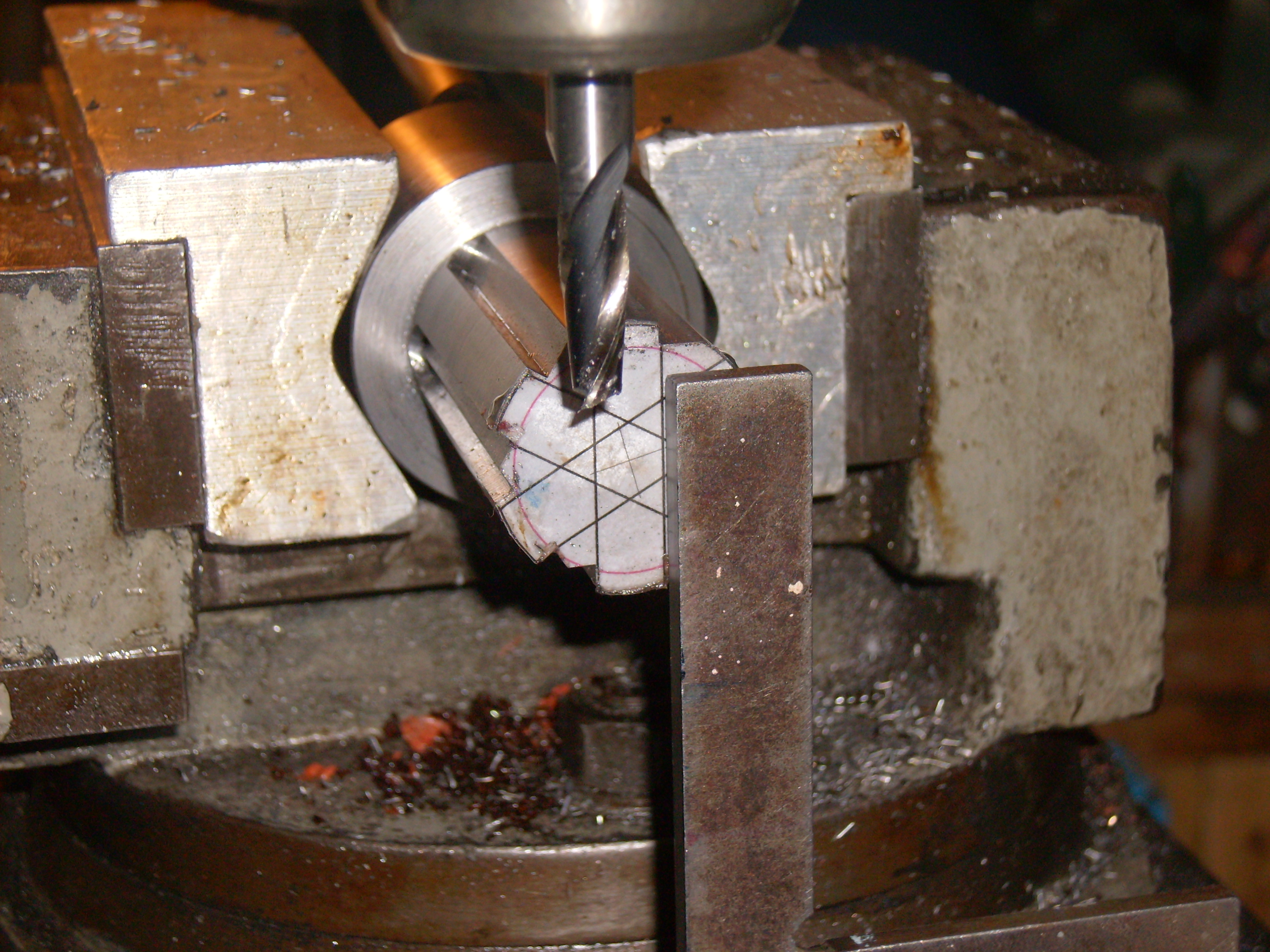

I am replacing the clutch in my 36 Farmall F-20 and the clutch shaft splines are more than 50% worn away. The splines that the clutch disc rides are fine, the bad ones are the splines that a coupler slides on to connect to the trans. The yoke splines are undamaged and I suspect someone replaced the yoke the last time it was apart.
I want to repair the shaft, and I had a mechanical engineer friend (I’m an aircraft mechanic) look at it and he thinks I’ll be just fine TIG welding it to build up the splines and then turn it on the lathe to get it back to round and use the mill to remachine the splines.
My question is how do I best make use of the Bridgeport to clean up the splines? I am thinking I can just use a 7/32 end mill and table the thing back and forth. Is that going to work? I don’t really have access to the correct gear cutting machinery.
I am not a machinist, I just use the mill as a big drill press and the lathe for cutting spacers and simple stuff like that.
What should my spindle speed be? How much of a depth of cut is proper with a 7/32 end mill? Feed speed? Does it need cutting oil/fluid? This mill doesn’t have any cutting fluid in it as it’s a really old machine, all manual, with a DRO.

You could do that, but it would be time consuming. You might check with a machine shop with a horizontal saw and see if they can recut the splines once you've built them up. That's what they use to put key grooves and woodruff slots in shafts.

Yes, a horizontal mill with a over arm attachment and a indexing head would be ideal for machining the spline. Speeds and feeds are determined by the cutting tool (HSS or carbide) and the metal being machined. Replacement parts are quite cheap so I would go that route.

Build the splines up with TIG, then put the shaft on the lathe and turn the diameter. Then just take it to the mill, find a good way to index it (preferably using the original splines if there is a portion without wear) and cut it with an end mill.
Take your time. Maybe leave a bit of material left so you can hand fit it with a file.
If anything goes wrong, just build it up again and try again.
I've made a PTO shaft on a Bridgeport mill before without indexing head nor the proper cutter for it. Heck, it came out perfect and absolutely no play at all.
