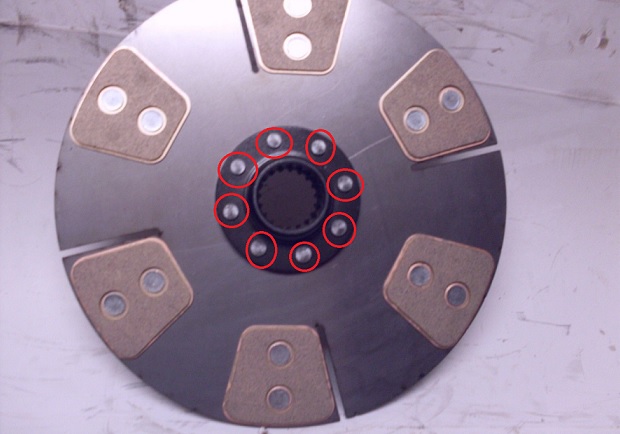

Century 3045 performing fine with no clutch slippage then it just stopped moving all at once, adjusted clutch linkage where it would move at a idle only in low 1st gear.
This happened all at once, has any one else had this problem.

Sounds like the center splined hub tore loose from the rest of the clutch disc.
If that's' the case, a good "clutch & brake shop" can fix it by replacing the sheared rivets.
I hear splitting these tractors is a "bear"... :-(

What were you doing when this happened? Working the tractor hard, changing gears, just driving along, etc..
I had a rear main engine seal leak on a tractor once and it was pulling just fine until I pushed the clutch in and then tried to take off again.
No clue on how these are to split compared to Ford, JD, Bota, etc..

Just driving across field in 2nd range 3rd gear with no load on the tractor that is what so strange.
