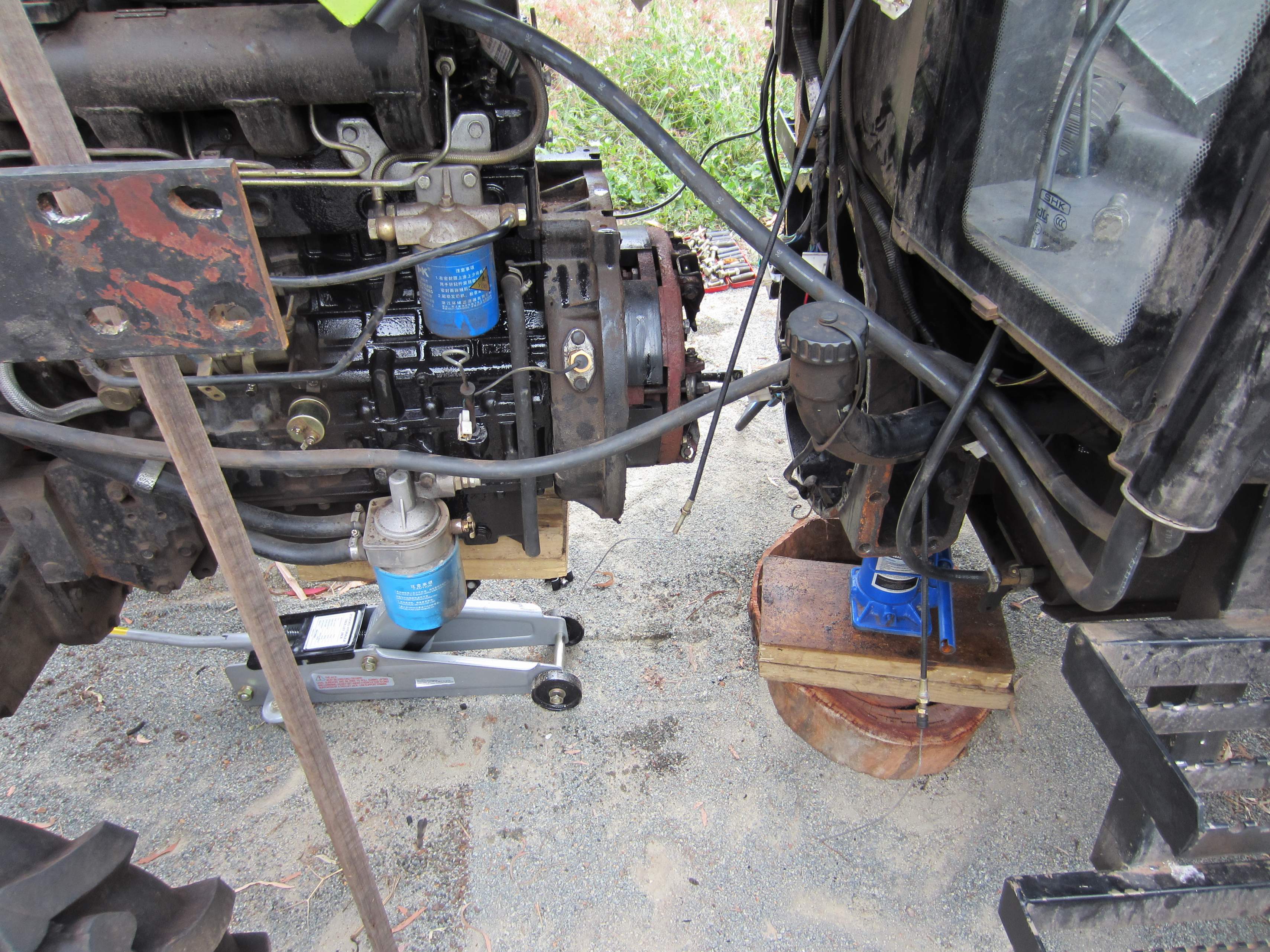

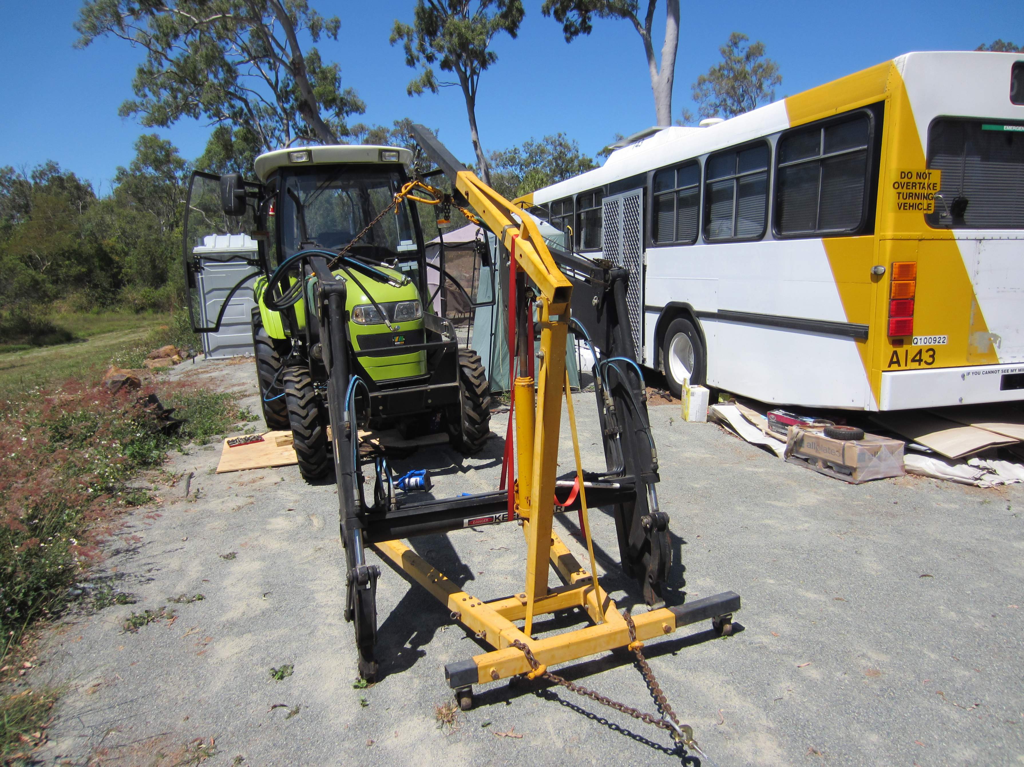

Anyway first up I drove 1000kms (600 miles) back home to get my engine crane,rigging gear & winches to remove the FEL remembering to label the hydraulic lines. IMG_0149.jpg
Then it was a matter of disconnecting everything required to split it,taking lots of photos for reference especially wiring that wasn't part of a one way plug.

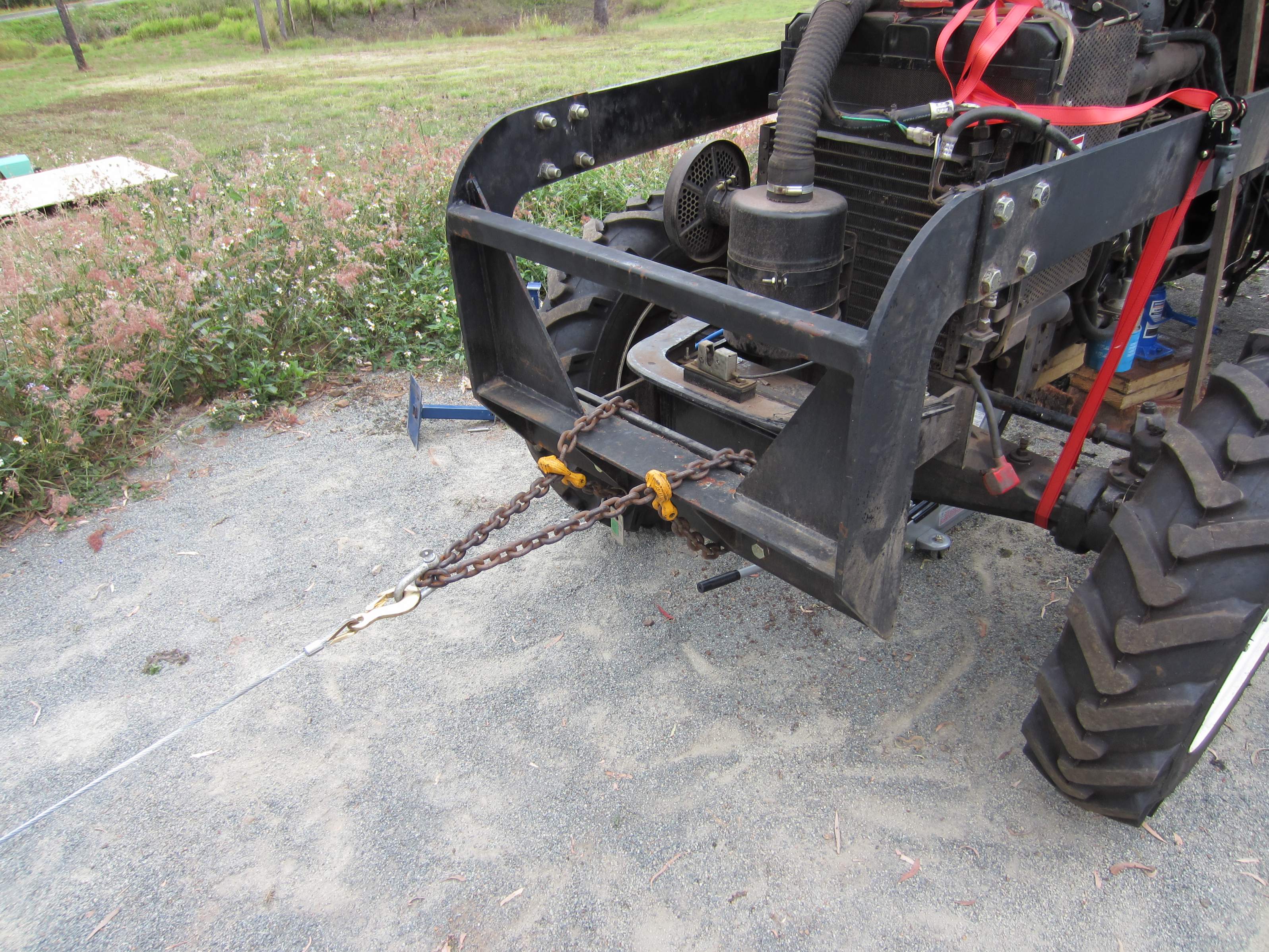

With the rear brake activated & gear box supported by a bottle jack & the motor by trolley jack it was time to gently pull it apart with the 12v winch.Note the strap to the front axle to keep it level.IMG_0163.jpg

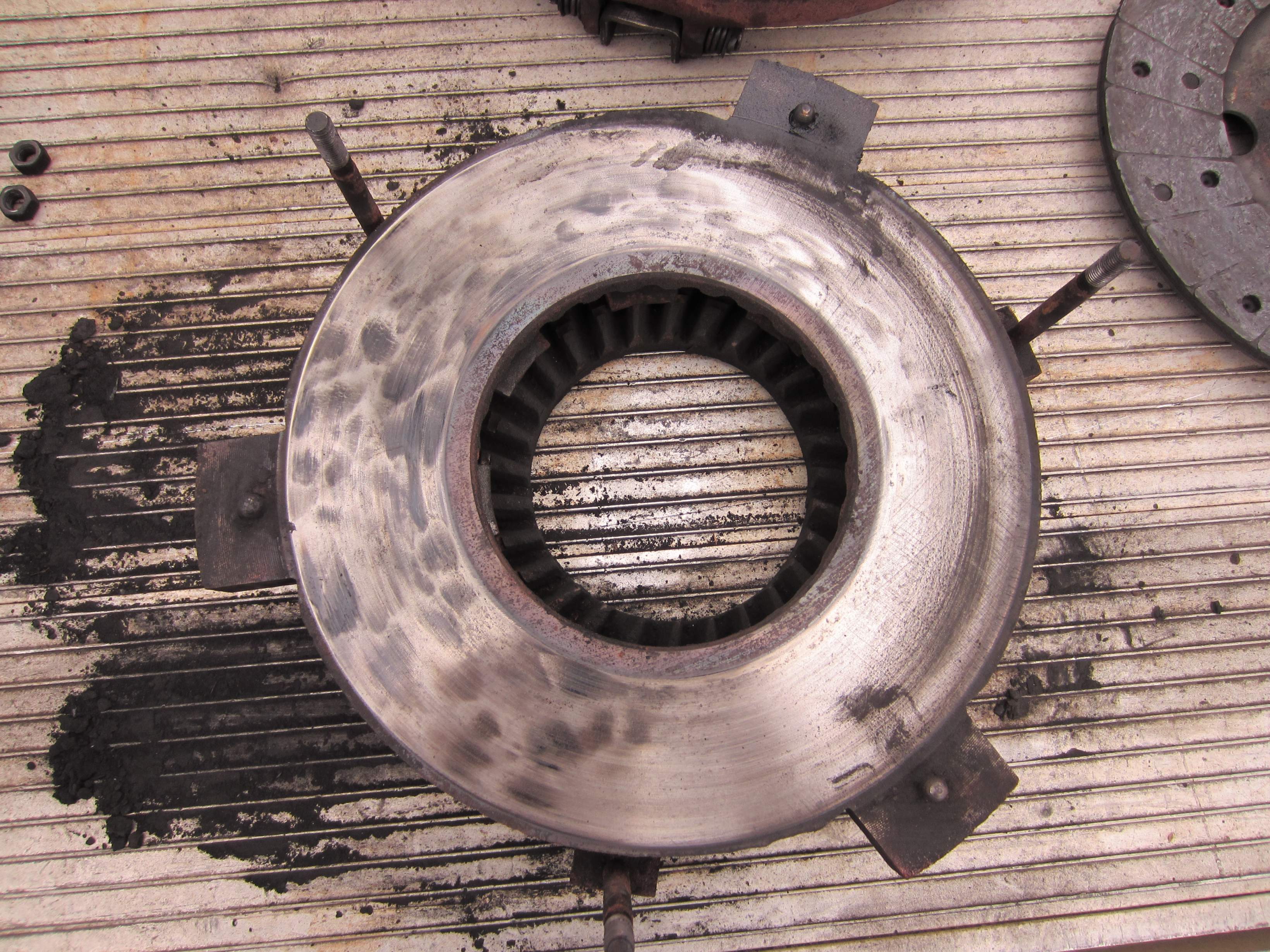

Yes it was slipping

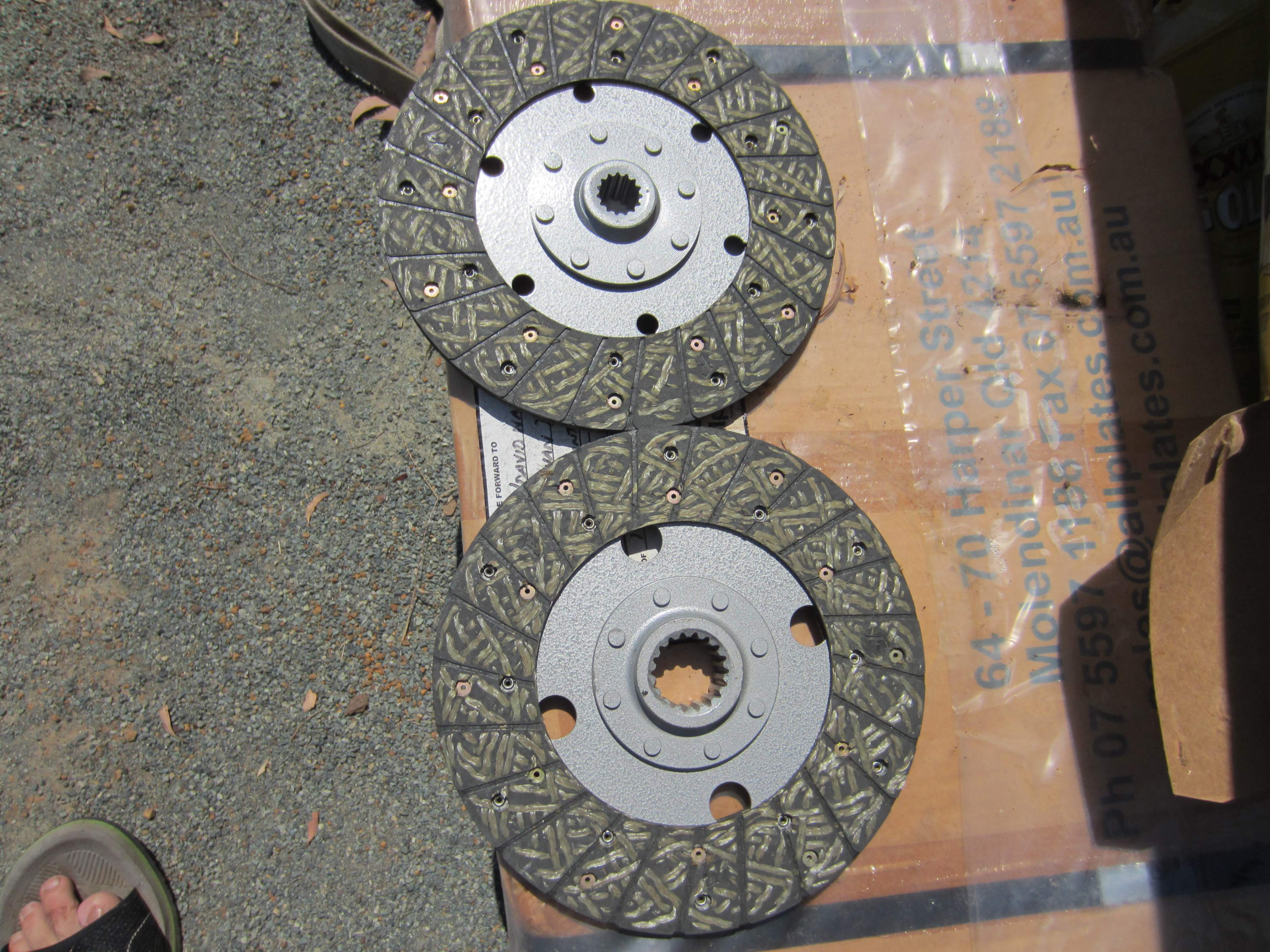

I decided to get the old plates relined rather than install original so that way if it fails again I know I can't blame the clutch material.Cost a little more than OEM ($40)IMG_0173.jpg
