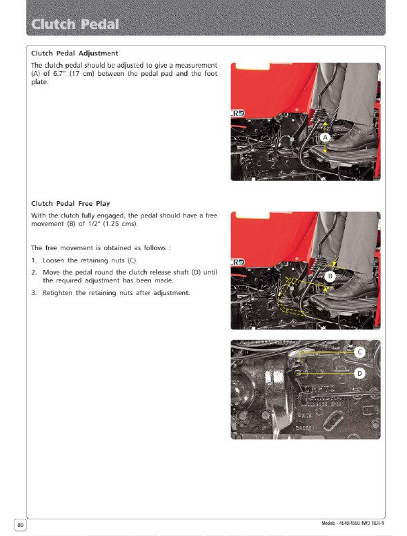

A friends asked for help adjusting the clutch on his 4550. Don't know the exact issue yet, he's going to bring it over, but been looking around for a description of the process and have not found anything yet.
Could anyone point me in the right direction?

Pg. 80 of the 4500 series owner's manual:

Thank you. He bought it used and the manual he got was for another series!
