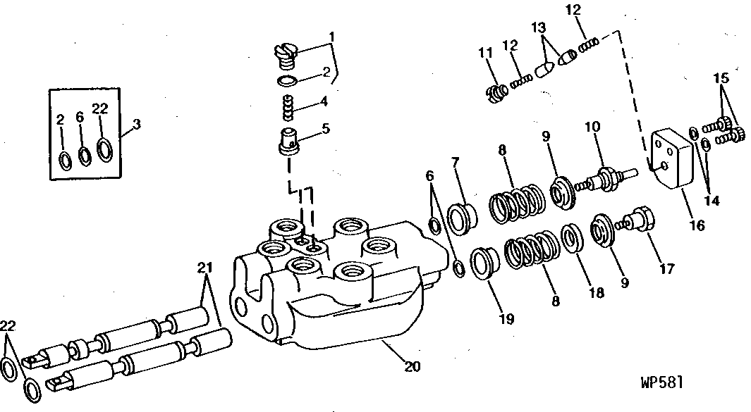

True CC spool valves have no built in relief valve as no relief valve is needed. I agree with Rick that number of tractors with OC hyd's far out number the tractors with CC hyd's. It's highly possible Uncle Bucks hyd valve is CC only as many were used back when 4020's were new. Valve in photo is a strictly CC valve from a JD 148 loader with no relief valve or orifice for CC plug.

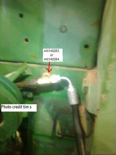

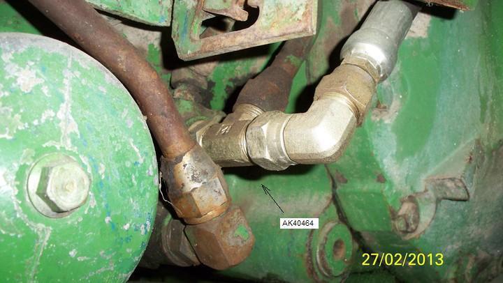

Here's you some photos for attaching a loader valve on a 4020
