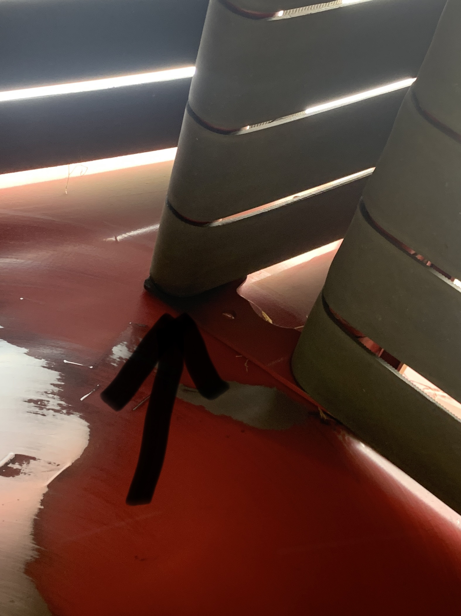

Here’s the bearing I lost on the 2nd close call. It’s not easy to see, but you can see where the bearing turned the area black. It also distorted/melted the belt there a little.
Its gone now.
Its gone now.
