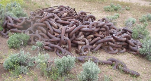

The old way of doing it is by dragging a ship anchor chain like the one in the attachment between two cats.
I've had luck with just a box-blade. If you're just looking to kill sagebrush, you don't need to uproot it - in my experiance you just need to mash it. Rabbitbrush and ephedra will root-sprout, though. Not sure about the various saltbushes and greasewood. Around here, there's ususally a good number of those bushes mixed in with sagebrush.
I'd think twice about whether you really want to get rid of the sagebrush. Unless you are planning on irrigating, I don't think you'll get better pasture by removing the sagebrush. It'll also be uglier, less wildlife-friendly and more fire-prone.
