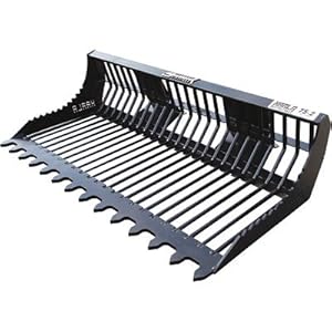

Hi Team :D ,
I'm wanting to clear a lot of rocks off the surface of our field. I know there will be more surfacing each year, so I'm looking for a way to do this from time to time without getting a rockbox (too expensive, one use item).
One option that sounded neat come from this post: http://www.tractorbynet.com/forums/attachments/230045-72-inch-rachet-rake-sale-41.html#post2785224 Also, I'm thinking this tool could be useful for reseeding areas, smoothing clods and dirt, and even getting a smoother (and less rocky) driveway, used in combination with either the boxblade (as in the post) or the FEL (for clearing simple brush). I like a multi-purpose tool, and this one is quite inexpensive.
From what I've read, a landscape rake will not help me much with this kind of rock. Please chime in if your experience is otherwise. I'm looking for any advise, help, or suggestions, based on experience. You know my goal, and keep the budget low. :thumbsup:
See attached pictures for variation in the rock size on our property. If the tool can't handle the biggest ones seen in the middle picture, that's OK, as they are fewer and fairly easy to run around and collect in the FEL or wheelbarrow.
-Mitch
P.S. No one is under the hat... it's just there for size comparison! :laughing:

In addition to the RR, looks like you might need a rock bucket. There are many different manufacturers, but the Haala Barracuda Utility Rock Bucket at Northern Tool is an example of one.

You need a rock rake to windrow the rocks & then find a way to pick them up without the dirt.
