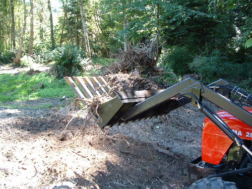

Do you have a FEL? I am doing the same thing right now, trying to clear around stumps and piles. I made the bucket in the attached picture. I run it along the ground ahead of me and brushhog VERY slowly. It catches under logs and other debris and allows me to lift it up out of the bushes to evaluate it . If it is small or rotten enough, I dump it and run over it so the hog can chew it up. If it is too large, I re-position it out of my way. If I run the bucket tines into an immovable object such as a stump, rock or dirt pile, the wheels start to dig in and I stop the tractor and pick another route.
Since it was logged, be on the lookout for non wood debris. I found a 50' length of 1" dia steel logging cable the other night. I ran over the end of the cable and it didn't get caught in the bucket tines. I got lucky and only about 4' of it got up into the cutter blade and slowed it down untill I lifted it off. I was able to stop the blade and back away without it getting tangled.

No FEL. But it is not as bad as that picture. The previous owner piled up a lot into windrows and halfway burned it. They did leave alot though. I was hoping for some kind of miracle 3pt implement /forums/images/graemlins/grin.gif

Man , that looks like a park compare to what loggers left me.
</font><font color="blue" class="small">( Do you have a FEL?)</font>
I've got 2 7/8 heavy drill stem on sides of bucket for log forks . I'm going to turn an old SuperC dozer blade into brush fork similar to yours, after I rebuild my shed, put new flooring in kitchen,,clean out the barn.............

That was an after picture, It was the only one I had handy with a reasonable piture of the fork bucket in it. What I am clearing now has brush(Salal, Balckberries, scotch broom, vine maple sapings, ect) that is mostly taller than the ROPS on the tractor. It is like driving into a wall. I cycle the FEL up and down to follow the ground contour as it changes and to sometimes push down the brush. I have found 3 slash piles that I never even knew existed because the brush covered them so completely.
