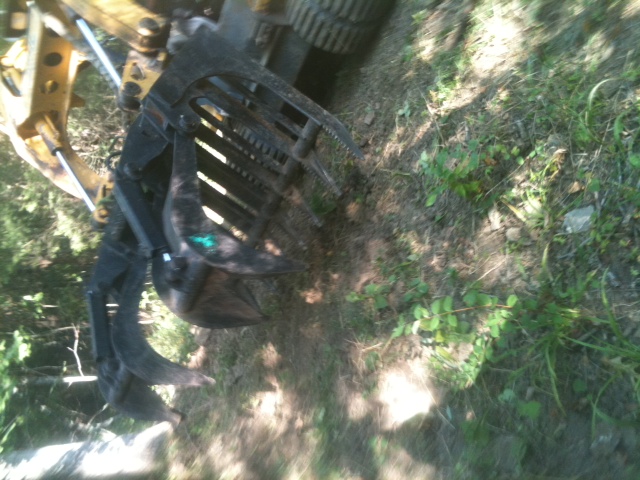

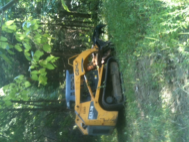

   / clearing for a food plot #7
This is what I use to do it all!!
attachment.php
attachment.php
