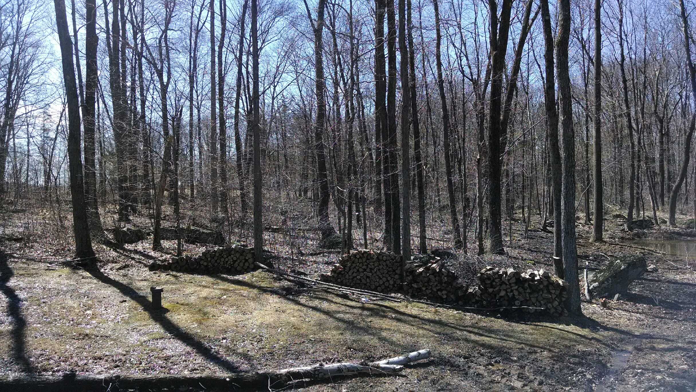

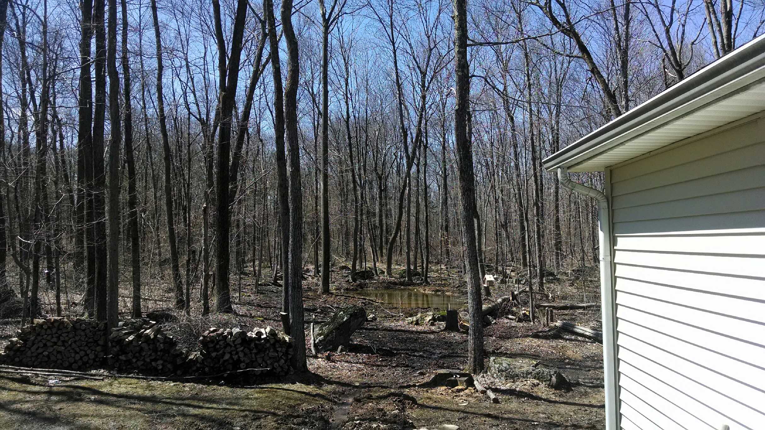

I want to thin out a 1/2 acre in my backyard for recreational purposes. I want to leave about 1/3 to 1/2 the trees and clear all the brush. I've took a few trees down and cleared some brush but the amount of brush and small branches left over is overwhelming. My lot is also very wet so wood chips would be nice to have to elevate walk ways and paths.
So I'm contemplating buying a wood chipper vs renting. On one hand renting is nice, no maintenance, no storing it, and I can rent a bigger machine then I could afford to buy. On the other hand I have to make time count while I'm renting and it is only me and my wife so we only go so fast. I plan on living here in the woods until I pass on so how many times would I rent one and will the rental fees be over the purchase price? I don't need a monster chipper, anything over 3"-3 1/2" I save for firewood.
Pros of buying one is the ability to use it whenever I want or need to. But I don't want to spend more than $1000 new or used. What kind of chipper can you get for that kind of money?
So what do you guys think?
Here is the piece of land I want to clear.

Looking at the pic of your property and your goal of clearing 1/2 acre for recreation purposes, I wondered how or if you will deal with the stumps. Also, once you let some light in, you will have a 1/2 acre that wants to fill with something, and it doesn't look very mower friendly--no offense. :)
