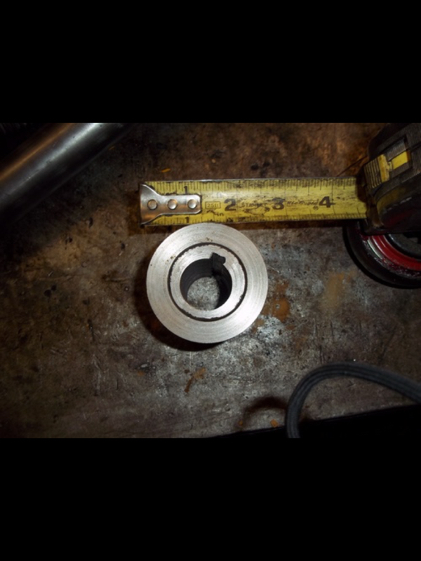

I make them as tight as I can get and still push together by hand. I like to make the inside piece first and polish the outside. Then I bore the outside piece about .003 undersized and hone it out. The is makes a smoother running bushing than i could do on a lathe alone.
