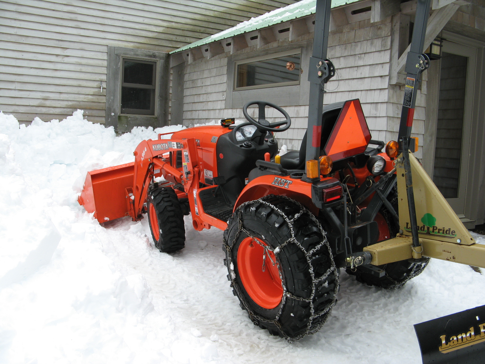

No spacers needed with those chains. Don't know about the B3030 - mines a B2620. They don't need much room though, and they are good.

Whoops, I didn't need spacers but man, you must almost no clearance because those are pretty low profile chains -top and sides. Sorry hope I didn't mess you up, but I think they are the most compact chains you can buy.

Looks like I've got about 2 inches of clearance on my B2620 between the r4 tire wall and the inside of the fender at the closest point. The chains I have which are in the picture take up about 3/4 of an inch of that space. Possibly a little more in places to be safe.
I had tried Tru-Grip chains at one point and they did not clear, the links were to big and gommy. They are ridiculous for a small tractor anyway. I took them back to the dealer and he told me to buy these which was a probably bigger profit for him but they work nice.
Good luck hope this helps.

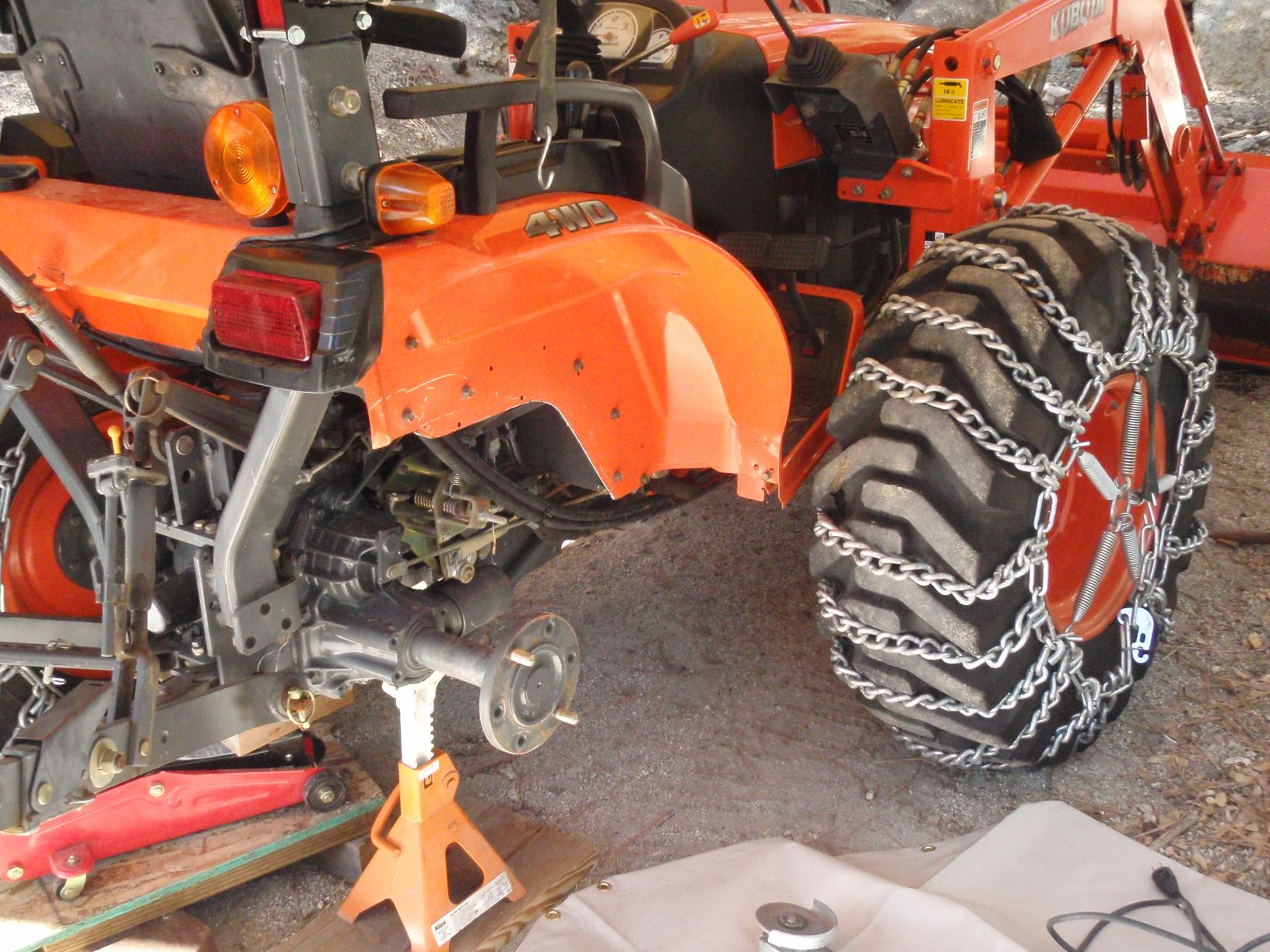

I purchased two link ladder chains for my B3030 with R4's. I found that the connection link rubbed the back part of the fender well. After removing the rear wheels and trimming about an inch and a quarter off the bottom of the inside fender ... no more rubbing. Of course I primed and painted the exposed steel. Next month I will be upgrading to a L5740 HSTC, I'm tired of being wet and cold!

The B3030 cab model must have different fenders. I have tire chains on mine that I made up from 11x22.5 truck tire chains & have no problems with clearance. I bet you'll like that L5740 HSTC. I sure would. But I didn't need a bigger tractor when I bought my B3030HSDCC. I have an Oliver 77 for when I need something bigger.
