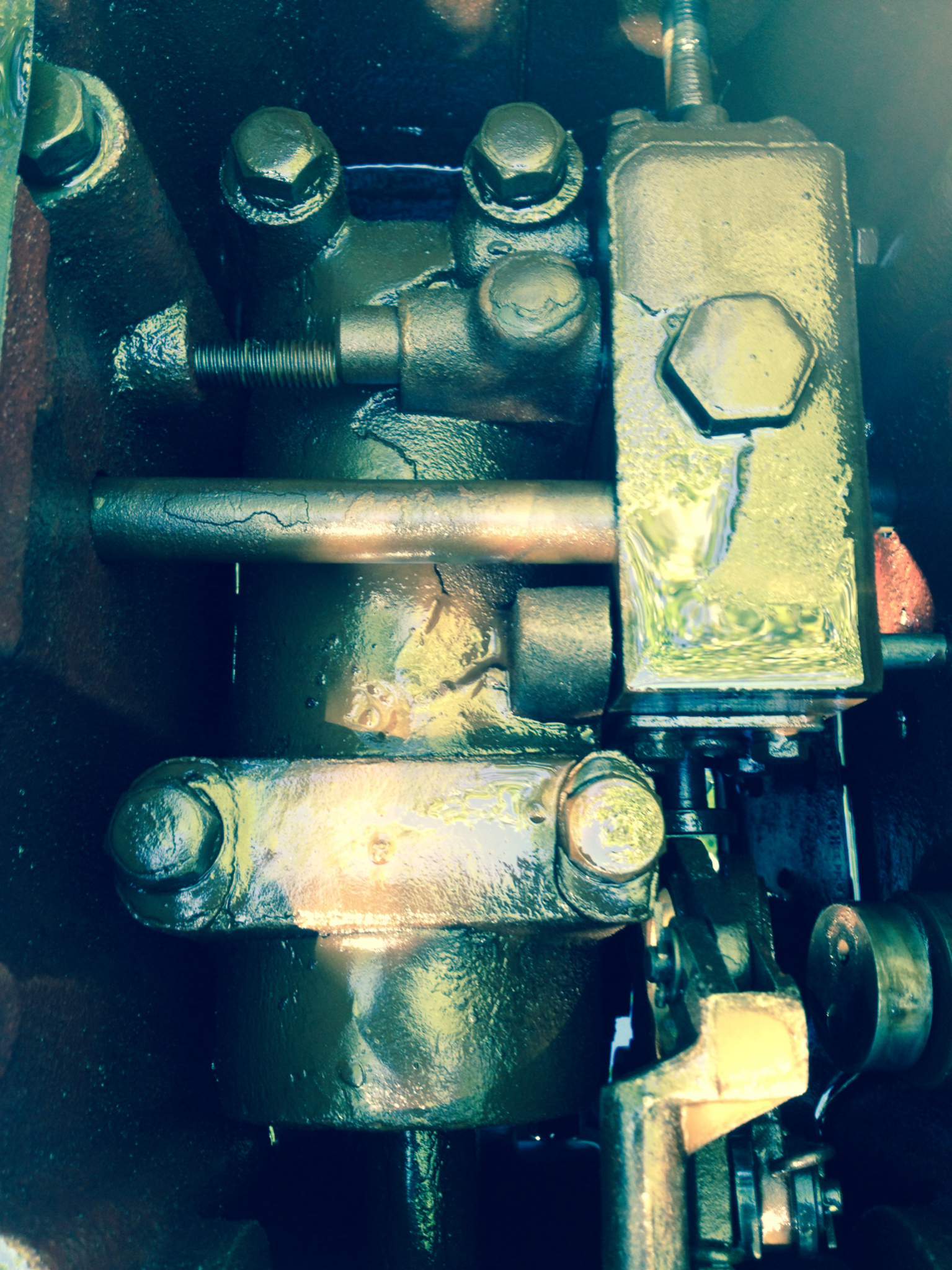

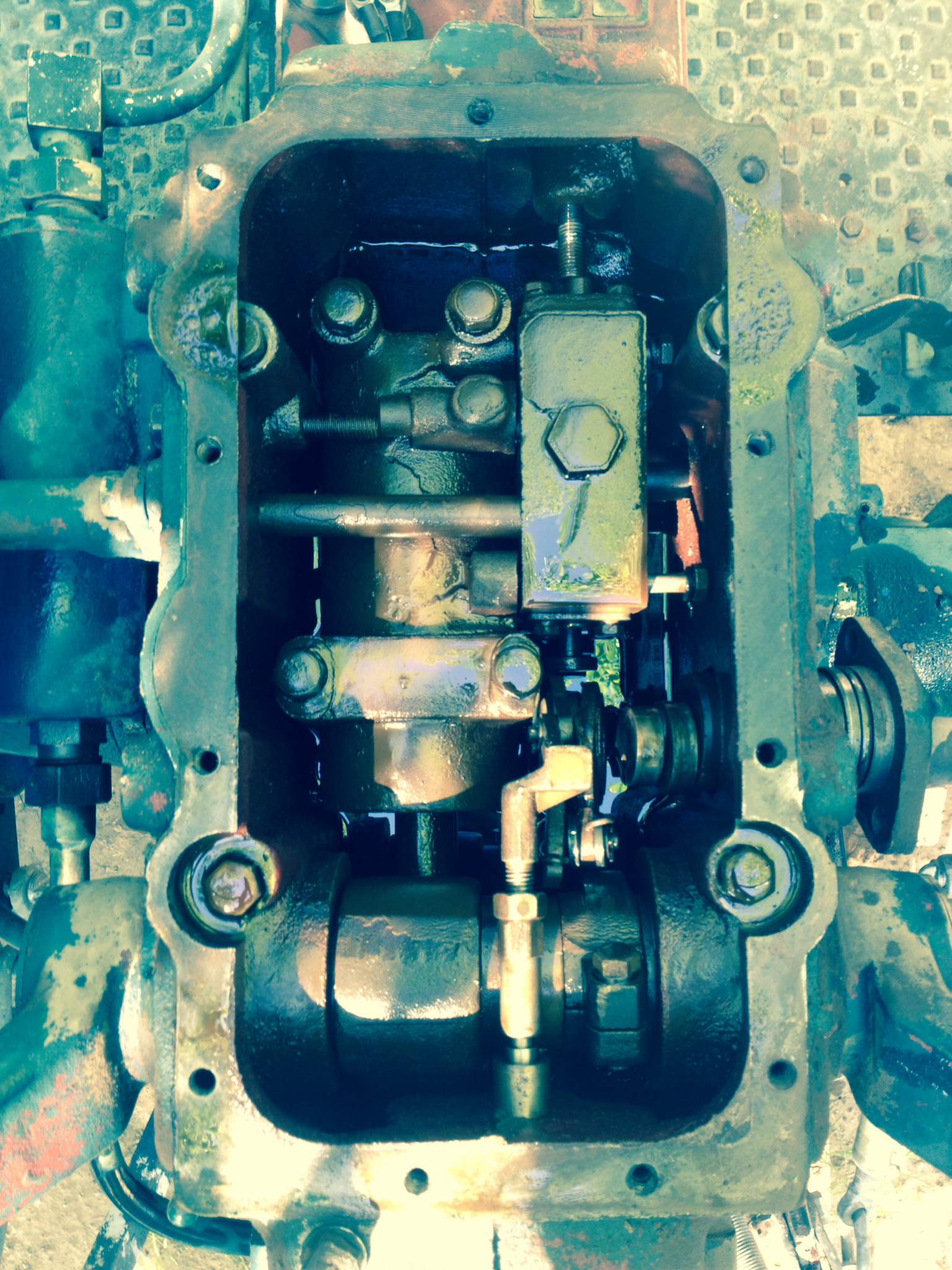

Any advice on how to clean the sludge?

yes thats the sump under the seat.
thats exactly what im going to do.. thx

Guys thanks for the responses. I have taken apart the whole sump and identified 2 or 3 possible issues that someone might be able to identify as being an issue... i'm going to post that on a new thread. And thanks again..:thumbsup:
