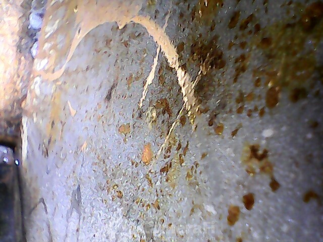

I recently acquired a 25 gallon diesel storage tank and plan to mount it on a small trailer. The tank is empty and has been for an extended period of time..
Best I can tell the tank is dry and sludge free. However, It has some rust on the bottom of the tank. The rust is not severe, but I obviously need to clean it before I use it.
It has a drain plug. I also have the ability to lift it and turn it upside down if need be.
I have read several cleaning options....chemicals, vacuming, molasses, muriatic acid, etc. .....but still not sure what is the best method to use.
I will install a filter on the pump once I get it cleaned out.
Attached is the best picture i could get....in some areas the rust is heavier....but for the most part the inside is in pretty good shape considering the tank has been idle for at least 7 years.
Suggestions?

pressure washer to get all the loose stuff out and then fill it with diesel .. good filters and move on to something else
   / Cleaning Diesel Storage Tank #3
Almost looks galvanized. If so, it isn't good for diesel storage.

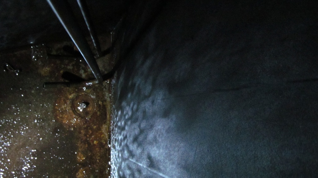

That is probably a coating like inside the diesel tank on my backhoe.

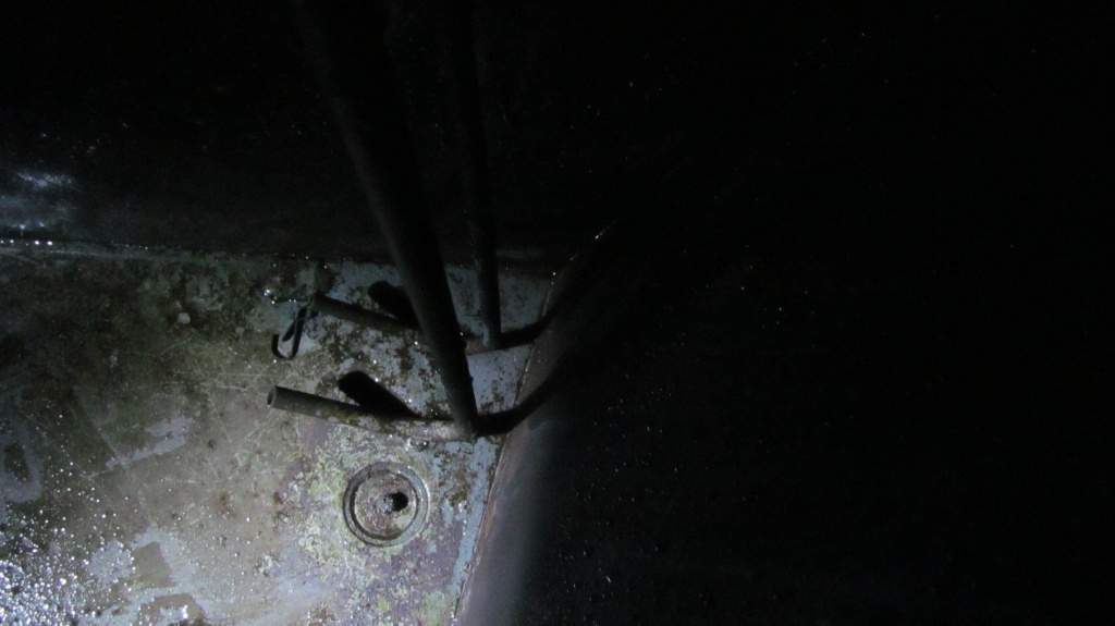

I cleaned the rust out of my backhoe tank with a 50% water and vinegar mix. Washed it out with the pressure washer before and after soaking for 24 hours. Dried it out with a heat gun.
Here is the before picture.
Here is the after.
