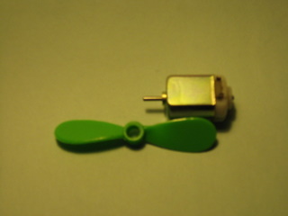

OK, this is really off topic. I need to adapt 20 plastic propellers to fit a small electric motor shaft. The hole in the propeller is about 6 mm and the motor shaft is about 2mm.
This is for a 4th grade class studying electricity, motors, etc. The propeller fit doesn't have to be dead accurate, but I don't want to embarrass myself, either.
I'd rather not wrap tape around the shaft, so I'm looking for other creative ideas.
Thanks in advance.

I might need glasses,but it looks like blade will hit motor if fasten??..also motor shaft smaller than blade housing,if so than adapater shall be needed.

How about using a prop adapter:
Prop Adapter
   / Class project - adapter for small motor #5
Fill the propeller hole with epoxy (PC7?), then drill after it sets up...
   / Class project - adapter for small motor #6
I second forgeblast's suggestion, quick and easy. You might also consider a 2-part quick-setting epoxy, but don't let it run into the motor.

Never tried to find rubber tubing this size but someone may make it. 5/64 ID with 15/64 OD, glue onto motor shaft and glue propeller on tubing. Have seen 1/8 ID at automotive supply. Don't know if they have smaller or not.

For an economy solution, as most class rooms need, make bushings by boring a 2mm hole in a 6mm (1/4") wooden dowel and cut to length with a coping saw. 4th graders are old enough to learn coping saw techniques.
If the fit is a little loose a dab of epoxy could be used or a few drops of water may swell the wood enough to temporarily tighten the fit. Or use water on some and epoxy on some. I can see all sorts of things 4th graders can learn from this.
