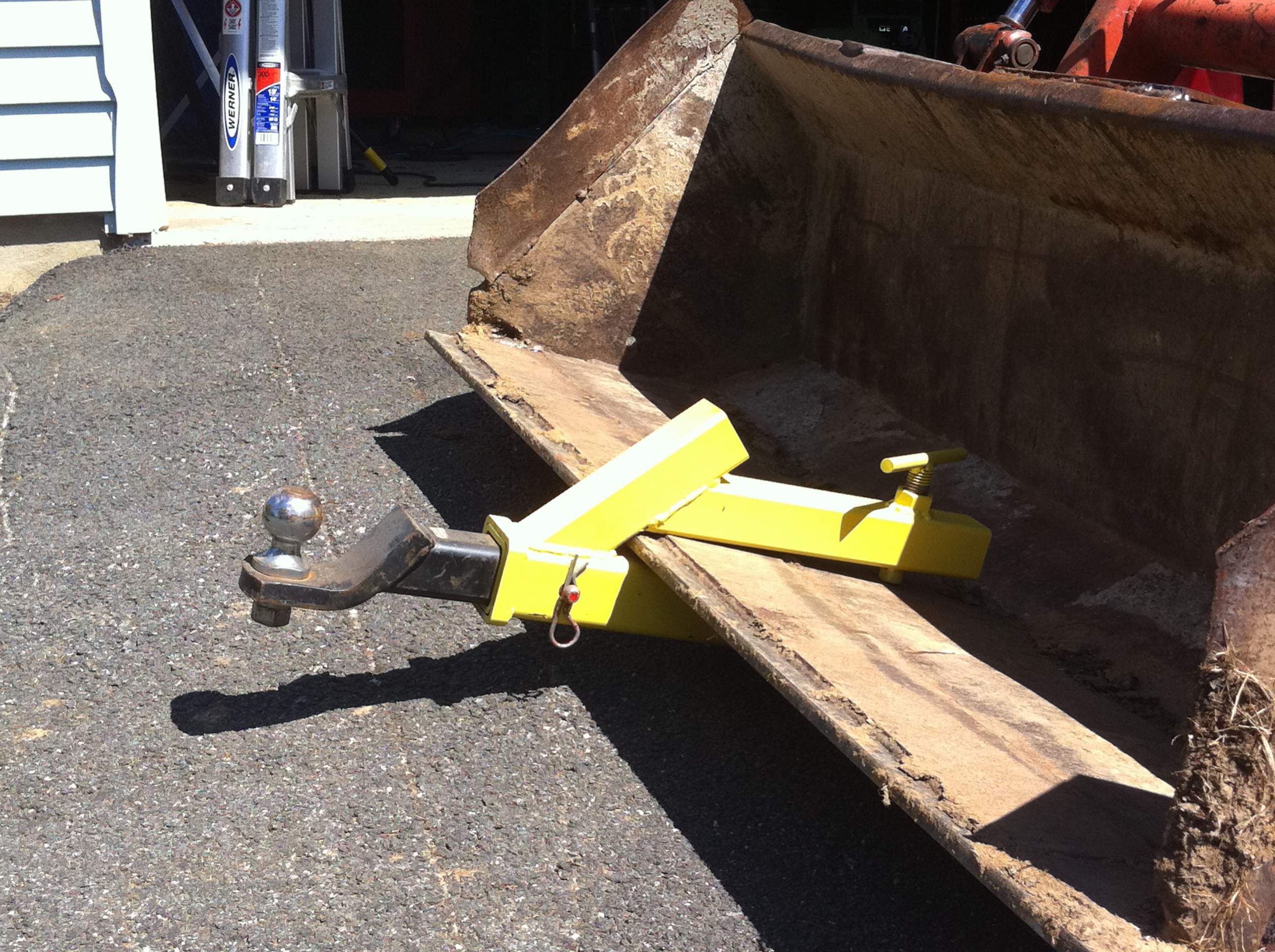

I wanted to get one of these for a while but could not justify the $80.00 and up price tags that I was finding online. After looking at many of them I decided that it was a really easy project to fab myself. It took me less then 1 hour and I spent $30.00 at tractor supply for the receiver tubing, 7/8 grade 8 bolt and nut, & solid rod. I have been moving trailers around my property for the past month with it and had no problem moving a dump trailer with about 1500lbs of sand in it. I have attached photos and construction was simple. I hope others follow my lead take the time and not pay $80.00 for something this simple

rob,
That looks great! Nice and heavy-duty. I love loader mounted hitches. Kind of hard to see it from the driver's seat, but sure handy once they're hitched up.
