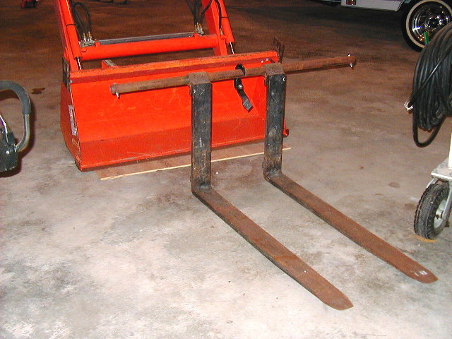

Steve -
I posted comments and answered questions (to the best of my newbie ability) about bucket forks in this post. This style of fork should work on just about any kind of bucket as long as there's no toothbar or similar add-on in the way.
Oh, and as Bird suggested, I've attached the photo.

Bob, it can be a problem seeing the front end of the forks over the bucket. Sometimes I have to stand up to see exactly where they are (and that's with 4' forks).
sdsjr3, my brother got me a set of used forks from a regular forklift and we did a little welding. I don't know whether, in this picture, you can see the plates on the ends of the bucket that we welded on so the pipe that the forks are attached to can slide into the holes in those plates. And of course I haven't painted mine so they aren't nearly as pretty as Harv's.
Bird

sdsjr3, that will probably work, but I'd just never trust it to hold. The back of my forks rest against the front edge of the bucket and are not attached there, so if the bucket is dumped far enough forward, the forks can swing out; never been a problem, but they're very securely attached at the top (unless one of my welds breaks/w3tcompact/icons/laugh.gif - and we hope that never happens).
