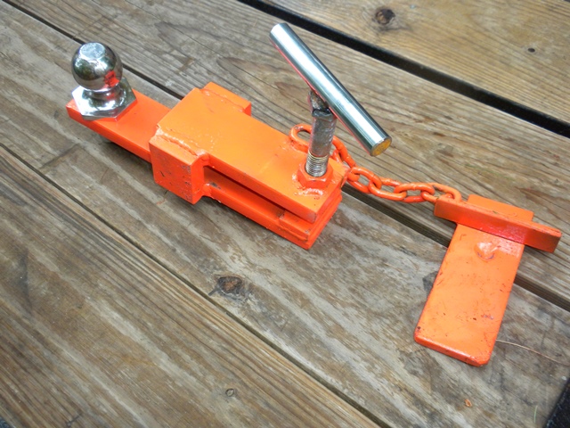

Can anyone remember if there was a thread about a clamp on trailer hitch? Seem like I saw one years ago, but I believe the fellow has passed away. Thanks, smoker

Clamp on to what? Northern Tool sells a clamp on ball mount that will clamp onto a front end loader.

Here's my Disney Mouse contraption Summer2010 001 - Copy.JPGSummer2010 002 - Copy.JPGSummer2010 003 - Copy.JPGSummer2010 004 - Copy.JPG

Yes Sir Mr. wdchyd , that will do just fine! Thank you very much, smoker

We have used this one, Tractor Bucket Hitch Receiver
The lip under the bucket bears against our Piranha tooth bar to prevent it from sliding back and losing your trailer/load. The clamp/receiver will work side to side somewhat if you do a lot of turning. A couple of clamps or vise grips holds it straight as as they take up space between the hitch and toothbar teeth, preventing sideplay.
It save us from having to take off a backhoe. YOu have back everywhere, and be very careful of how the bucket magnifies your turns. But, it works fine.
