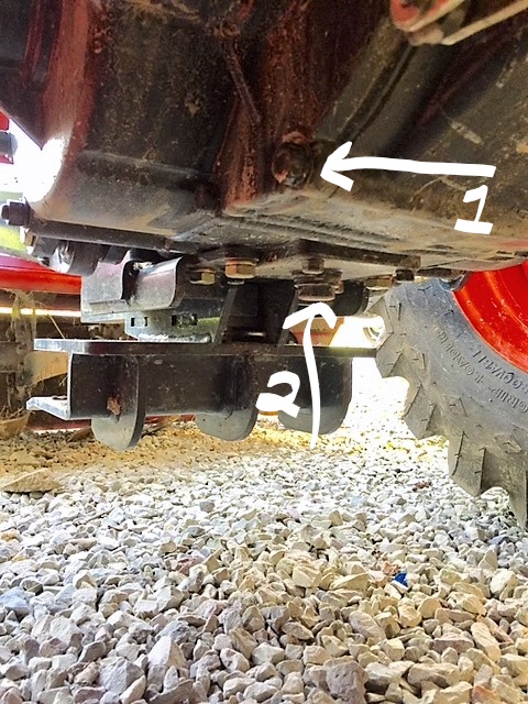

Ok, I know this is a stupid question(s), but I am just not sure the manual is correct on this. It shows that the drain plug for the hydraulics is the one labeled with a number 1 in the pic below, but it looks to me like that is one of the bolts holding the rear end casing on, and not like a drain bolt.
However, the one labeled number 2 in the pic looks more like a main drain plug and is located where I would expect it to be... So, is the manual correct? If so, what is the other big plug for? I am doing the 50 hour service and I am just going to drain and replace all the fluid as well as the filters for the Hydraulics and HST. Which BTW, does the one plug drain it for both the Hydraulics and the HST transmission? I know they give separate fluid totals for each in the manual, but I didn't see any place in the manual for a separate drain plug or fill plug for the HST.

it would appear they both are drain plugs. I'm sure another CK owner will pop in and tell you. Looks like #1 is a little lower than #2, which would get the last bit out in that lower case area. You'll find similar in other tractors that will allow draining pockets by the rear axles. Your Hydraulic fluid and HST fluid is all the same, mixed in the transmission. Thats why you'll see "hydraulic transmission" fluid sold.

May be the angle of the pic, but I believe #2 is actually lower on the rear end. I started to break loose the one labeled as #1 since that is where the manual showed it, but I am going to need a breaker bar to do so, it is tight, tight TIGHT! Couldn't budge it with a standard 1/2 in socket wrench.

I would have no issues unscrewing both of those hex heads to see whats up. I know my factory manual was a little off on a few minor things, so this wouldn't surprise either way.

ALL the drain plugs and fill points are colored orange (Kioti orange) to make them easier to find. The drain plugs up front have one on each side for the front axle, and the main drain is bigger with a magnet in it. I used a plastic 55 gal barrel cut down to about 8" for a drain pan. I bought a filter wrench that looks like a large pair of channel lock pliers...no problem getting the hydro filter off...don't go cheap on the wrench, it has to be sturdy.
