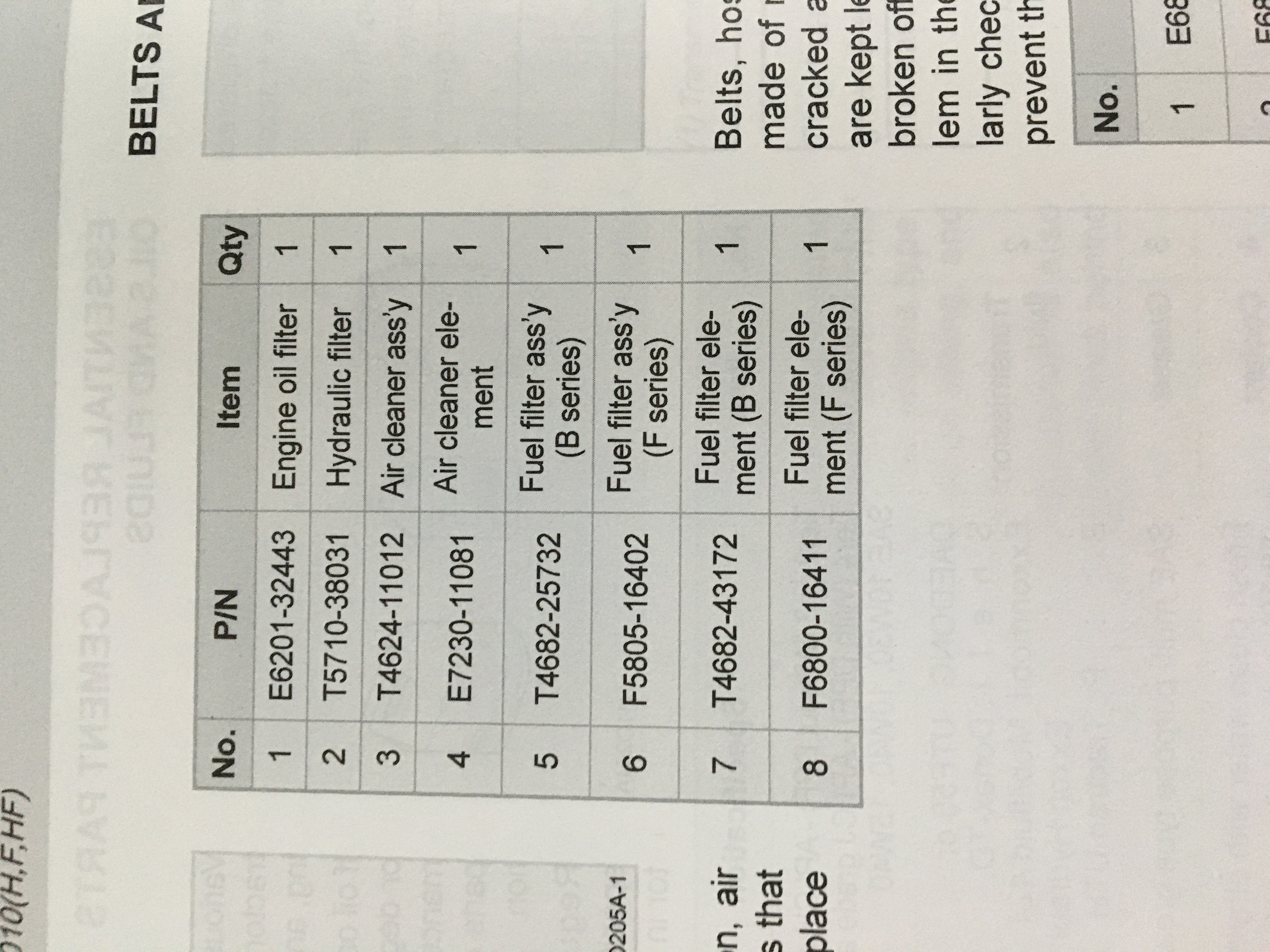

I finally hit the 50 mark over the weekend and looked in the owners manual for the filters and they do not list the HST filter.
I want to replace all of the filters with OEM filters. Does anyone know the Kioti part number for this filter? Which fuel filter do I need? It lists series B and series F.

Oil Filter: E6201-32443
Hydraulic: T2185-38031
HST: T5855-46531
Fuel: F6800-16411
Kioti did good, as the fuel filter cartridge on CK4010 is the same for all Kioti tractor models in the CK, DK, NX series.
They did bad, giving that same fuel filter cartridge, many different part numbers depending on the model series..but in reality, they are all the very same filter. I would order a fuel filter, even though it's not needed to be changed for the 50hrs.
Also note, the slight change in part number for hydraulic filter. Not a big deal, as we all call it simply the #38031.
I also would order an extra fan belt, just to have a spare belt handy.
Go on Ebay and make your order. Delivery in 3-5 days.

Thanks for the info. What series (B or F) is the CK4010?
What is the difference between the hydraulic filter listed in the manual and the one you gave?
   / CK4010 HST - filter part numbers #6
I honestly have never seen the CK hydraulic filter, identified as the listed part in the manual. It's either a typo or possibly the factory installed hydraulic filter, which is different that replacement filters.
The actual hydraulic filter is: T2185-38031
Regarding your fuel filter, there are multiple part numbers issued, because all fit your tractor.
The actual fuel filter is: F6800-16411
Changing the Hydraulic and HST filters is quite messy. Be sure to have a large pan to catch the spillage. These are initial factory filters, and are painted over and very hard to come off the first time.
