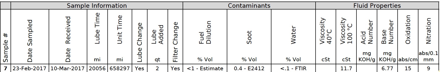

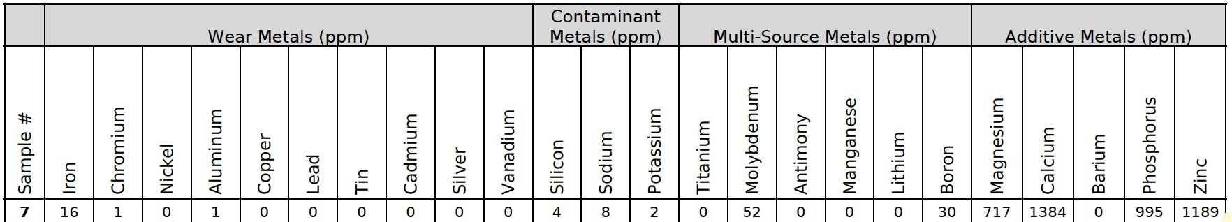

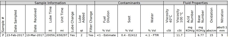

Update:
Just got results back from using Delvac Extreme 10w30 CK-4 in a Detroit 60 engine with 658,297 miles on it (after the factory reman) and 20,056 miles on the oil. I think that CK-4 is more than up to the task of protecting things......
