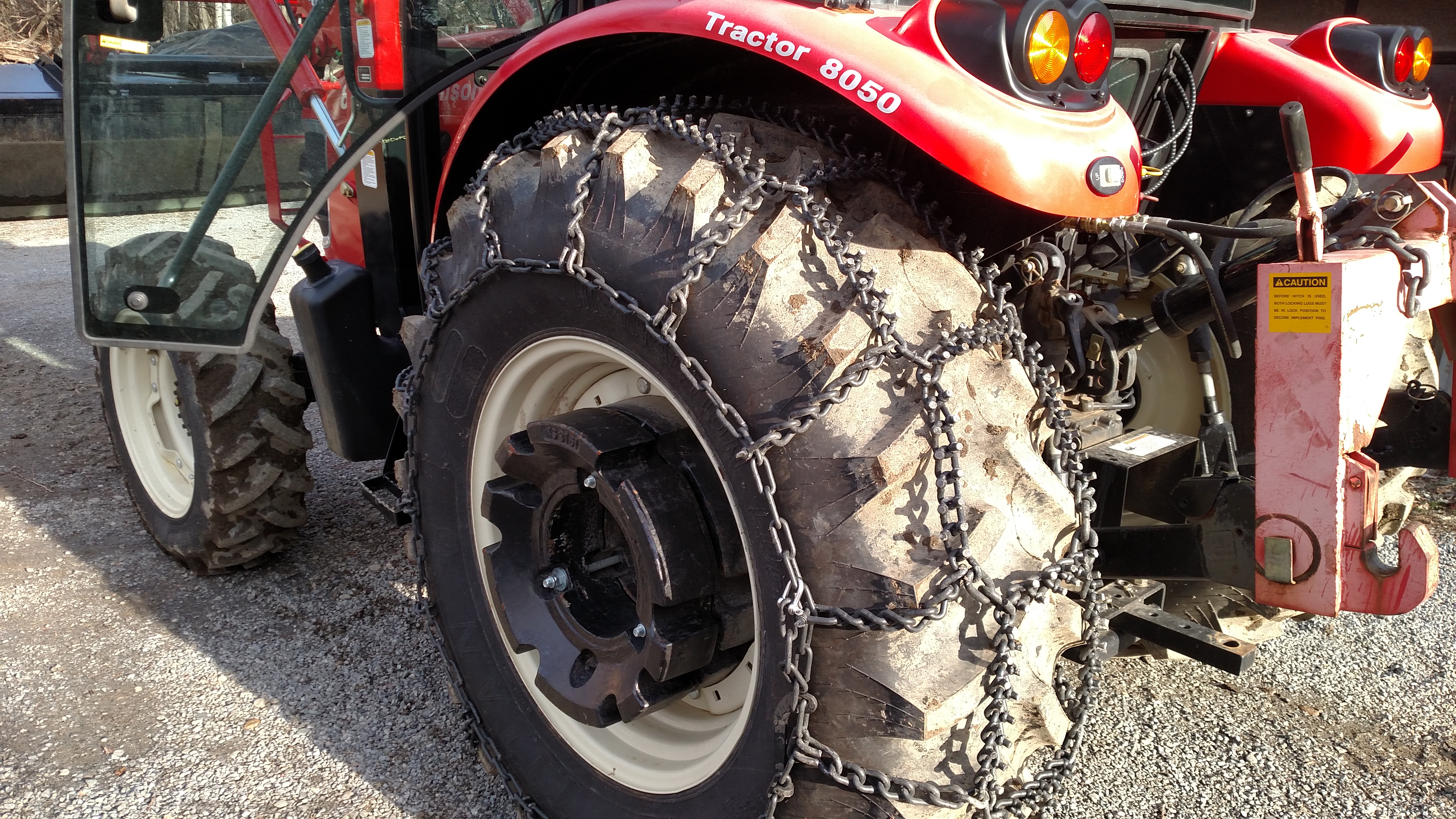

Hey guys, so I've searched but couldn't seem to find an answer about tire chains. I have a CK3510 and recently sold my plow truck and bought a quick attach power angle snow plow. I'm looking into tire chains and origanially planned on buying a set for the front but now I think I'd rather buy a rear set. Question is, do I need spacers to run a rear set? I run R1 ag tires if that makes a difference? Also, any recommendations on which chains to run. I was thinking either double ring or a H pattern set. Thanks

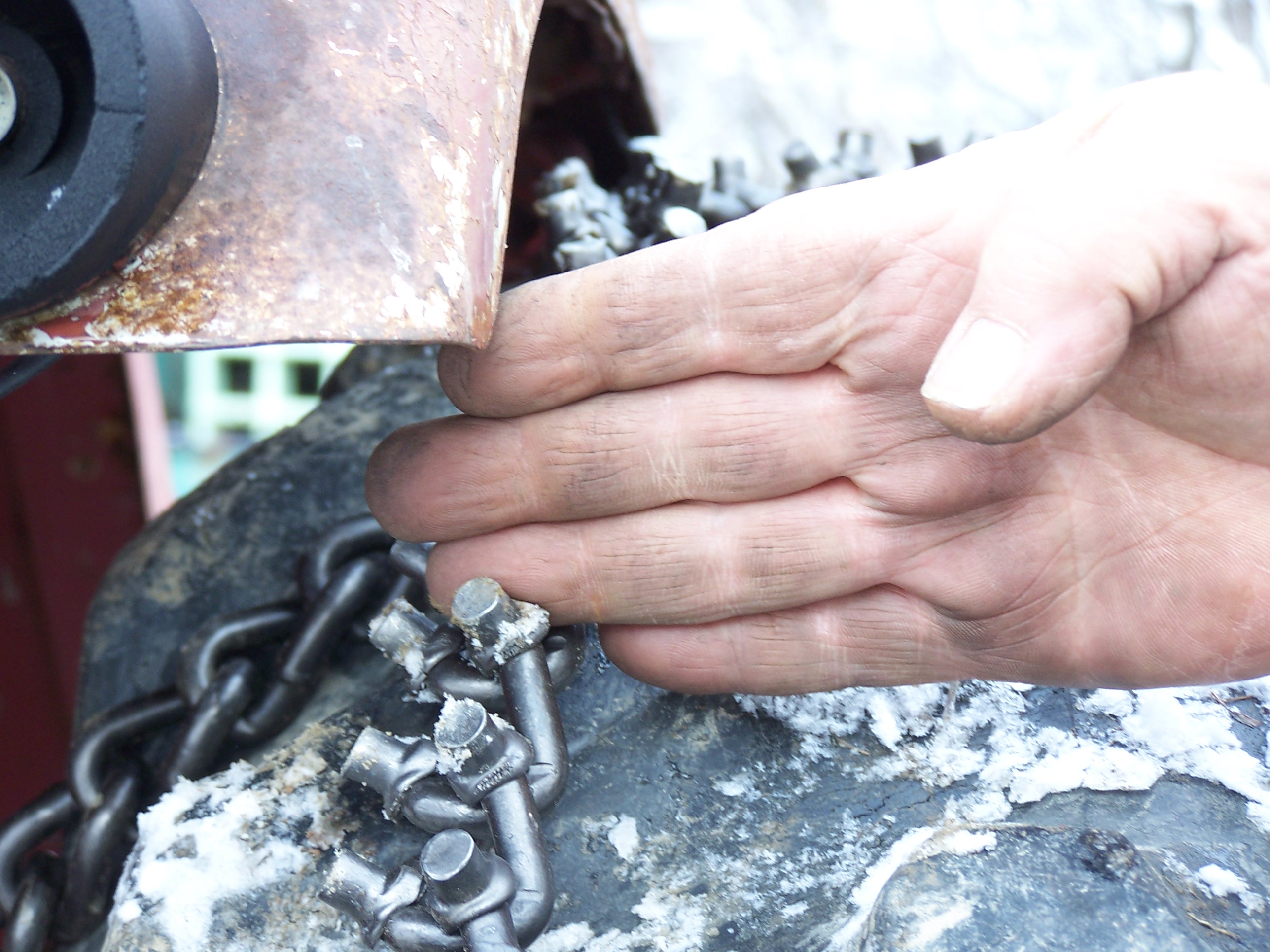

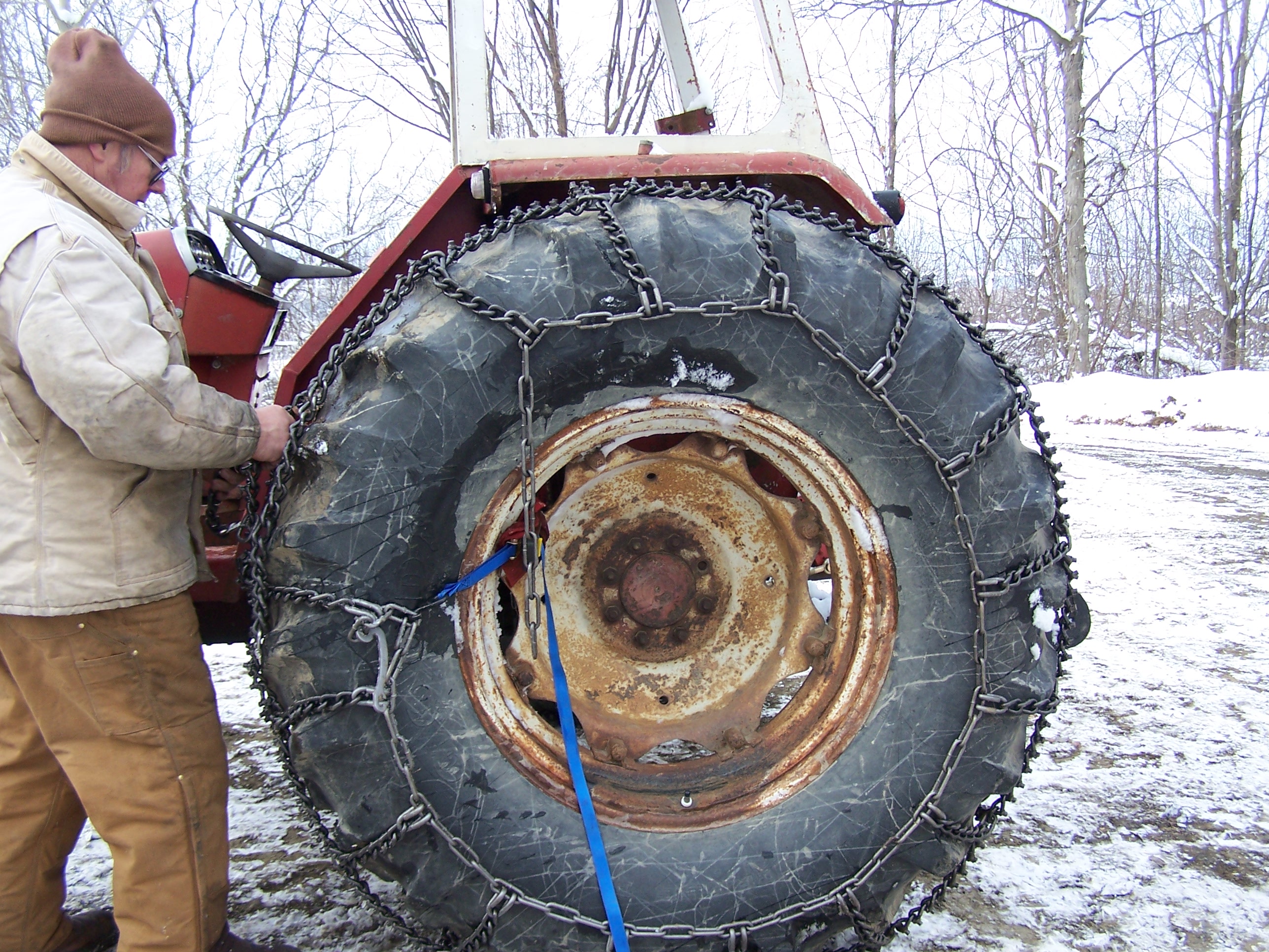

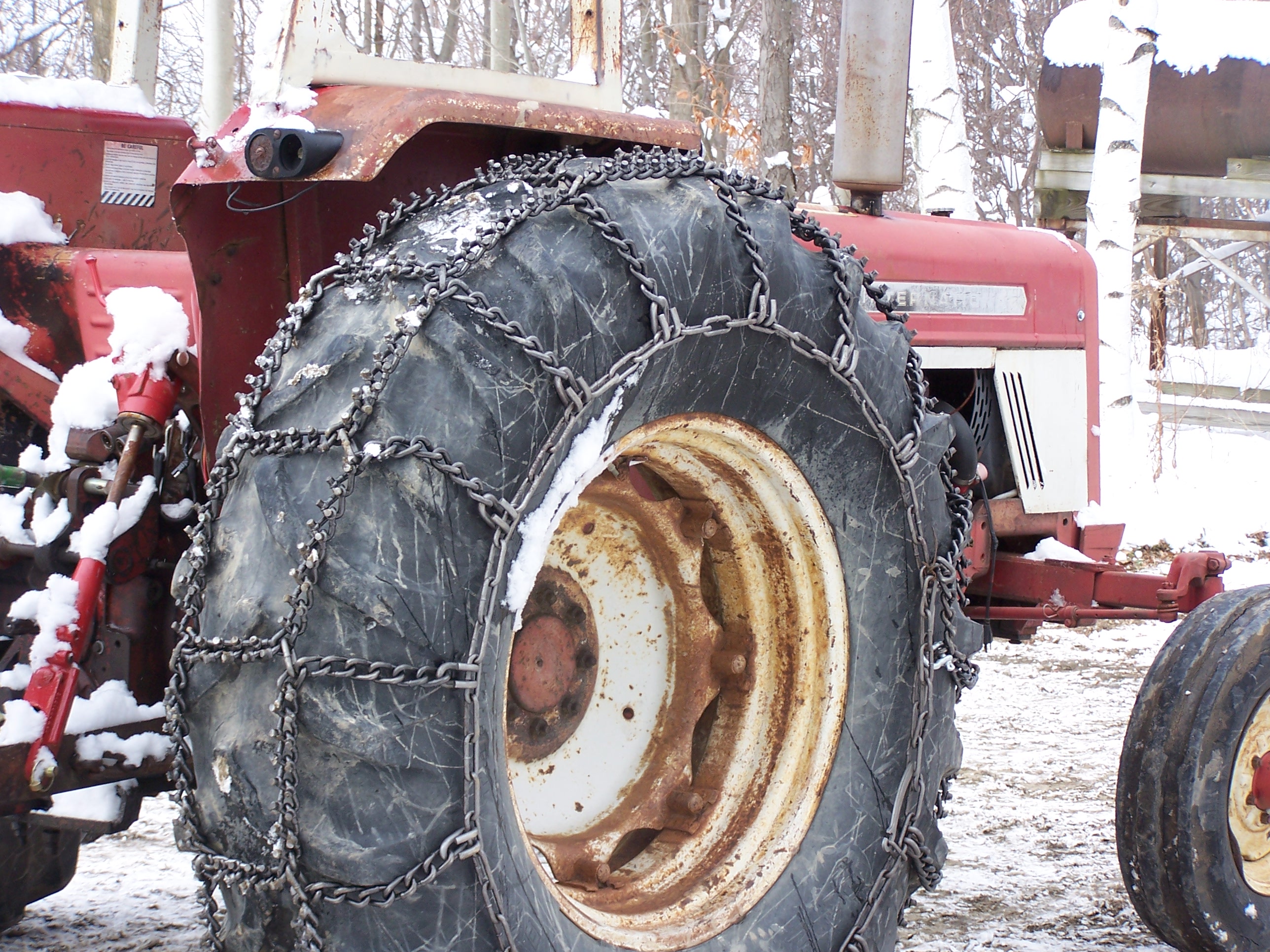

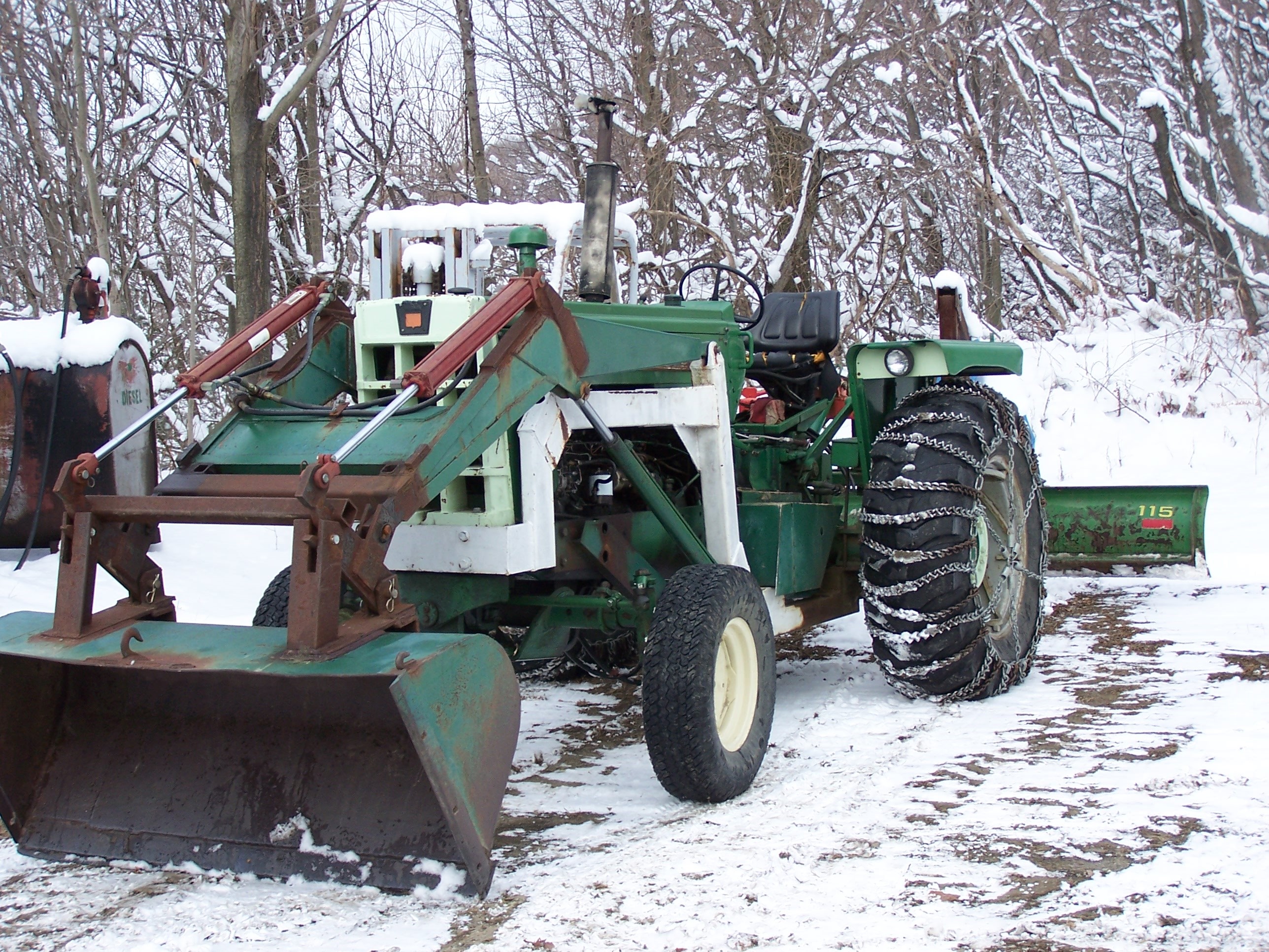

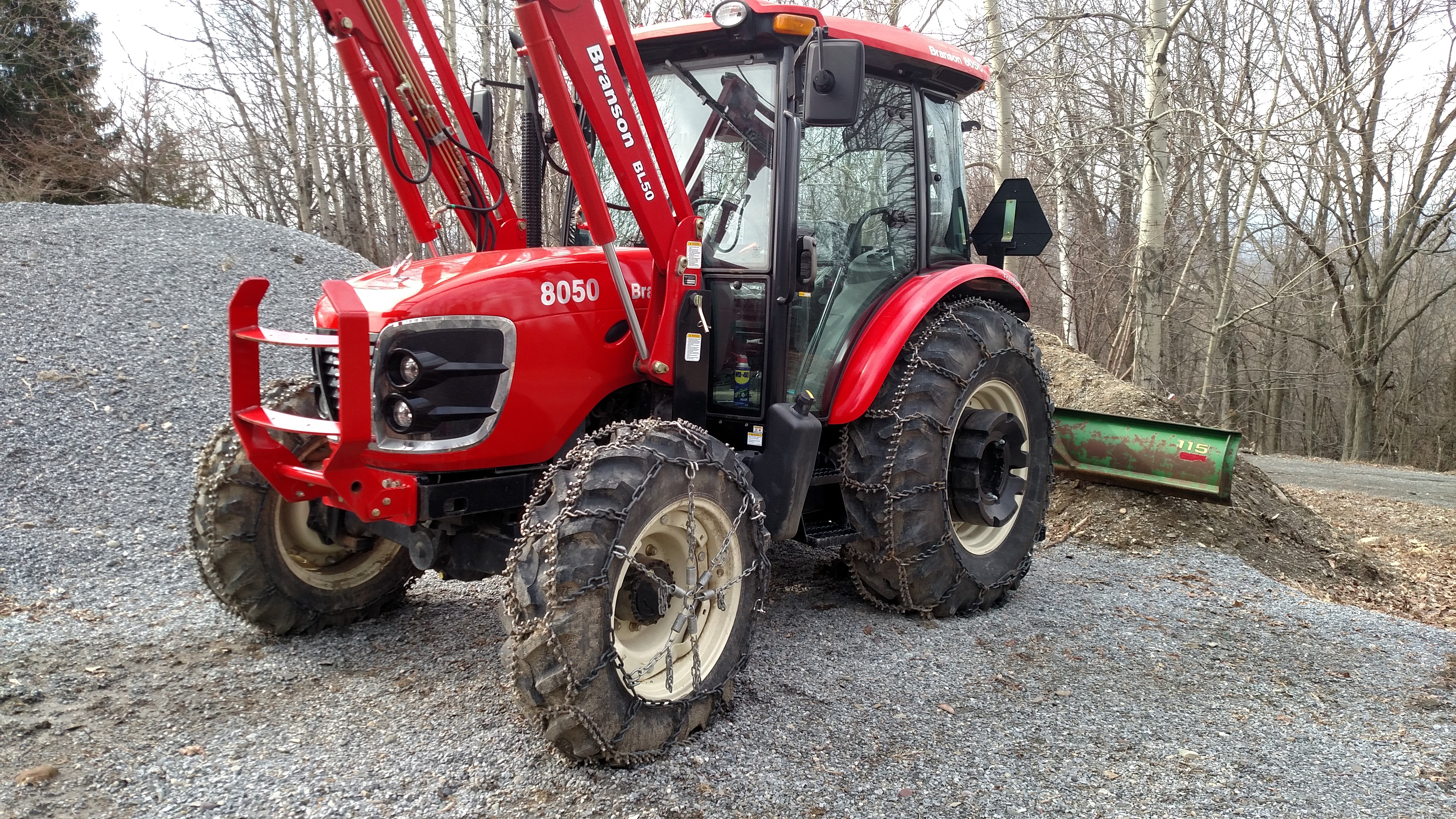

I will say that as far as I am concerned after using most all styles of chains over the years that the only ones I would recommend to anyone are the European style such as these.
The traction is the best the ride is the smoothest and they just work the best,
This is my opinion which I've have developed over the course of 50 years of mounting using and cussing tire chains.
There are numerous threads here on chains;
my :2cents: there is only one style I would consider after using just about every style made in the last 60 years.
These are conventional twist link and bar reinforced twist link on 2 link spacing, they work, kind of a rough ride on frozen or hard surfaces,
These are the best style I have found and used, excellent traction, smooth ride on pavement, the best;
View attachment 571124 View attachment 571125 View attachment 571126
These type chains are also easier on front axles as the traction is continuous not grab, slip, grab, slid they are also more money the ladder or the duo-grip type which to me have the roughest ride unless you are in mud or deep snow.
Double ring chains are good in super deep snow or mud, not for snow plowing the ride is very rough on frozen ground.

I ended up buying a set a of H pattern chains for the rear tires from tirechains.com and they fit great. I didn't get spacers and clearance isn't an issue. Only needed to plow 2 or 3 times so far and I have no complaints.
