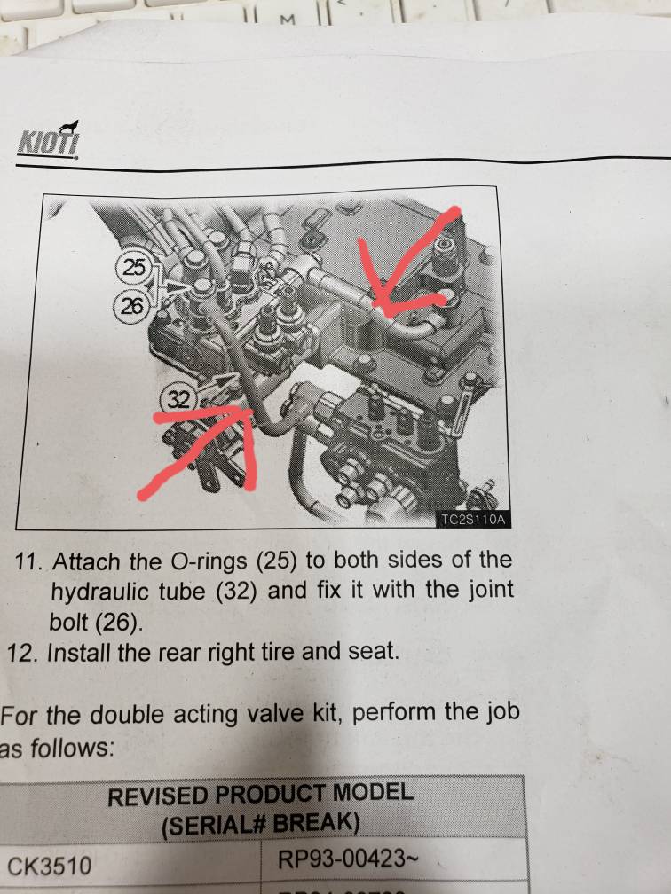

I had the dealer install a factory 3rd function valve when I purchased the tractor. I am trying to install a factory dual rear remote kit now and I can't figure out how they can be done together.
It shows connecting pipes to these two places but there is already a pipe in each spot for the 3rd function kit. I know you can install them both but how? 20200829_174953.jpg

After searching more online I found a video showing a 3rd function install on a tractor without a rear remote valve. I was able to pause it when he had the instructions open to a page about installing a 3rd function WITH a rear remote and it seems there are parts that I should have received with my tractor when I purchased it.
Apparently there are instructions for installing a 3rd function on a tractor with dual rear remotes, but no instructions for installing rear remotes on a tractor with 3rd function.
I guess its time to call the dealer. I'm glad I chose to start this project on a Saturday when they are closed and will have my tractor in pieces until I can get the correct parts.
Still if anyone has pictures or advice I would love to hear from you.

I went by the dealer today and he gave me the two extra hoses and the book so I'm going to try to finish it tonight. I'm still a little confused on how it works but maybe with the new book it will make sense.
