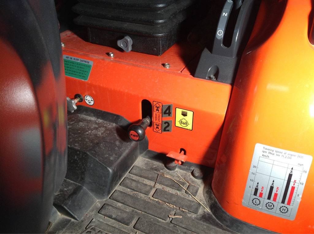

Ok, I am a tad confused. I have a 4wd lever on the floorboard below the seat. But which position is 4wd. The light doesn't come on in either position, I assume 4wd is up. There is not a single mention of that lever in the owners manual.

The service manual for my CK35 is also wrong about the front wheel drive lever. The icon next to the lever is correct but hard to read. Lift the front wheels off the ground with the loader, figure out which position of the lever is 4wd and 2wd, and place a mailbox number next to the lever in the appropriate place.
The 4wd light on the dash is not used on that model.
