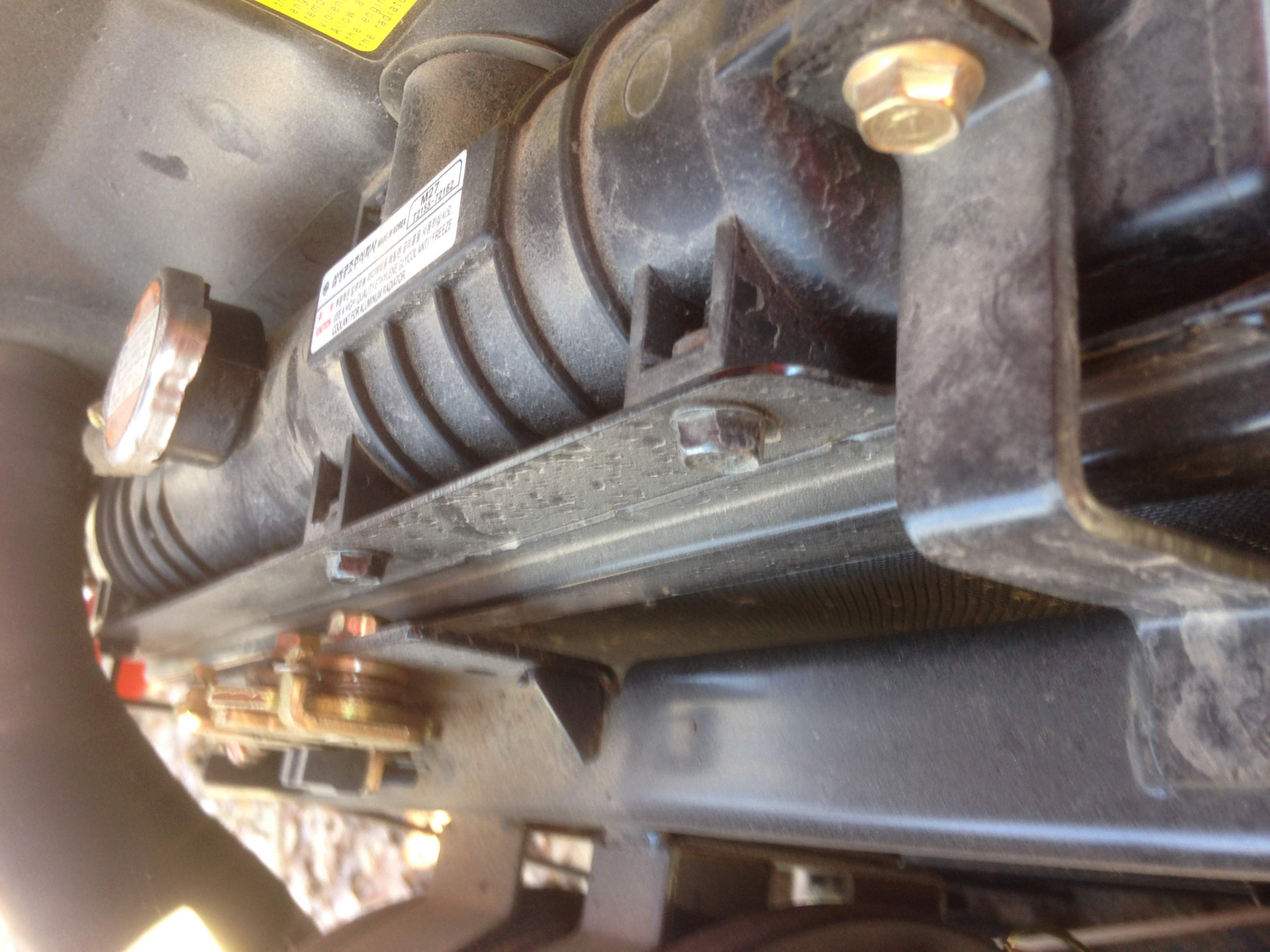

Just put in 3 hours bush hogging on the new 2013 ck35 hst. I love the hst stuff as everyone else seems to also.
But my question is, is it supposed to go slower in reverse?
And another question. I opened the hood and was happy to see a screen covering the radiator, and it was clogged pretty good with all of this dead winter seeds and pods or whatever that stuff is. It had a hand screw that you could remove, and I thought I was going to be able to pull the screen out and clean it off. But there's no was to get that screen out...why the screw. To clean that screen where it is and then get all the junk out is a pain.

Yes, they all go somewhat slower in reverse, not sure why, they just do. Your Rad screen should lift right out. Check to see if it's binding somewhere.

There is no way for it to come out. You would have to remove 5 screws (6 counting the thumb screw) to lift it out the top. And then I'm not sure that would work anyways. And for it to come out the left or right would not work...it's 2 inches taller than the opening. What year is yours?
I'm looking at Workshop manual that seems to say exactly what you are saying. But mine is definitely different.
See the gold bolt. There's 2 of them to come out. But you still can't get it up even if you do. And then see the 3 bolts on the next level, they need to come out. This is nothing like the manuel :-(

Remove the wing nut on the right side, then remove the right side engine cover just above the oil filter. It is held in with some rubber clips. Then slide the screen out the right side.

Thanks, that did it. I doubt I would have ever guessed that.
