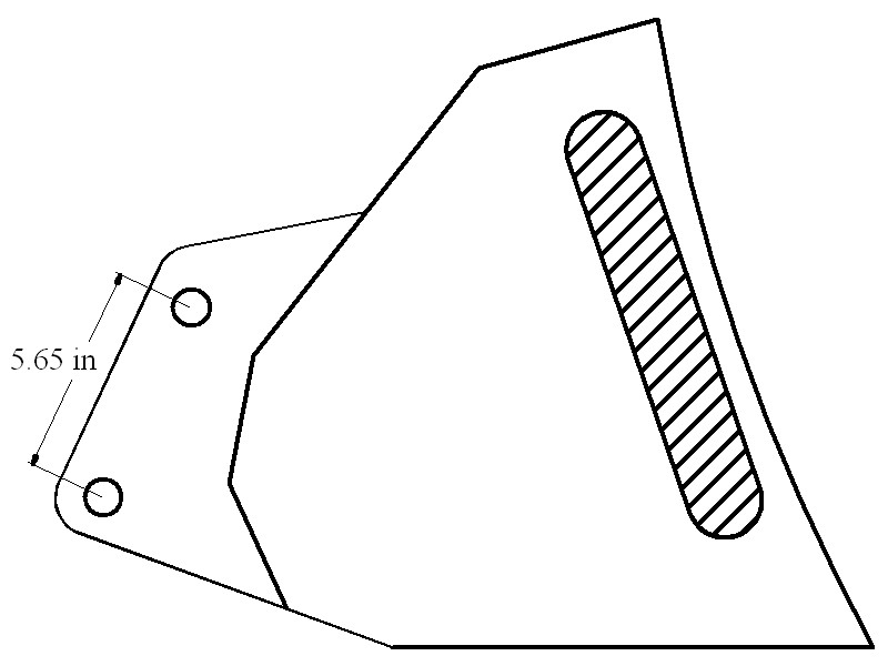

I recently purchased one of the anniversary CK35s with the KL130P loader.
The pin spacing at the bucket is 5.625" this seems close to me. There is lots of curl and dump but not a lot of breakout.
Here is a drawing of my bucket.
I would like to hear from others what pin spacing or bucket type others have.
Thanks,
Ray...

I have an early (with cracks) KL130. Spacing looks to be 5.5 so allowing for measurement error, it is either the same or a little less.
   / CK35 FEL pin spacing #3
I haven't looked at the new loaders for the CK class but as of a year ago they all had the same pin pattern and measurements. You could interchange pin mount implements between KL120 and KL130 loaders. I would guess that they are still that way.

Thanks guys I was hoping it was supposed to be larger.
Ray...
   / CK35 FEL pin spacing #5
Yeah, the pins are pretty close together.
When I built my fork frame, I went with about 12", but I also eliminated the
bucket links. My 4 in 1 bucket arrives this week and I will have to make
my own pin-on brackets. I think I will go for about 7", but also use the
links.
