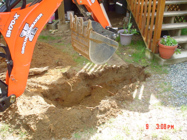

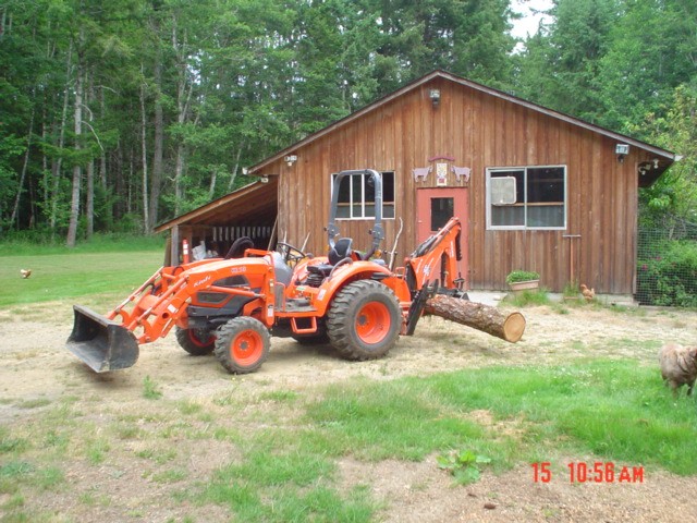

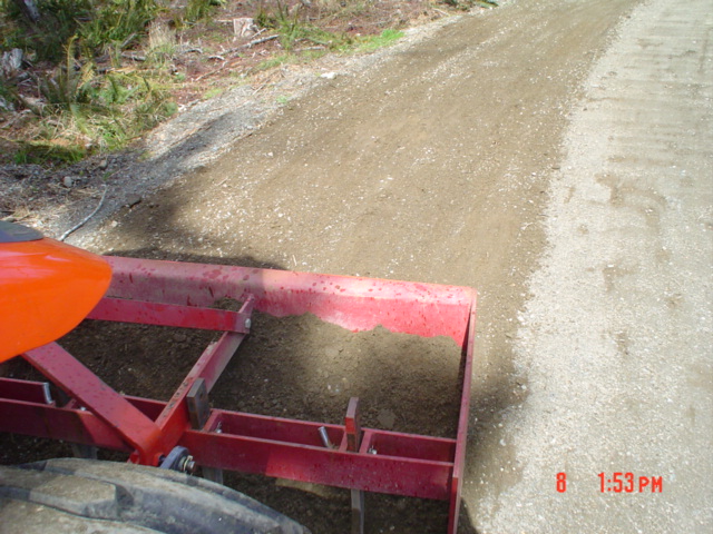

I have a 2008 CK35 HST, great tractor and has worked better than expected. :thumbsup: Got it with a Woods backhoe and 7 position thumb. Now have 209 hours on it and going strong. Think you just need to look at the work you need the tractor for and then get the one that meets your budget. :D

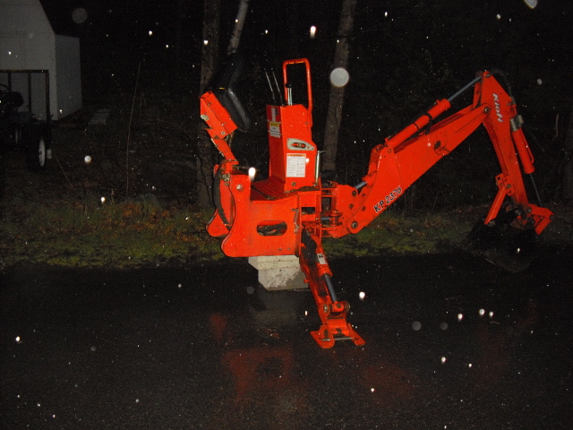

Look into how easy it is to put on/take off the backhoe and use a 3PH and rear PTO on the LK. Not sure it is best setup for that. It's more of at true TLB, with a tighter fitting backhoe, I think.
The CK backhoe setup will be different, and probably sets farther back off the rear of the tractor. The good part is that on the CKs you don't have to take off the 3PH to put on the backhoe. Most tractors require that you remove the arms before installing the backhoe. Don't know about the LK. If setup right, the CK backhoe will also give you rear remotes that can be used for other things, like log splitter, hydraulic top cylinder, forks. Again, not familiar enough with the LK to know how it's plumbed.
