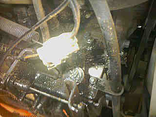

I'm usually good at lubricating stuff but this caught me off card after 5 yrs or so. Throttle stuck wide open, lever on dash wouldnt' change it.
Simple, first used WD40 type stuff, then spray grease on RF engine area where throttle cable end does its work. Several joints there, greased them all up, problem solved.
Photo shows general area.
Mike

Thanks for the heads up. I will keep an eye on mine. I pressure clean it a lot and give a light lube occasionally and no problems yet.
