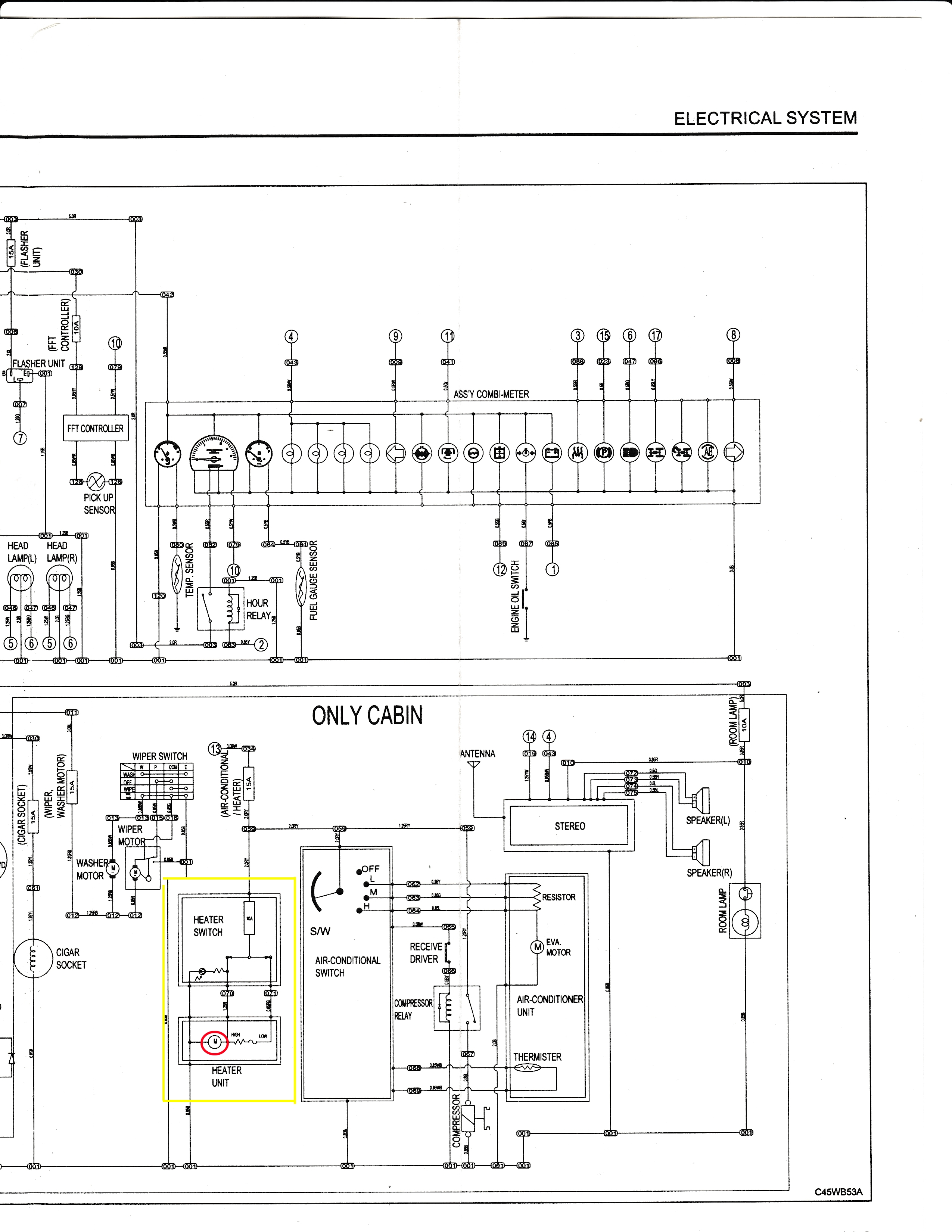

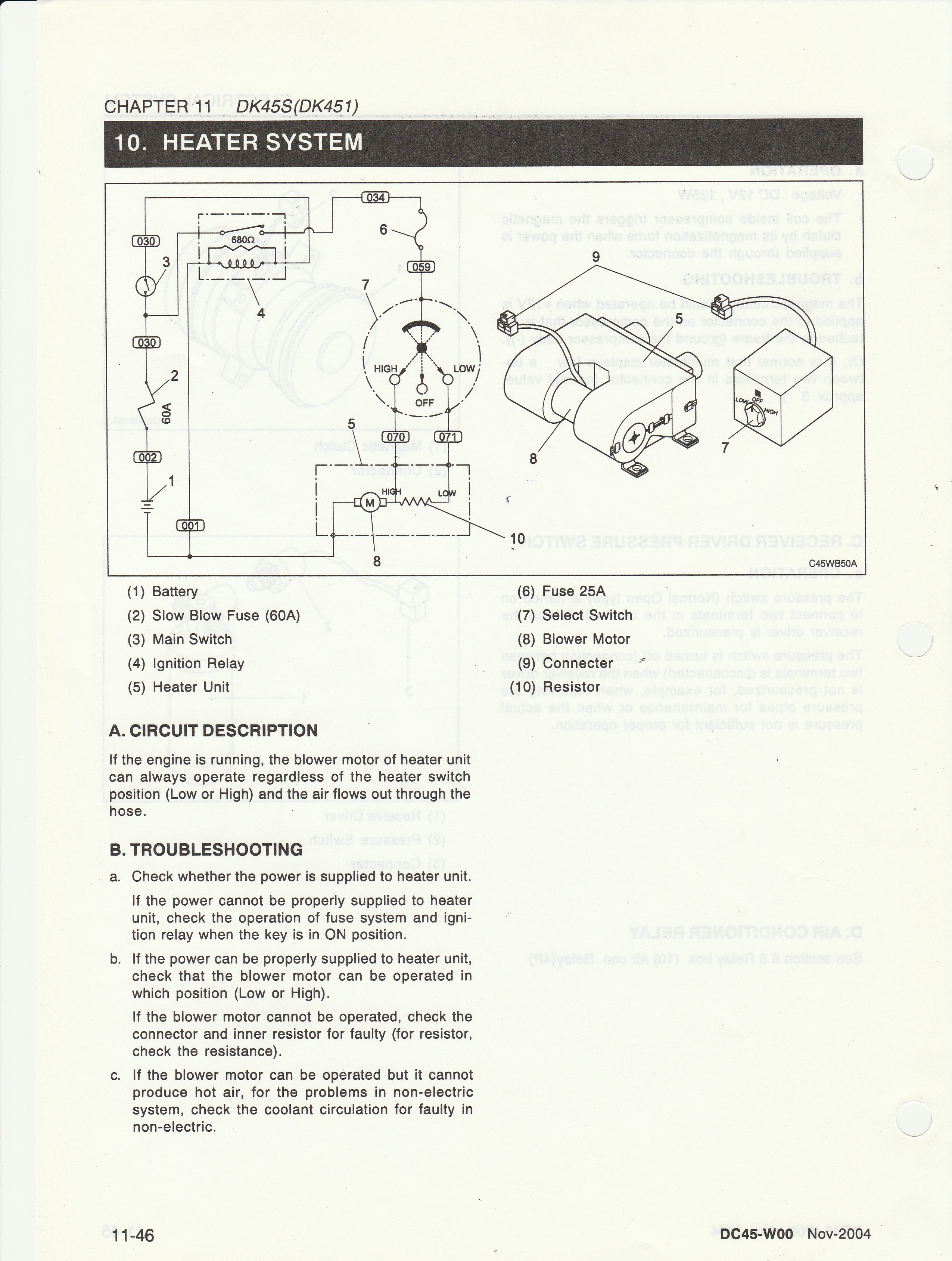

I have attached the schematic for my DK45 (about a 2008 model). I have no idea if it is similar to your CK30. The heater switch and motor are highlighted.
At least for this particular model, there are no relays involved. It does indicate three connections to the motor (2 wires from the switch, and the 3rd is ground). There is a resistor, which is used to reduce the blower speed. If there was anything wrong with the resistor, it would affect the low speed; not the high speed. The motor only has one winding, and since it runs (normally???) on low speed, that indicates (to me) that the fuse, power wiring, motor, and ground are all good.
If we assume the switch is good, that seems to leave only the wiring which runs from the high speed terminal of the switch, to the fan motor. On my schematic, it is just one wire; no connections/splices except at the switch and motor (or resistor). This will be a very short "run", just the distance from the switch to the motor.
This seems like a very straight forward problem that anyone with a Volt Meter / test light should be able to trace out in just a few minutes.
The fact that it stumped a dealer's shop would indicate that it is much more complicated than my schematic would indicate.
Good Luck!
PS I found a "detailed" description of my (DK45) heater only system, so I have added that page as an attachment.
