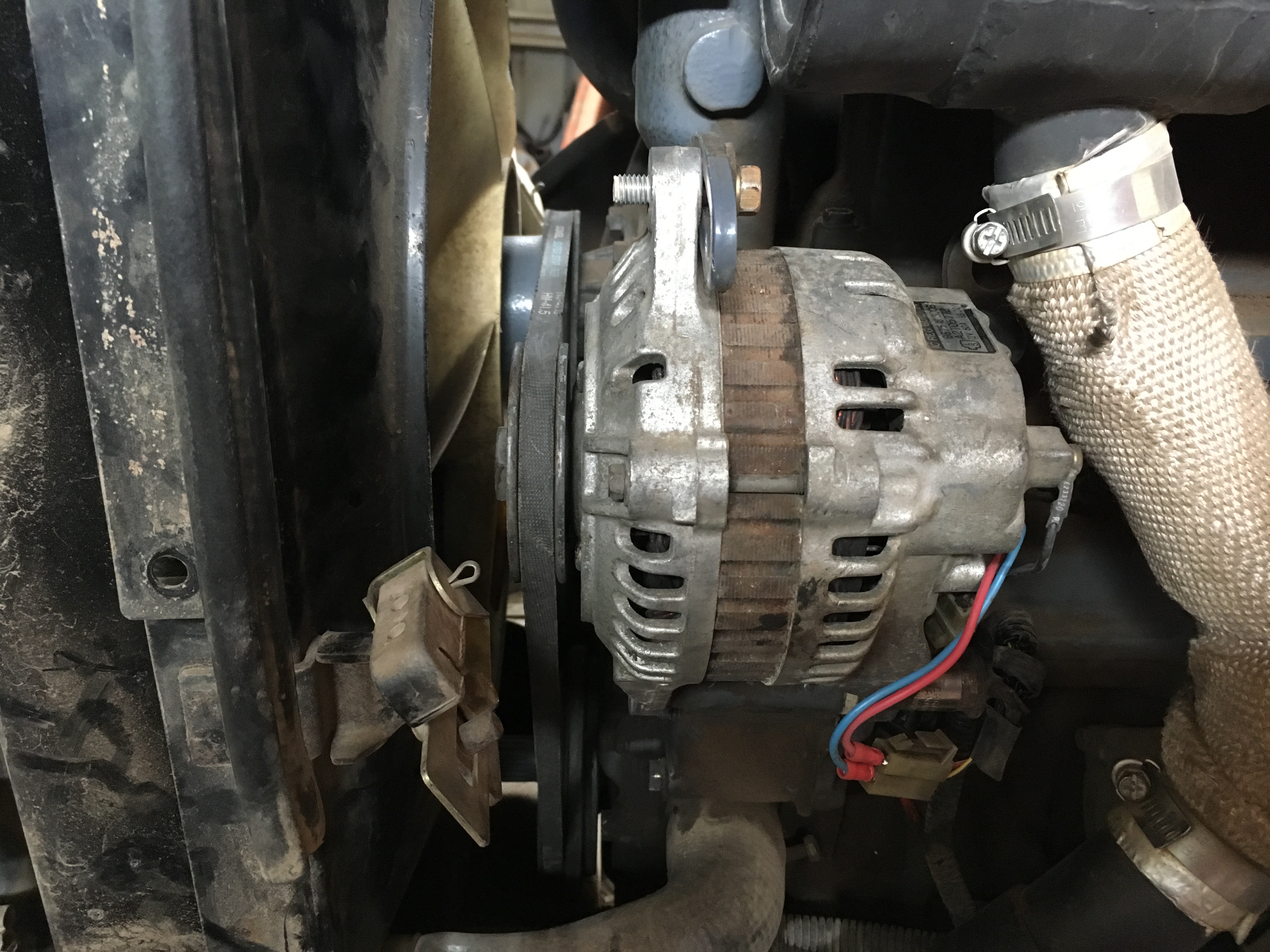

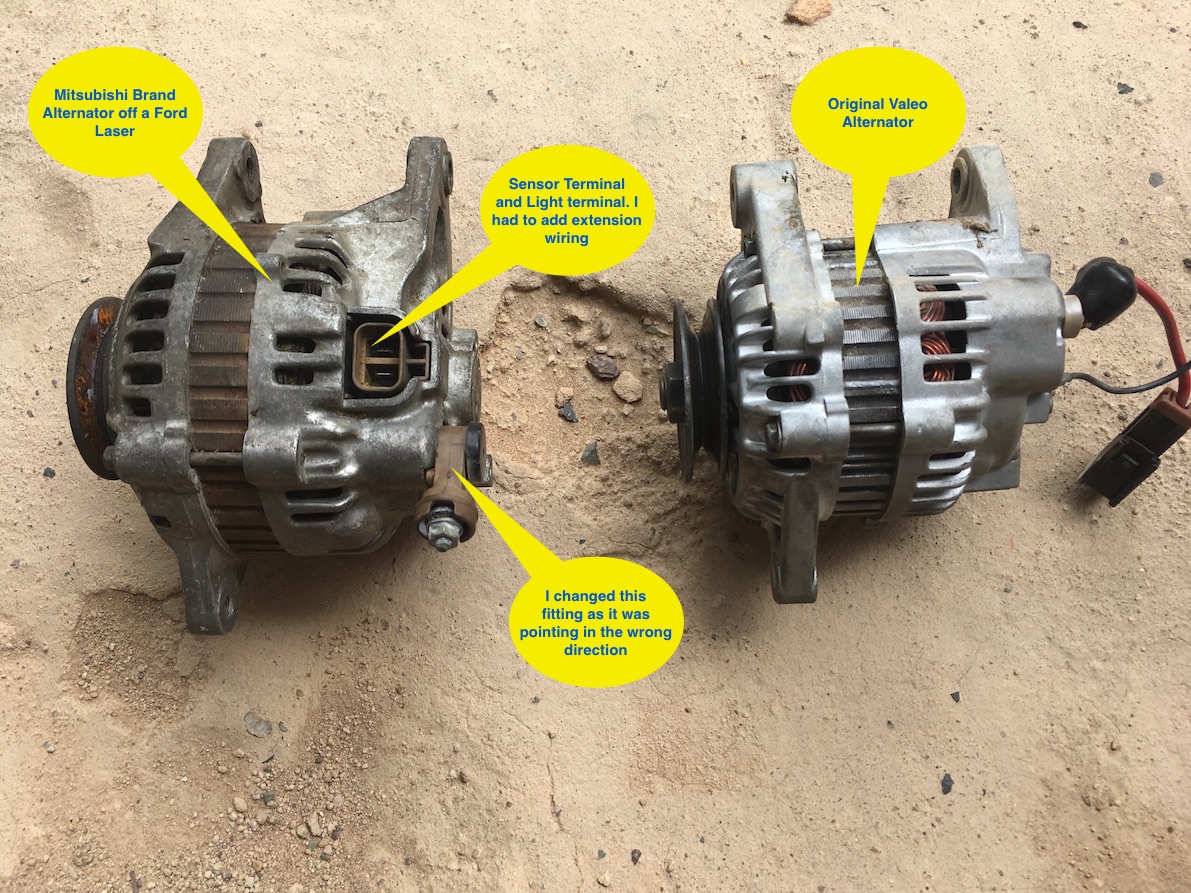

Back again and the operative word is BACK. I have been out of commission so only just managed to get back to my Kioti today.
Yesterday I called in to see my neighbour who has a number of wrecked cars lying around. 2 of those happened to be 1980 series Ford Lasers
One had the alternator removed so I did a comparison and it looked promising. Slightly larger diameter but the brackets were pretty much the same.
It was also a 60 Amp rather than a 50 Amp like the original.
Neighbour told me it came off his car and it had been working OK and I couldn't argue as he gave it to me for nothing.
I had to extend the Sensor and Warning Light wires and fit the earth wire from the original. The Main Battery wire I had to remove the silly big connector and fit a normal insulated washer and nut.
The only other mod was the bottom main bolt goes in from the rear instead of the front and had to be shortened 1" The Ford had a thread in the front bracket where there was none in the original. Much better as you don't have to loosen the radiator stays to get the alternator on and off now.
Incidentally it is a Mitsubishi brand Alternator. It also has an internal regulator.
The pulley was also the correct size but I could have used a slightly longer fan belt. It would have been easier to put on.
I found the reason for the goo in the old one. Not easy to see, but the Oil Cooler in front of the radiator has been seeping at the top pipe on the RHS. The fan has been dragging the oil back through the radiator and into the alternator. As I said, It is hard to see unless you have good light and have your glasses on. :)

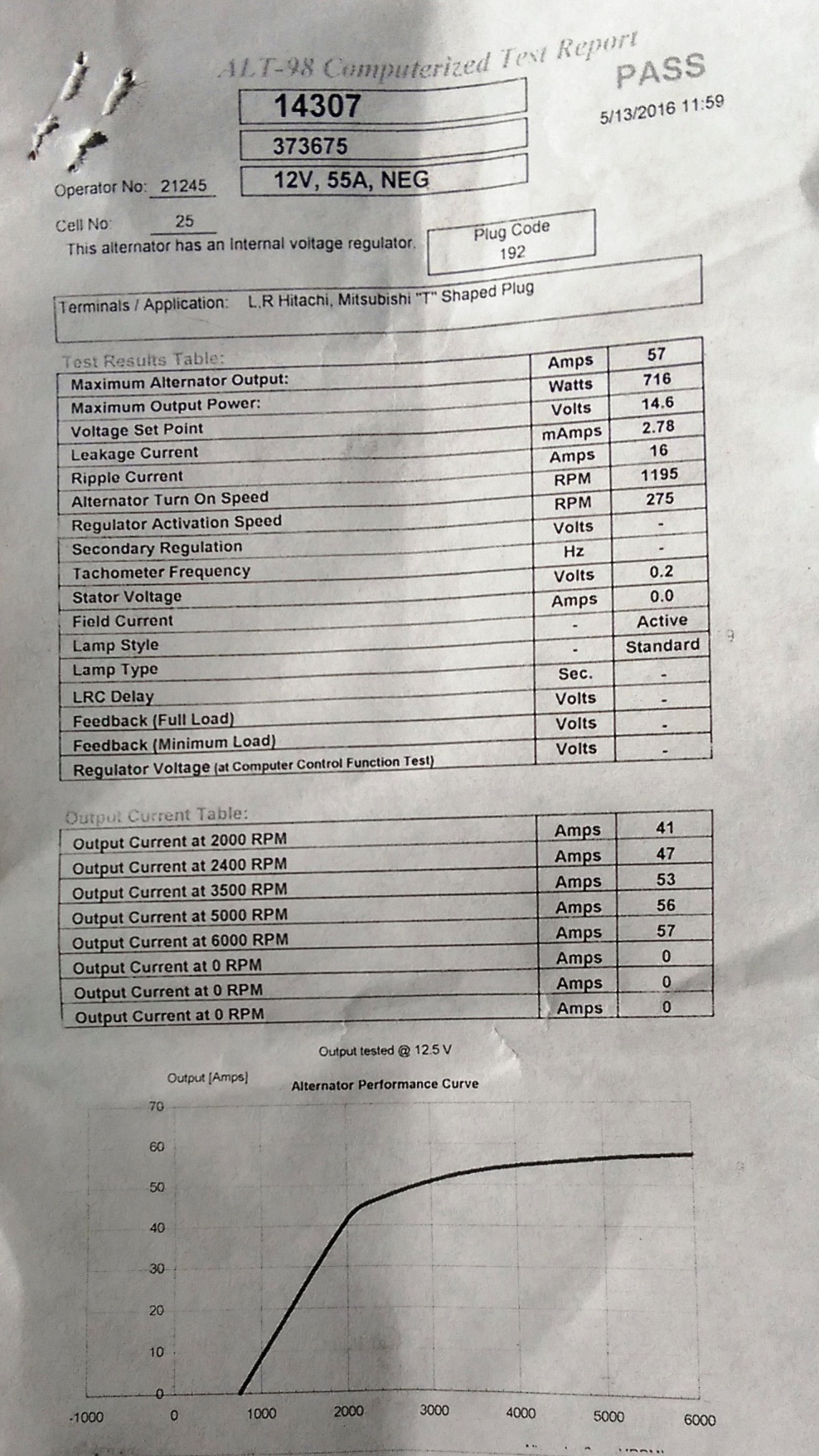

Anyway, all working well. It's charging at 13.8 volts.

I should point out that the original Valeo alternator had double raced bearings at each end. It was a well made alternator but just far too expensive.
I can't see a problem with having normal bearings as it has a normal V belt and no more load than a normal car motor.
This alternator was obviously made in the same factory as a lot of casting and design was virtually identical.
Just to ease some minds. I do have to wrap insulation around the extended wiring to protect it. :)

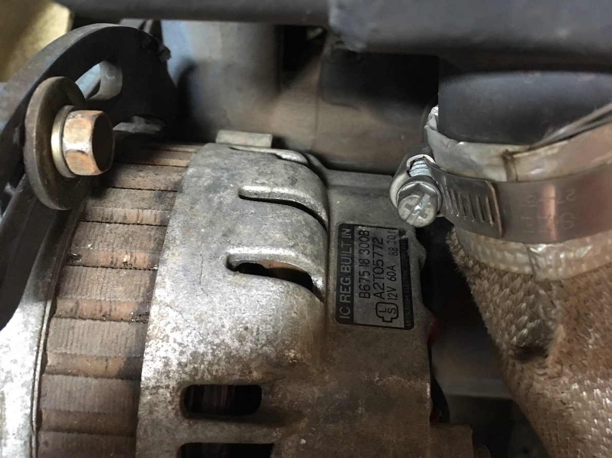

I couldn't find the post but a year or so earlier, a member posted about using an alternator from a mitsubushi vehicle. He actually found a part number somehow and bought a new one at a auto parts store. He just had to make a few changes like you and it worked fine.alternator info.jpg

I have a couple of Ford Falcon alternators that could be made to fit at a pinch. They at least have external regulators. No need at this point.:)
