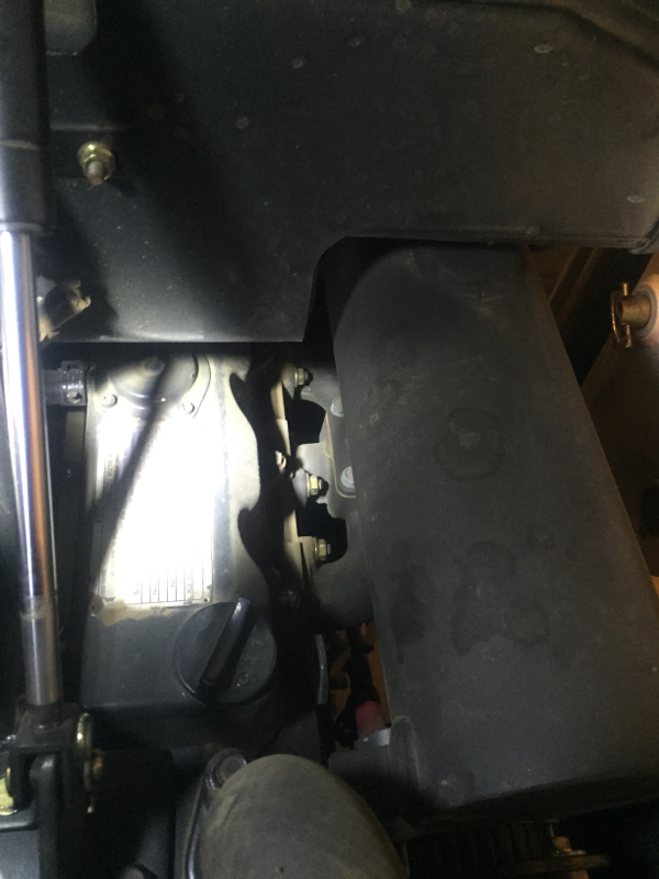

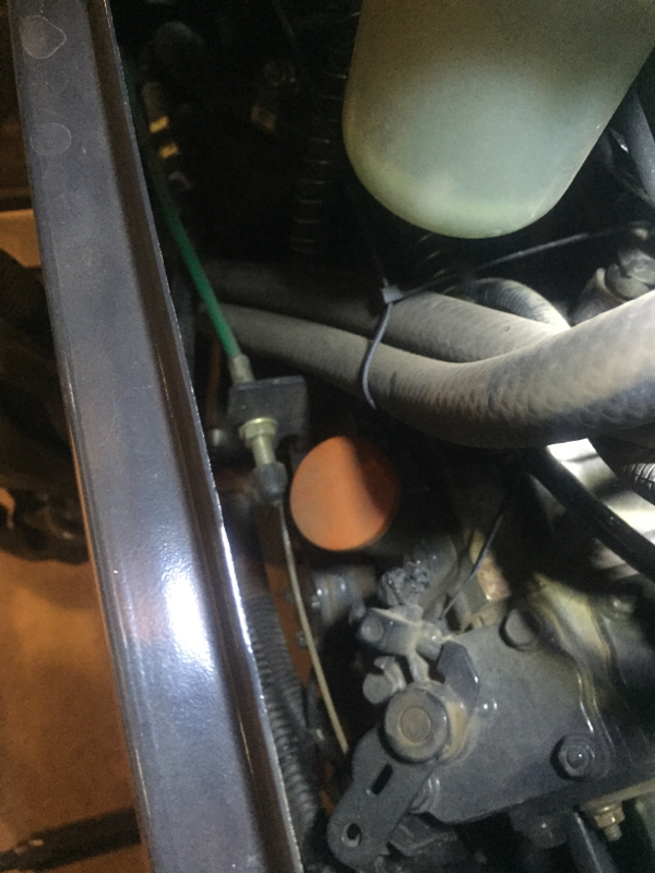

Our tractors are not identical but they share a lot of the same parts I have to plugs on the top of my valve cover one is removable one is not. The removable one says oil on it and has a T handle. However I have a second port closer to the dipstick that is what is recommended for filling oil on my tractor. It is just a rubber plug not a twist off and has no markings on it other than being orange I will attach a picture of each.

Since Kioti added the second orange fill plug, that is the recommended place to fill. I just have the top valve cover place on my 2004 CK30hst and just fill slowly.
