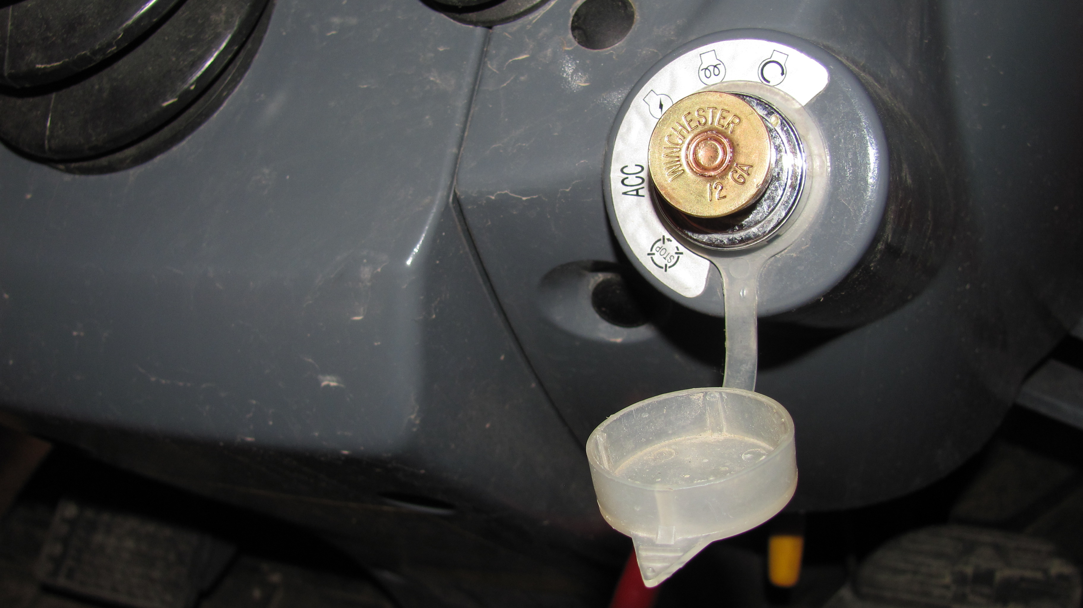

I have found that when I turn to the left to look at the rear of my CK 30 my right knee tends to hit the key just in the right spot to shut it down. I have a rocker HST foot pedal so I have the seat up a bit to be comfortable on the pedal....short legs:). I am thinking of putting a shield on the right side of the key or even cutting the key down to make it less of a target. Anyone else tackle this minor issue?

I broke one of the original keys on my CK35 after about the third time I hit it with my knee and then straightened it up. :(
The location of the key is really my only complaint about the tractor - it's a simple design issue that could have been done better.
I used the spare key to get a copy cut and then ground down the copy so as to leave only a small (half inch) "lever" to turn the key. I place the key in the lock so that this lever is vertical.
It seems to be working because I haven't hit it hard enough yet to bend it - or gouge a hole in my knee.:laughing:
My father is about a half a foot taller than me & he has done this as well (haven't broken the key yet)
I like your solution & it reminded me that Dad had a motorcycle that the hard side saddle bags required you to put the key in to open every time. This can sometimes be a major PITA so he had 2 keys made, cut the heads down and used knurled knobs (the kind designed to be held on w/ a set screw) and cut a slot in them for the key shaft to fit in & tightened the set screw.
He then just put one in each lock and left it there. I may have to do this w/ a tractor key.
   / CK30 Auto Shut Off
I like the idea of adding a knob type thingamajig to it, less likely to turn it off. I am going to get a couple copies made rather than use my originals and find/make a dome shaped knob and epoxy that to the key so my knee will just glance off rather than turn or dig in.
