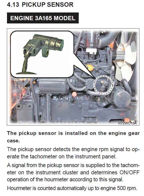

On the throttle lever, one should set the minimum RPM and the other sets the maximum RPM. There is probably another one that adjusts the stop lever. The piece of wire is a seal so they know if it's been tampered.
For the tachometer, there is a pick up sensor on the side of the injection pump. Since that's easily accessible, it might be worth taking a look at the wires and plug to see if those are in good condition.
Another possible issue, could be the plug behind the dashboard.

Wires all look good on the sensor. Is the sensor itself something I can remove/clean easily? Or is it not as easy as battery disconnect, pull bolt on sensor and slide it out?
I had a crankshaft position sensor on a car that needed to be removed and cleaned on rare occasion to keep it happy.

Obviously, if you have a tach problem, it’s explained. I did want to add another data point though.
My CK2610 has done this twice. Wouldn’t go to above 1800 RPM, and it would bog down under load. I took a WAG and for once was rewarded by replacing the air filter. It fixed the problem. Second time it occurred, I cleaned the air filter, observing the manuals statement to not exceed 30 PSI using compressed air. Again, it fixed it.
Doesn’t make sense to me, as the air filters were under the recommended hours, and did not seem that dirty. Anyway, even I can’t argue with success, so thought I’d mention it. For what it worth, Toukow
