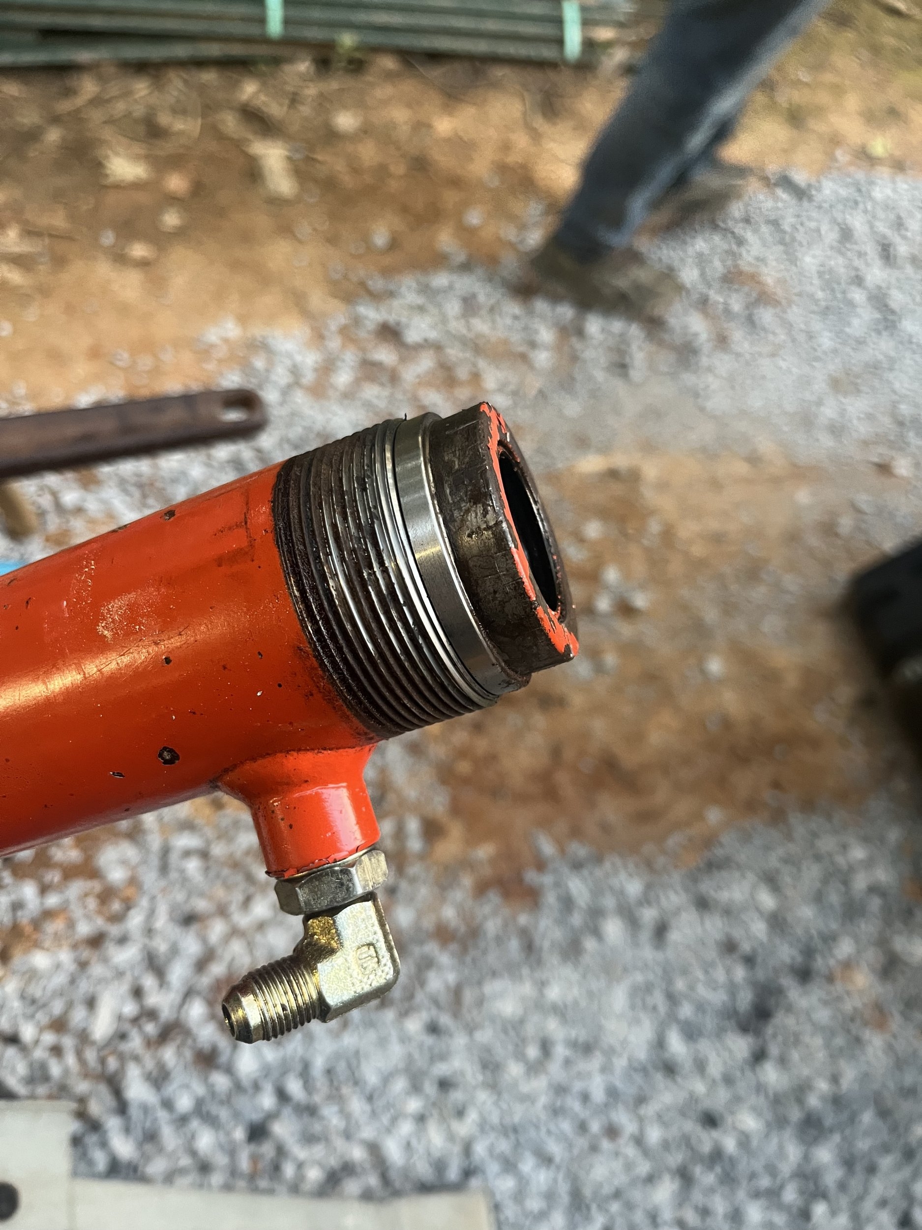

Today I was able to do a simple test. Extended tilt cylinders fully, unscrewed rod end lines and applied dump pressure with tractor running. About a ten foot high jet of oil came from left cylinder (while sitting on tractor). Needless to say, I found the issue!
When Kioti list parts, is LH and RH designated as if you were sitting on tractor or standing in front of the tractor? Kind of important distinction. The rods are listed differently and cost differently for whatever reason.
Once I pulled the cylinder off, the rod just fell out of the cylinder.
Now I'm faced with what to do from here. I'm sure I can get the cap off and pull the guts so to speak out without damaging the tube.
I looked online and found a replacement rod and piston. Around $230 total (Not sure if I can say where from on here).
What challenges am I looking to get myself into? This is a first for me. Bleeding the lines and filling cylinder, I would assume needs to be done.

Take the rest of the cylinder apart so you can pull the piston and the broken thread section of the rod with the nut attached. Inspect to see if it's still in good shape, if yes, then all you need is a new rod. Save the nut from the broken on and you're good to go.
Also and more important, take a good look inside the barrel for any scratches or dents. If there is any, you'll need a new barrel. With the broken parts just floating in side the barrel, it can create some damage.
You may want to change the seals since you're at it.

To pull the rod end cap, I don't have a tool to fit into the hole provided. Suggestion to make sure I don't damage barrel?

A big pipe wrench will pull the cap out, although it will leave some marks on it. Those things are usually fairly tight. I usually use a chain wrench most of the times.

I can't seem to get this little gem out. I'm worried I'll damage the barrel, in the process.
Any suggestions?
The cap was kind of a pain, 4' breaking bar and pipe wrench did the trick.

Use the pipe wrench again but only on the dark spot as it's not too bad if it damages it. It's probably just stuck with rust I would imagine.
Put the barrel on the tractor with the shaft to hold it in place if needed.
Any suggestions?
I've spun this thing, it's tight. I've tapped it while spinning it with no luck.
I'm not seeing a locking ring in the breakdown schematic for this cylinder.
I have it hooked to the front end loader to hold in place. Still no luck getting it to slide out. Can't even get enough wiggle room to use a small pry to help it along.
Any suggestions, this think is kicking my butt.
   / CK2610 Tilt Cylinder repair #10
A good slide hammer probably would do the job. It should just drive in and the cap holds it in place.
