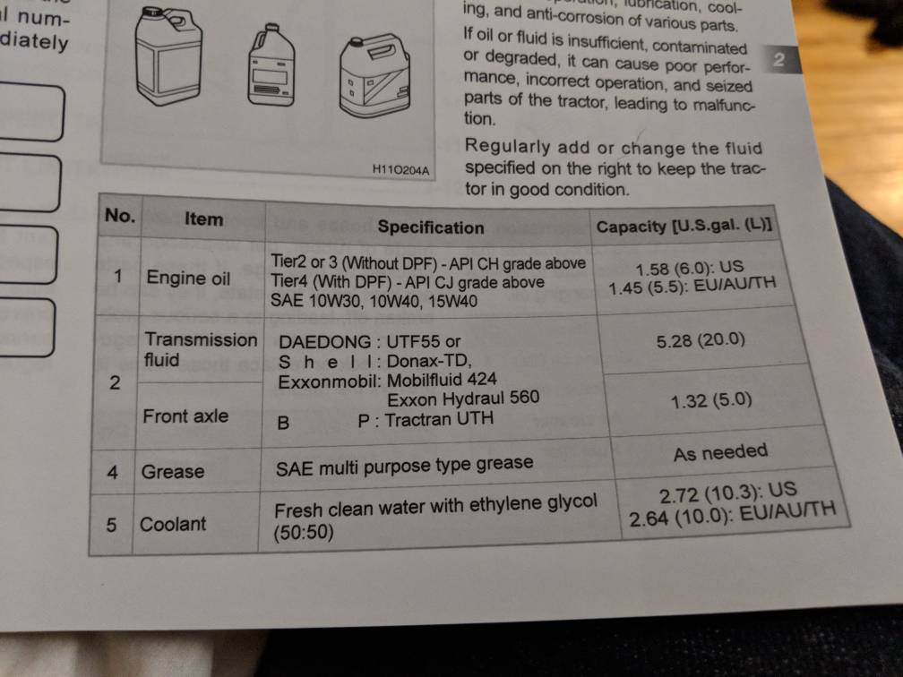

So I'm a little confused on the maintenance. The dealer is telling me different than the book.
I am at about 160 hours last services was 50 hours.
When do I need to change the engine oil? Transmission oil, etc.
What does "Check" vs "Replace" mean?
Thanks for your advice

Its says change engine oil and filter every 250 hours , check means look at replace means change:)

That's what I thought too but the dealer said change the oil at 150h. Basically 100h after the initial oil change at 50

Some change the oil every year if the don't put on the hours I go every 200 hours on engine oil and filter , and I keep them inside the barn out of the weather

Second question when I do change the oil. The manual tells me 3 different grades of oil. Which one do I use?
   / CK2610 Maintenance #8
I would split the difference and go for the middle one.
I would use what I've been using for years. Rotella T-6 5w-40
   / CK2610 Maintenance #9
You can use Mobil delvac 15/40 or Shell Rotella T6 Full Synthetic Heavy Duty Engine Oil ,It depends on how much money you want to spend and how cold it gets up there If you use it to plow snow synthetic will flow better in the cold easy starting
The winters get cold, -10 to -30C. This year we have a pile of snow so I'll take your advise and go synthetic. It is not synthetic now is there any issues switching?
