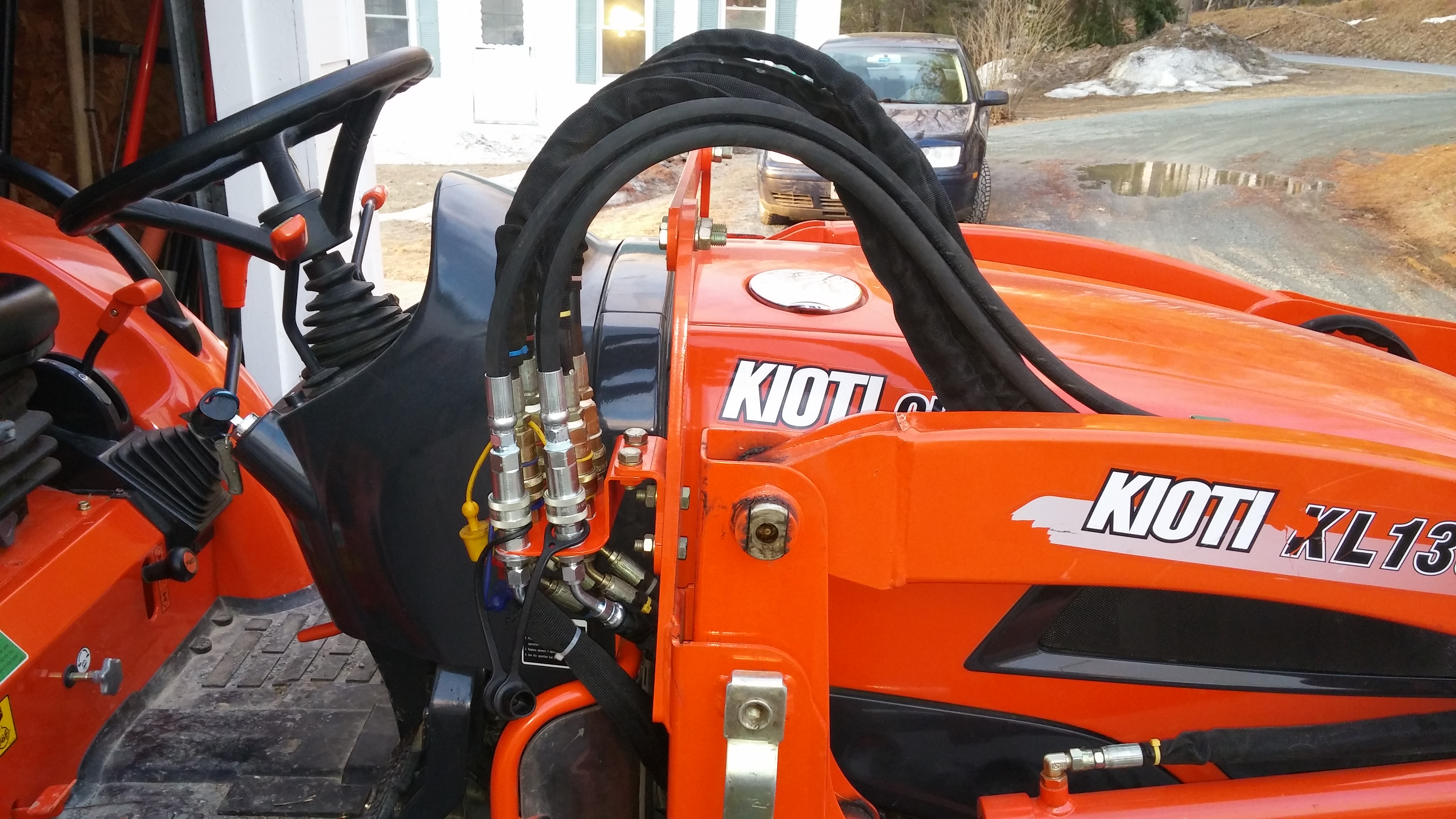

I purchased a CK2610 TLB last June. I just noticed today that the hydraulic couplings for the loader are reversed. The female end is on the loader and the male end is on the tractor. I don't guess it's a big deal but I was going to check my hydraulic pressure and my gauge has a male end. Anyone else with a CK10 series with the couplers reversed?
   / CK2610 Loader #2
Not reversed they are all that way CK2610 Demo Part 1 - YouTube
Makes it so they wont fill up with water if it is left outside disconnected.
even my older ck35 is the same
   / CK2610 Loader

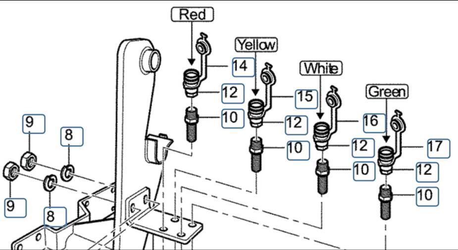

I see! Makes perfect sense. The parts diagram doesn't show it this way though. Like I said... Not a big deal. I was just wondering why it was done that way. Thanks for the explanation!20180415_085713.jpg
