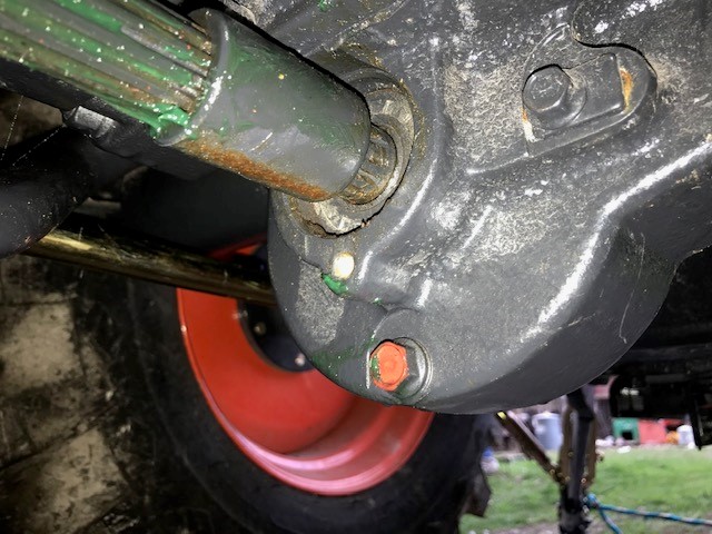

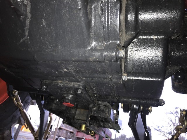

I'm changing out the hydraulic fluid early. I had an o-ring break and I lost some fluid. Found a good deal on Mobil 424 and want to just use that going forward. I've looked in the user manual, but the picture doesn't really match up with the tractor. They seem to show that there is one drain and it is on the side of the transmission case - next to one of the filters. I can't locate that. I do see a large bolt directly underneath the case and another slightly to the front. Both of these are painted orange, just like the engine drain bolts, so I suspect that they are the drains for the hydraulic fluid. Anyone have any advice on this? Pictures attached.

The Transmission Drains are the orange painted drain plugs on the bottom of the transmission. The larger plug will have the magnet on top of it when it's removed. Clean the magnet before re-installing in the tractor.

Thanks! I changed everything out this weekend. Was a lot easier than I thought, although one of the filters was a bit tough to remove. It is really great to get this help online, especially since I noticed one or two slight discrepancies in the Owner's Manual.
