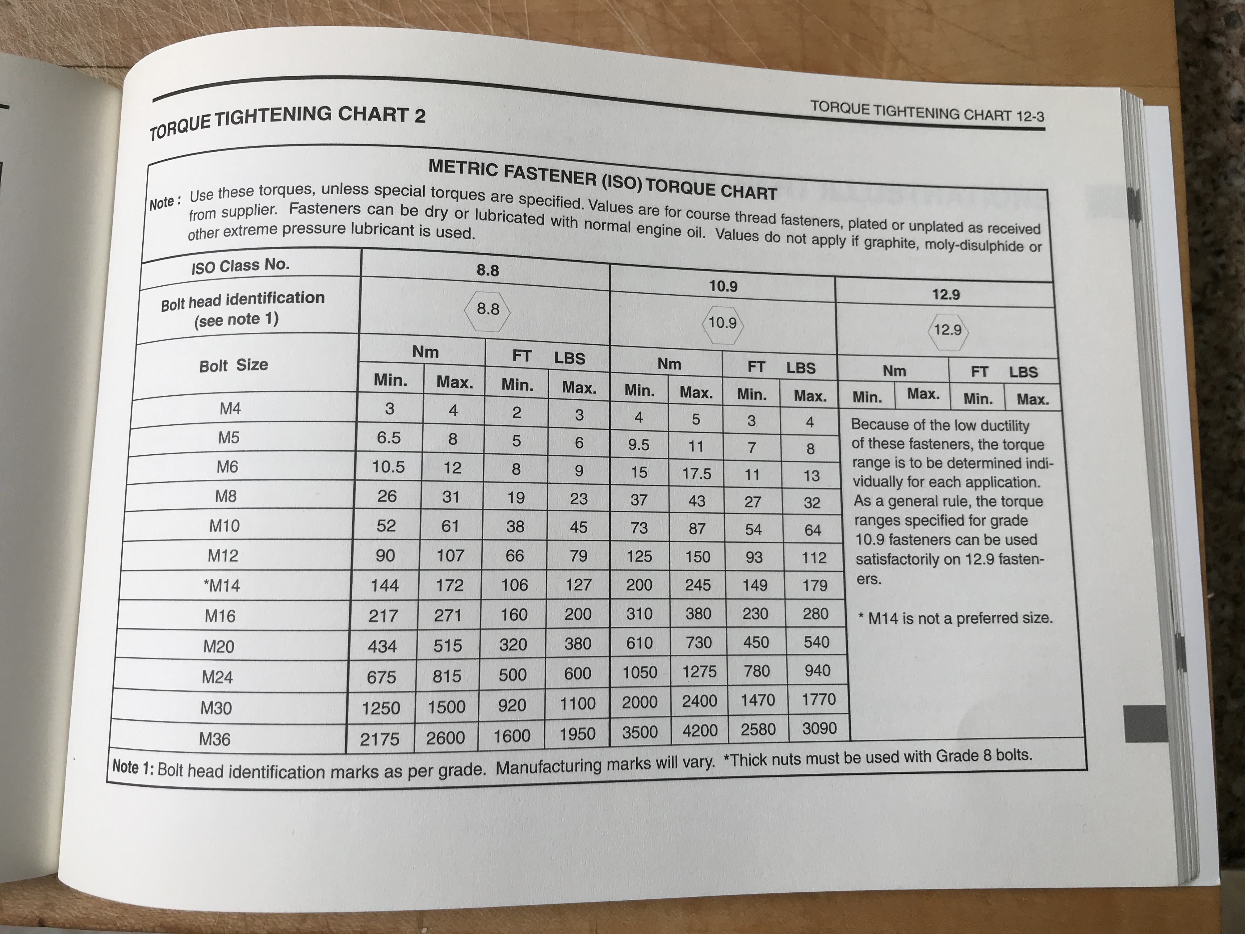

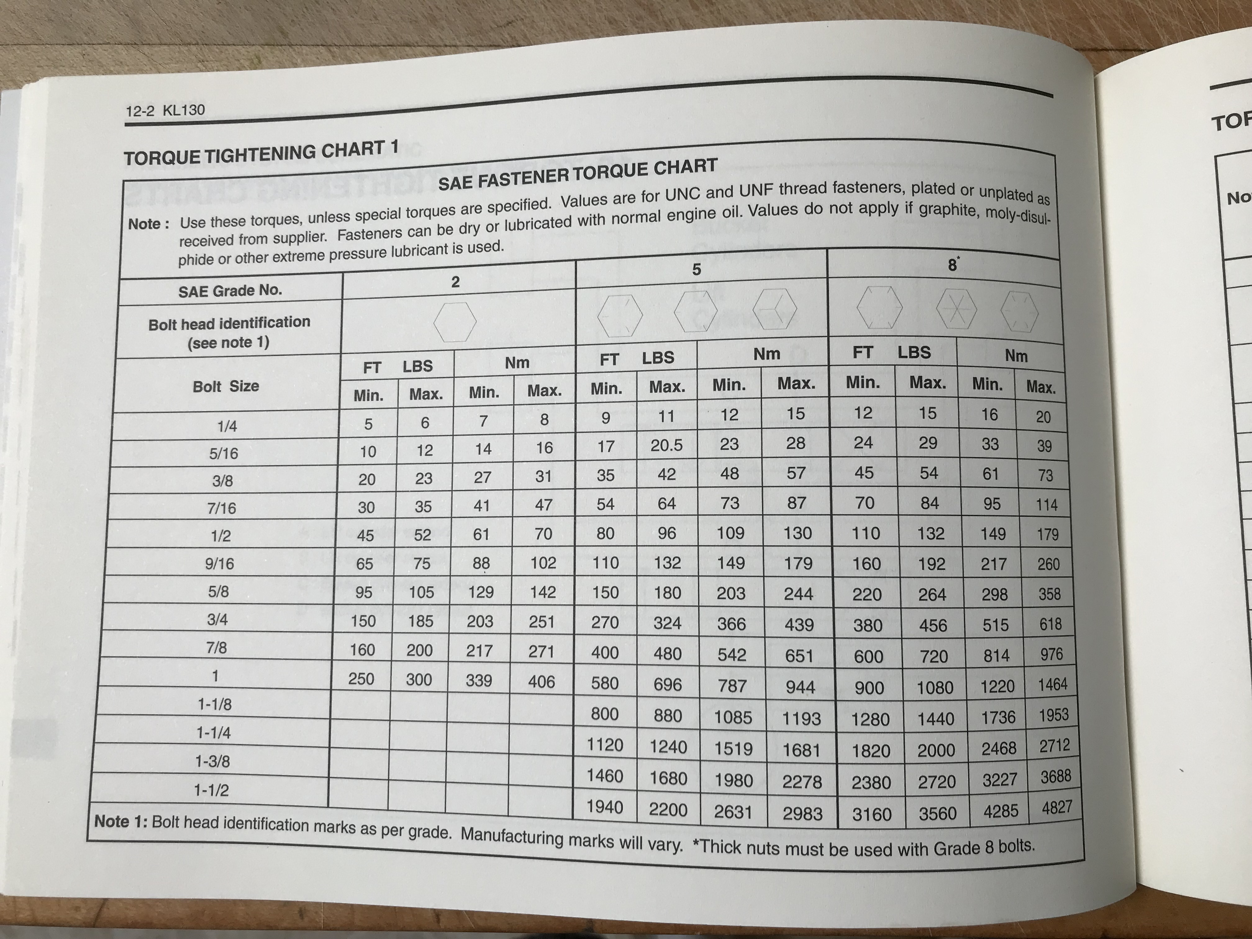

Can any of you guys tell me what torque Ft/lbs you are using on the loader mounting bolts? I know they are a 10.9 grade bolt. I've been using 125ft/lbs but I'm sure it should be more? Thanks in Advance.
   / Ck2610 FEL Bolt torque #2
Here are a couple of pages out of my KL130 loader owners manual.
