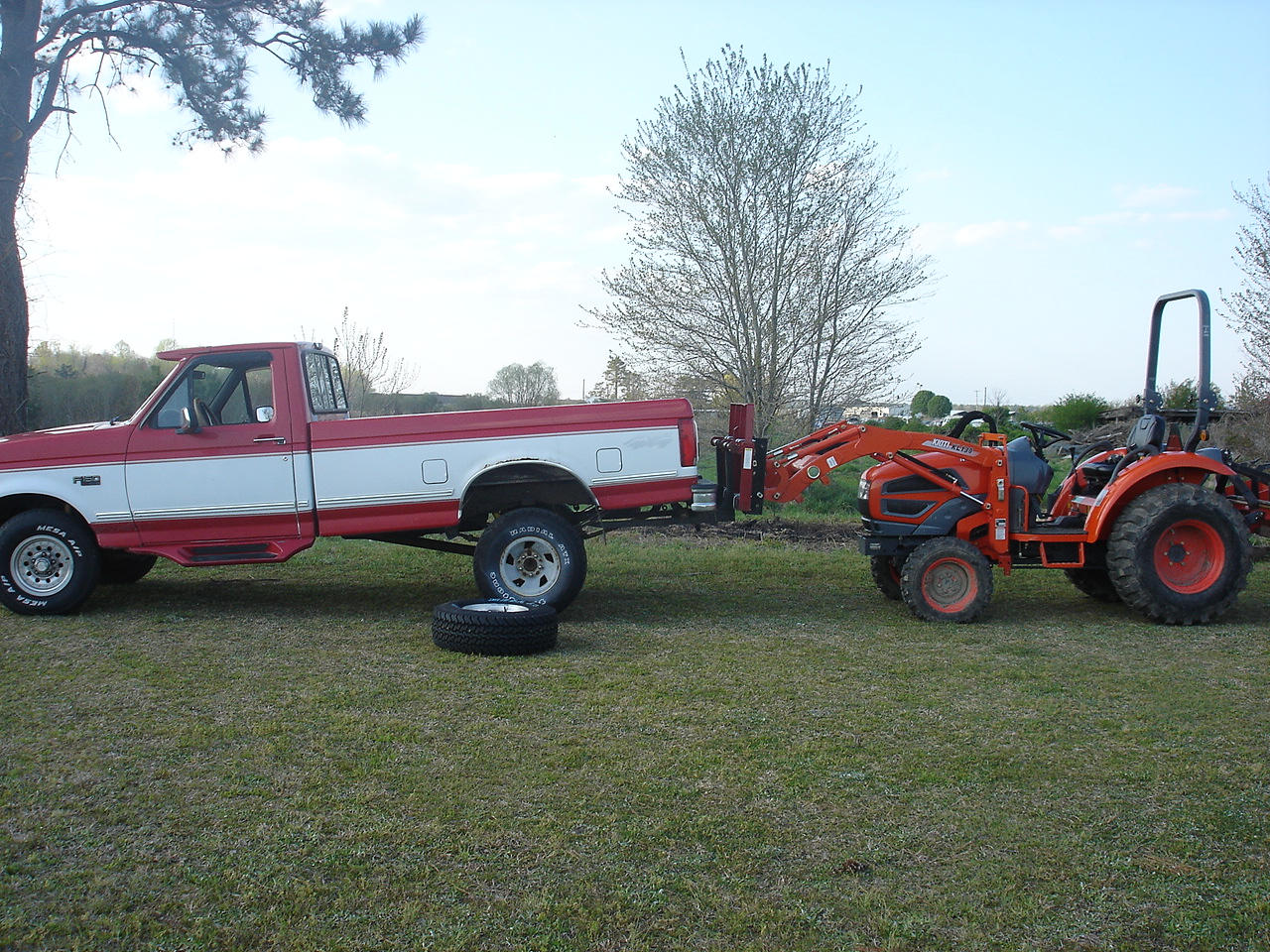

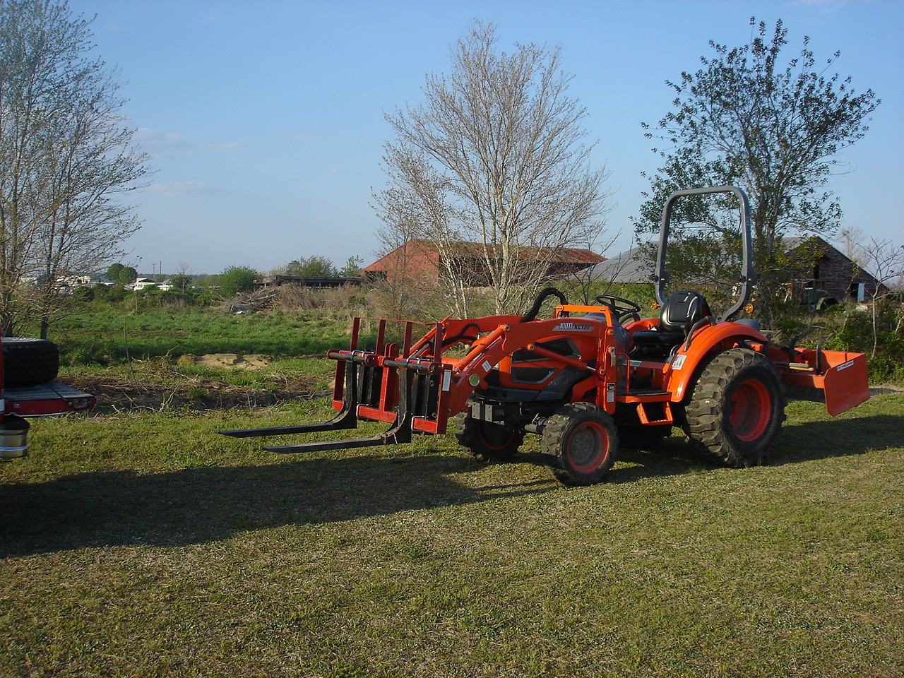

I went ahead and put my new tire back on my truck. The 1st pic is tractor lifting the back of the truck with the spare still on then 1 of truck with new tire and ck 25 with howse forks. FYI howse forks weight roughly 350 lbs so I would say a CK25 still has some lifting ability.
