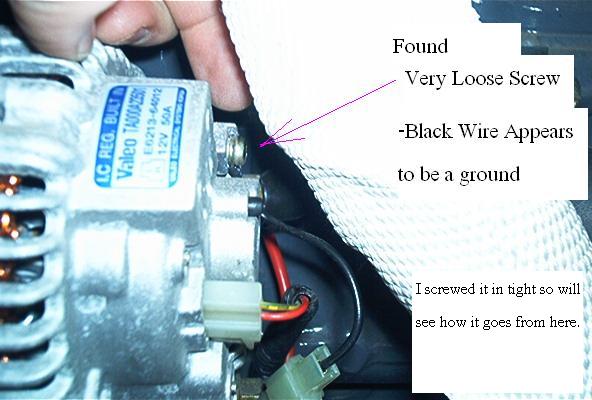

Back to the hour meter the dealer said to check the connections, so I take a closer look at the firewall tonight and see what I can find. He had run into another one that had the same problem. Hopefully I'm crossing my fingers it is a quick fix.

Not sure if this solves the debate, but in trying to fix the hour meter on my tractor, the dealer has provided me notes from Kioti. The hour meter is run off of an FFT solenoid that is on the firewall behind the engine block (CK25). From what the notes indicate the alternator sends a volt to the FFT Solenoid then it converts it to pulses. In doing so after 3,600 pulses the hour meter then counts 1 hour. That's how I'm understanding how it is suppose to work, from what I'm told.

Thanks Kioti John for the offer, but I do have a new copy.
Oh man I'm crossing my fingers I found the problem last night to the hour meter. I found a loose ground connection on the back of the alternator,, I have since tightened it up. Anyways before I tightened the screw up the Solenoid that goes to the hour meter was not consistent when checking with a volt meter. However after makeing sure the connection was good at the back of the alternator, I'm now getting consistant results from the voltmeter. I plan on running the tractor a hour or so tonight to see if the hour meter turns over.
Wish me luck
