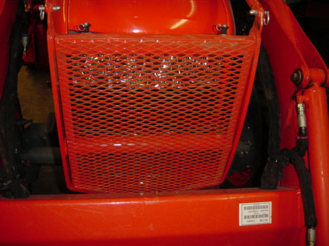

Who has this rig with the grill guard installed that could measure for me from the bottom of the square opening low down how far it is up to the bottom of the headlights.
Im customizing my grill guard with some perforated steel plate for add'l protection, and my tractor is 108 miles away.
I have the grill guard here, tractor is not.
   / CK25/30 Grill guard question #2
Top of the top tube to the start of the V is 17 1/2
11" center to center on the tubes 5 3/4 from the center of the bottom tube to the V. 16" wide and the tube is 1.690 in dia.
Here's a closeup pic of mine. I hope all this helps.
