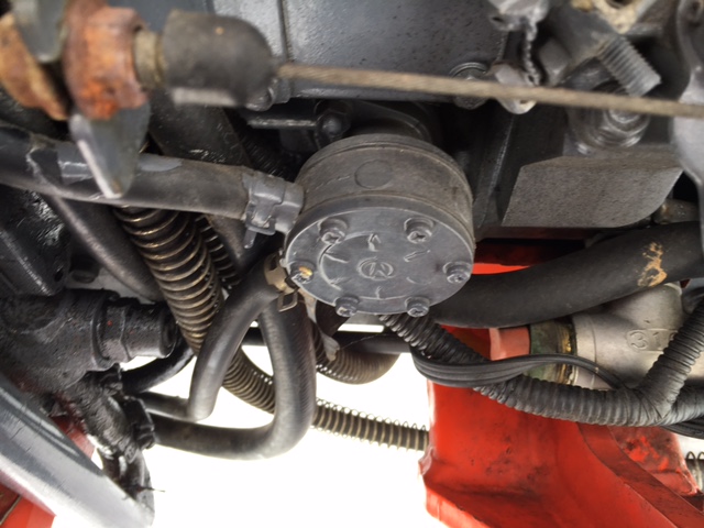

Yes, definitely a fuel problem. Yesterday I was putting a heat gun onto the fuel filter for 5 mins since the winter before I had ice there. No ice this winter since I've been treating my fuel generously. This morning, I did not put the heat gun on and the tractor lost power almost right away (after having idled warmup for 15mins at low rpm). I then put the heat gun on for 5 mins, and bingo, I get 20mins of use out of it. So I'm guessing the heat makes the diesel less viscous so it gets around any pebble :) that may have found it's way into the line. I'm guessing the obstruction is the fuel filter or downstream from it.
I'll redo all the lines up to and past the lift pump which I'm guessing is the thing in the attached pic.
Thanks for your help. If anyone knows of a post or guide on how to clear and reset the fuel system on such a tractor, I'd be much obliged.

DA: Yes, that is the lift pump. This is a simple diaphragm pump that supplies fuel to the injection pump at a couple PSI.
Your symptoms read more like ice in the filter. Have you tried changing (or even dumping out) the filter? It might be fuel jelling too but less likely. Did you buy that fuel after cold weather? Winter Diesel is formulated to be less vulnerable to jelling. The small amount of additive is probably not enough to prevent a whole tank of Diesel from jelling. But your temps aren't all that low so I think water in the fuel is more likely to be your problem. Remember that the fuel in the tank will be quite cold after standing all night.
Your owners' manual should show how to purge air from the system after replacing the fuel filter. Your's may be different but on my DK, it's best to pre-fill the new filter with fresh fuel and then turn the valve (on the filter housing) to purge and (after a few minutes) run the engine a brief time. Finally, turn the purge valve back to normal. The drawings in the manual are almost useless but it's a lot clearer looking at the actual filter housing. In the purge position, air and excess fuel goes back to the fuel tank as gravity and the lift pump fill the filter. Pre-filling the new filter makes this go much faster.
