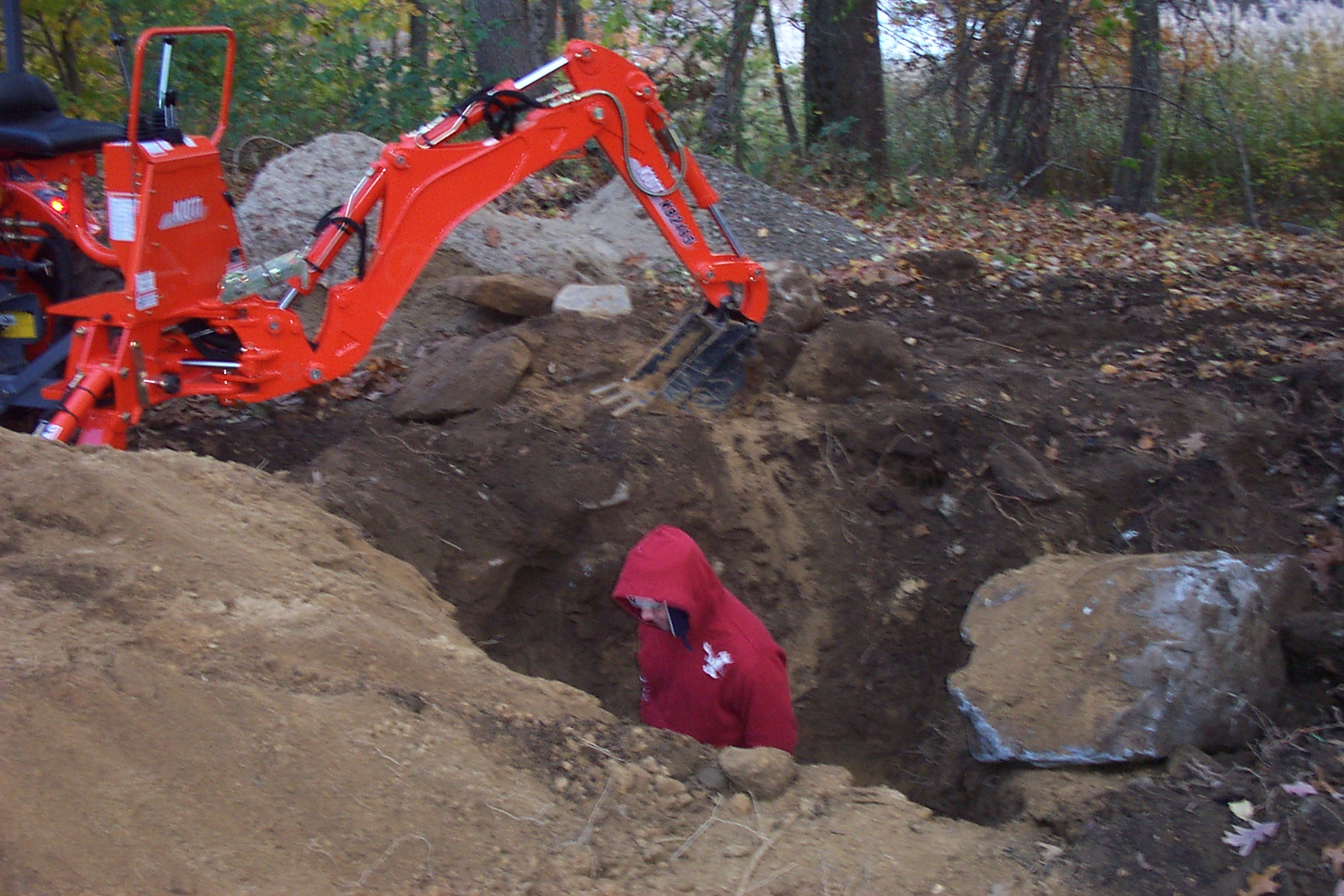

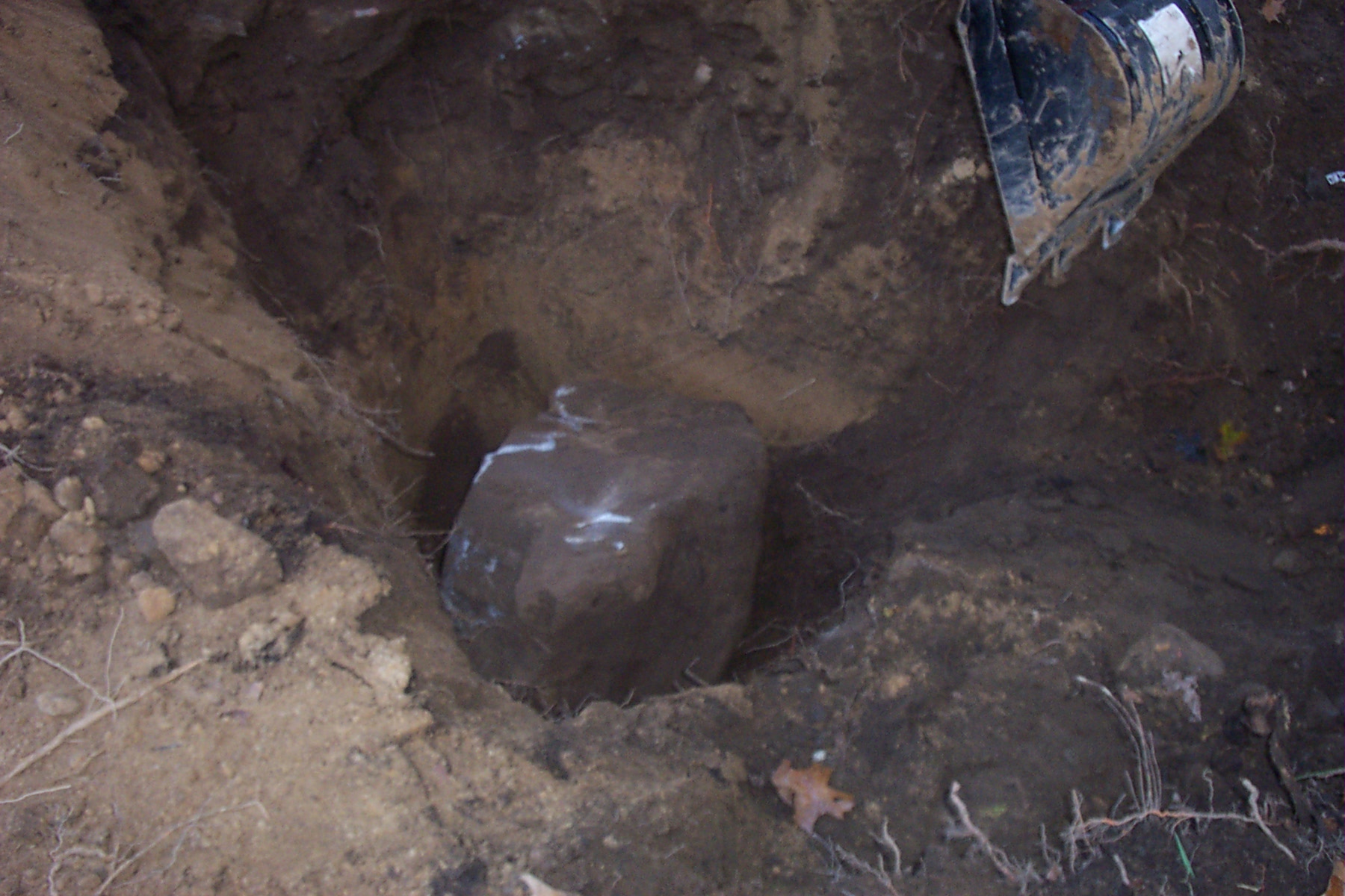

I believe that all that you have stated about the differences are correct. I bought the new ck20s this past fall, and am very happy and impressed, this is quite the machine. I see you say something about a strong backhoe, let me tell you when I pick up some of the rocks on our property I cant believe how easy it moves them. I think that the only two things that you did not say is that the new s has a horn, and the s has the curved boom backhoe which looks and operates great. I have not used one of the older ones but, I think they are about the same.

"natem": Impressive pictures they certainly helped convince me!!!
